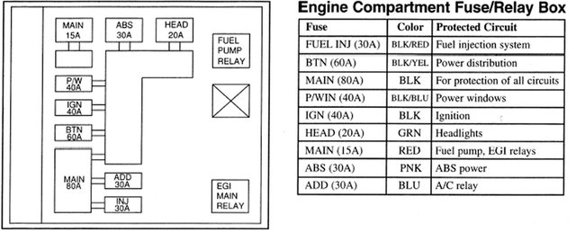

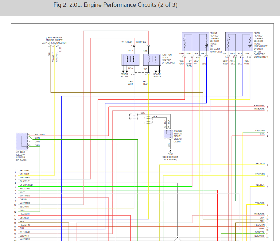

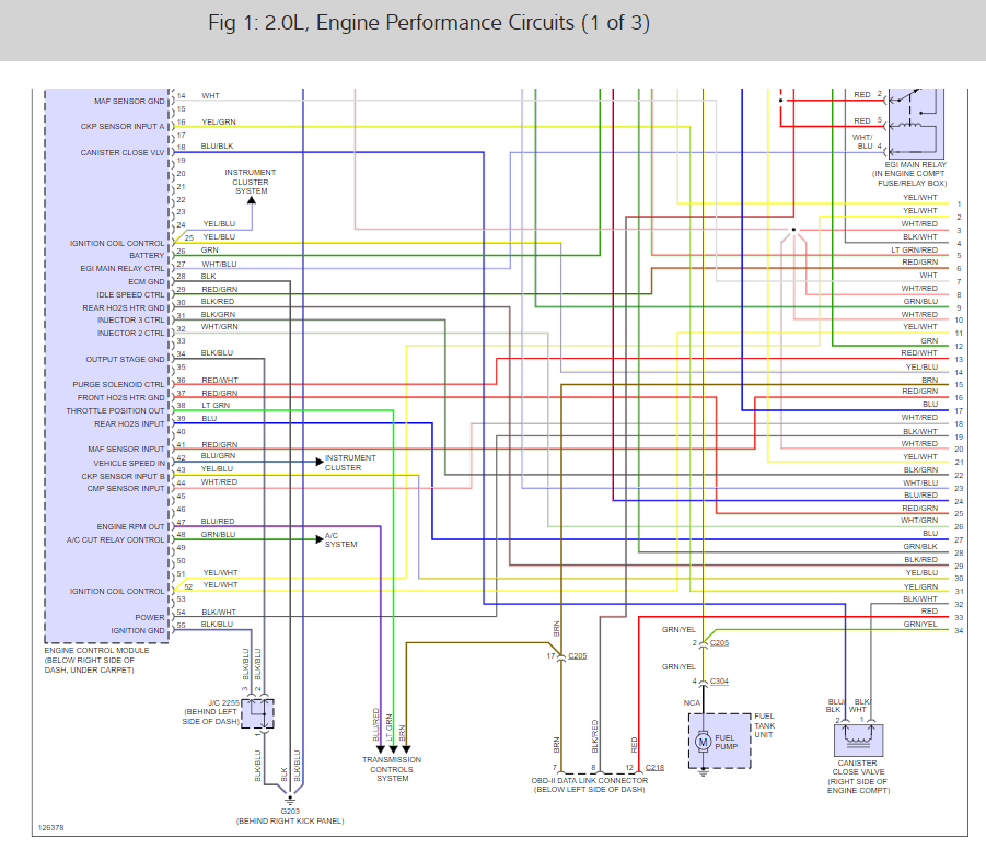

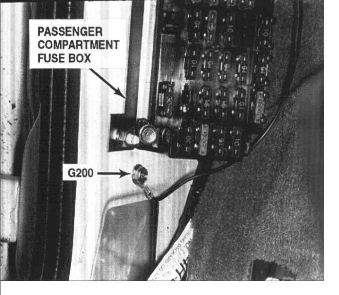

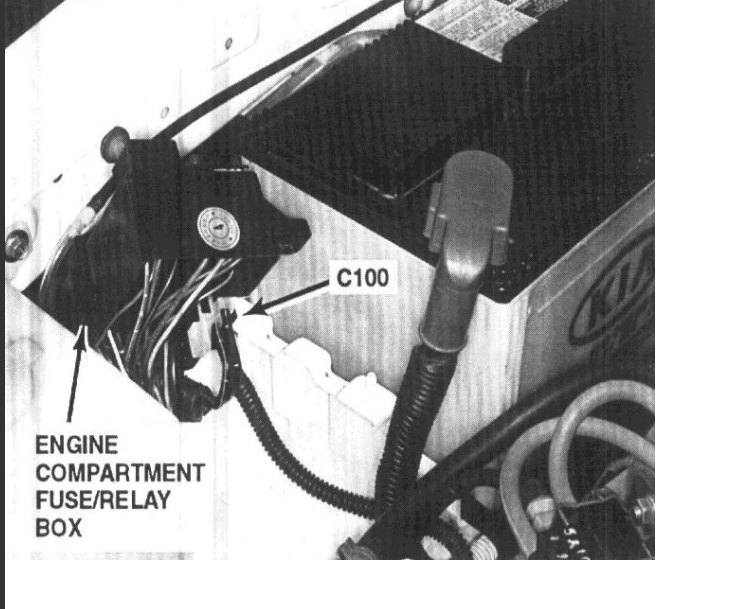

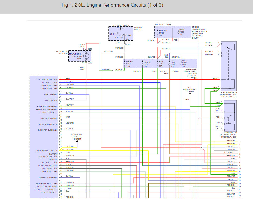

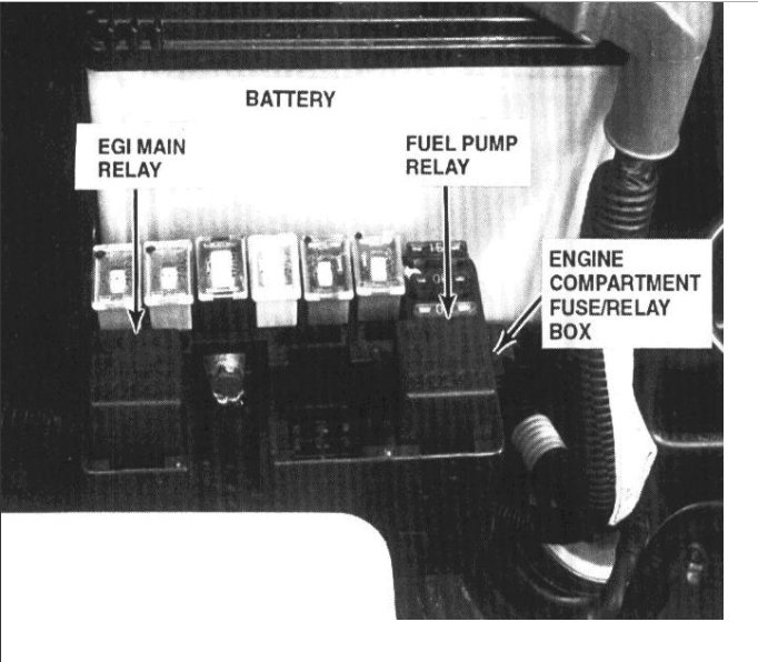

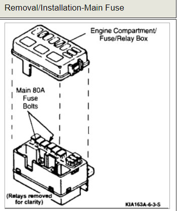

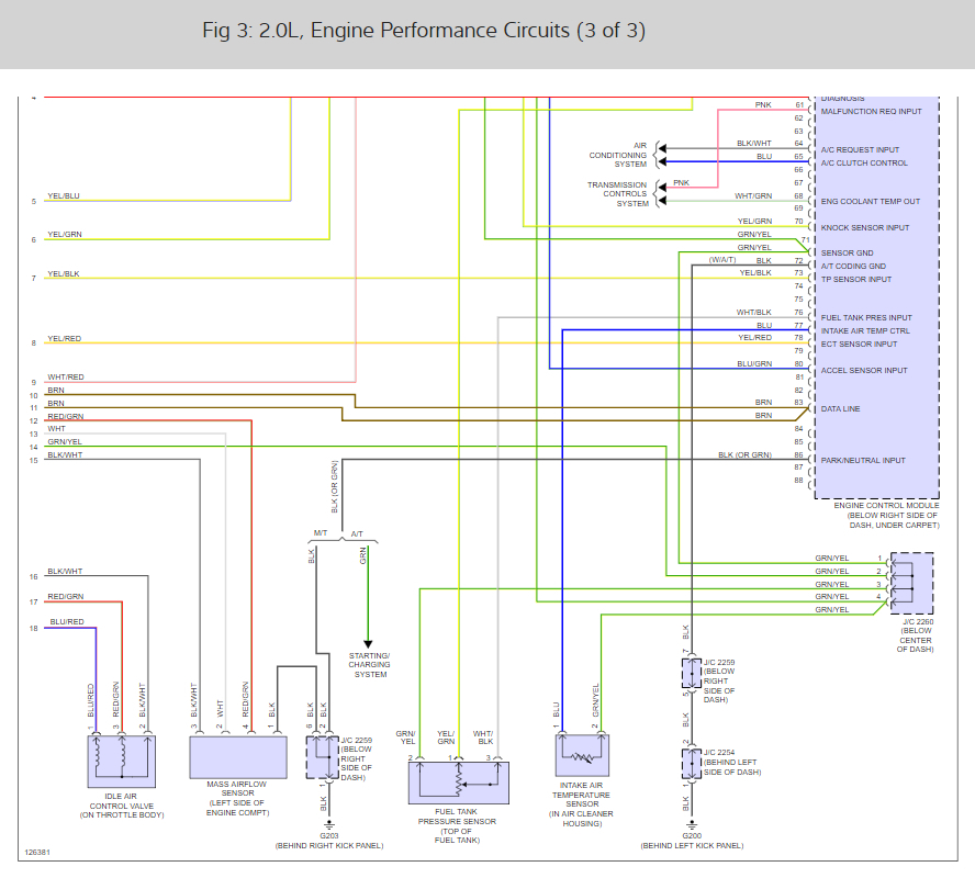

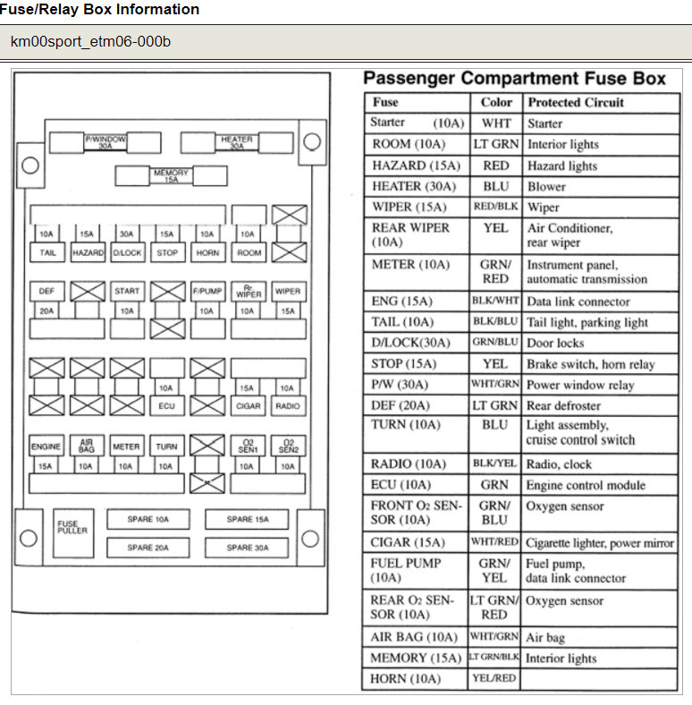

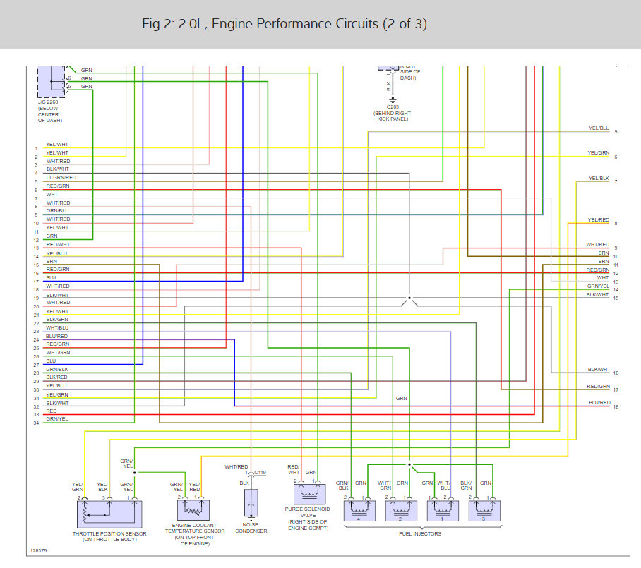

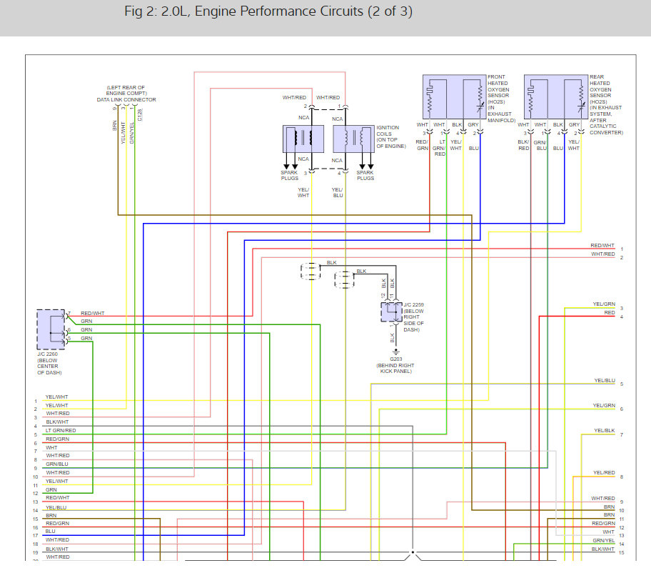

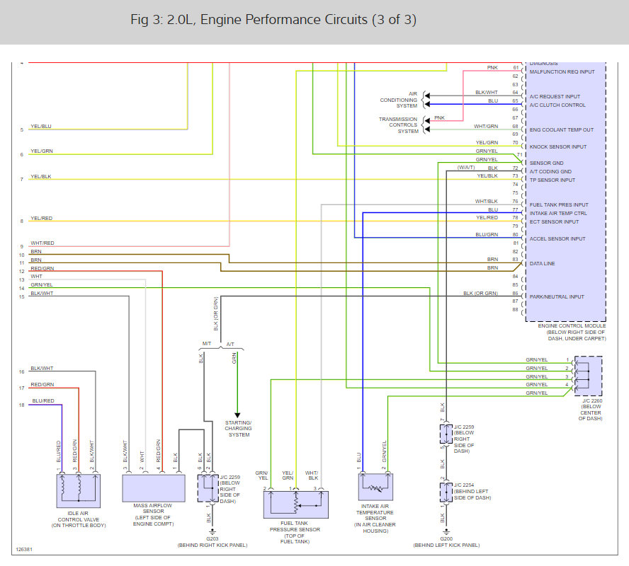

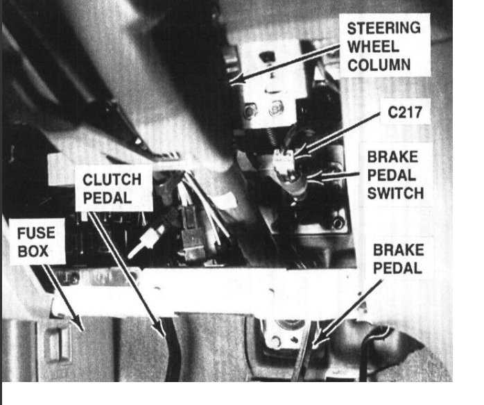

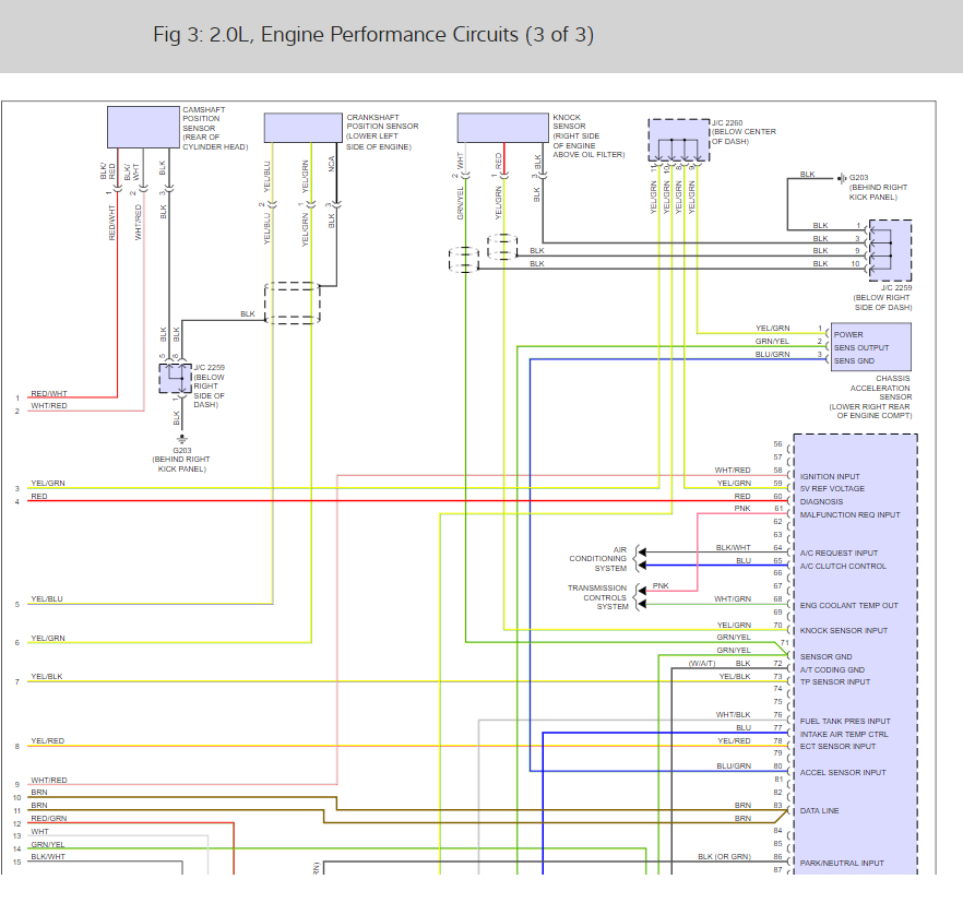

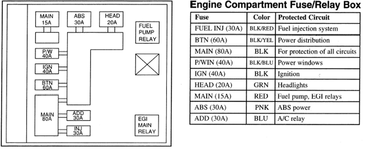

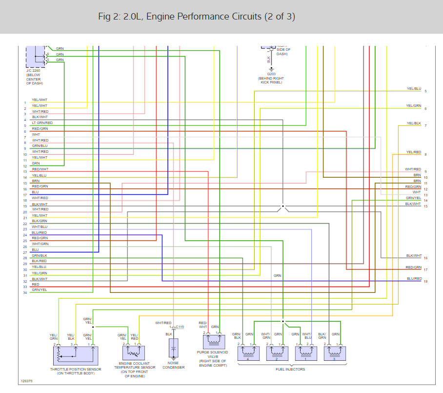

There is a main 15 amp fuse I would check first. Here is a guide to help you test the fuse and the engine and fuel pump wiring diagrams so you can see how the system works and the fuse location:
Check out the diagrams (below). Please let us know what you find.

Yep, the fuse was blown. I cannot believe I did not check that before. Thanks!
