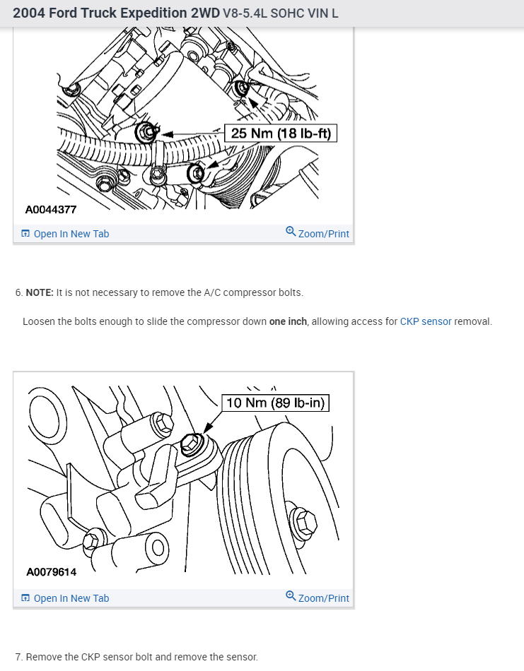

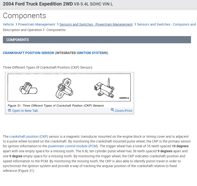

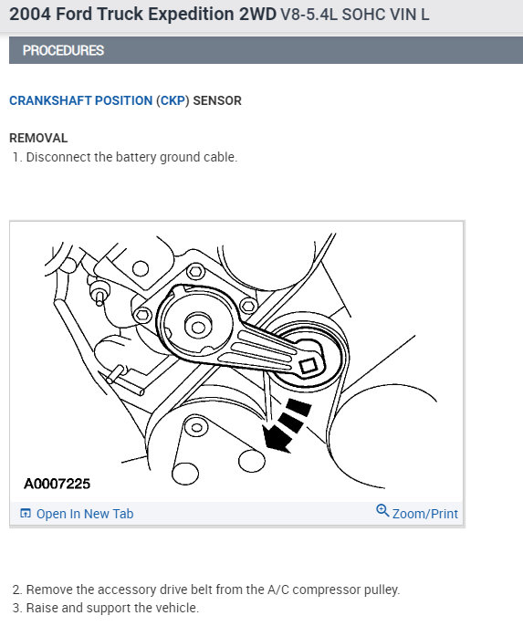

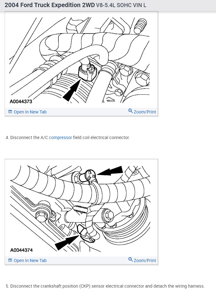

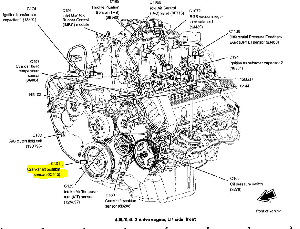

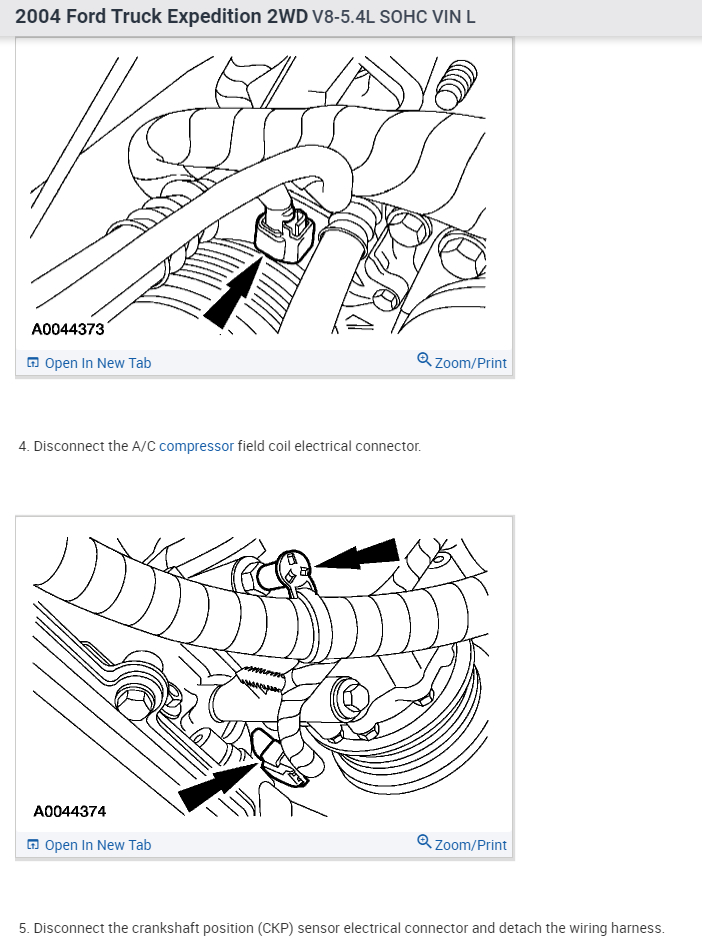

This could be due to a faulty crank position sensor.
Faulty crank sensor won't be able to send the proper signal to the ECM and that can trigger the engine shutdown. After the shut down the engine may or may not start back up.
Take a look at these helpful guides:
I have attached diagrams below for your reference.
