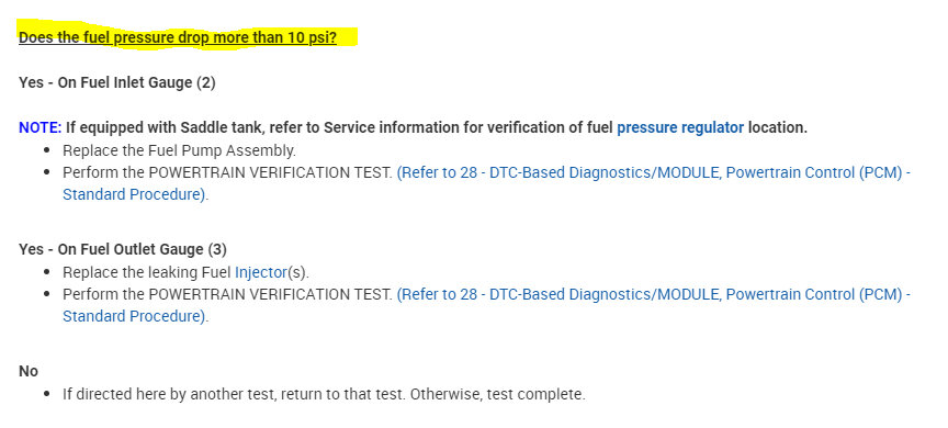

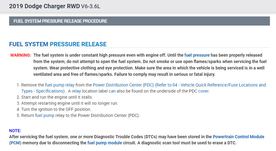

I'm not sure I understand exactly what you are looking for. If you are looking to release pressure, I attached the directions below. See pic 1. What is suggested is the removal of the fuel pump relay, starting the engine, and allowing the fuel pressure to be depleted.
If you need the Schrader valve location, either it will be on the fuel rail or it may require the removal of the supply hose at the rail, a T placed in it, and then the gauge mounts to the T.

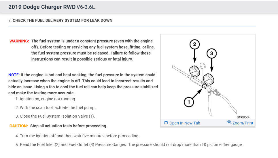

I'm not sure what you are referring to when you say cable. When you disconnect the supply hose, one side of the T will go to the supply hose, and the other side will likely need a rubber fuel line to bridge between the T and the fuel rail.

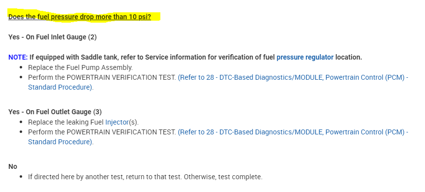

As far as the pressure is concerned, I don't suspect it is a problem. It is when the engine is turned off that I suspect pressure drops too fast. If you look at the pics below, you'll see that within five minutes, it shouldn't drop more than 10 PSI when the pump turns off.
See pics below.

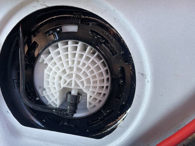

Hello, so I took a closer look, and it looks like it’s a slow steady leak coming from the O-ring area specifically where the serial numbers are on the ring, i recently filled up my gas tank so I’m thinking maybe that has something to do with it? Below I will provide a picture. I also noticed gas was leaking from directly under the car, would this be for the same reason?
Nov 11, 2023 at 2:11 PM
Was that o-ring that goes between the tank and module replaced or inspected for damage? As far as the fuel under the vehicle, yes, that certainly could be where it is coming from.

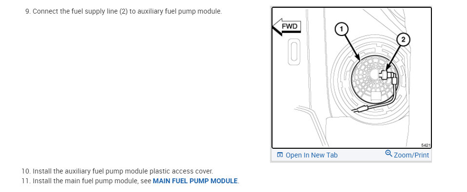

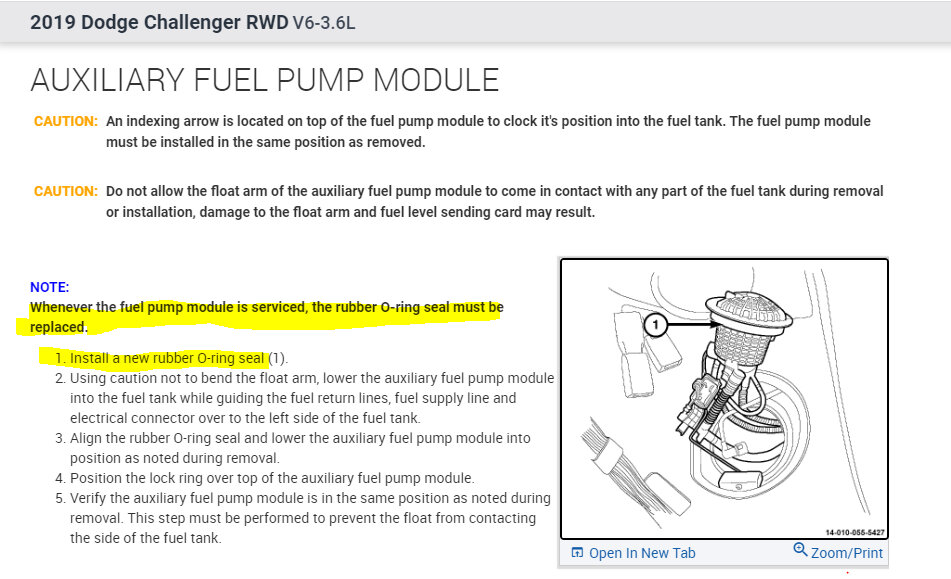

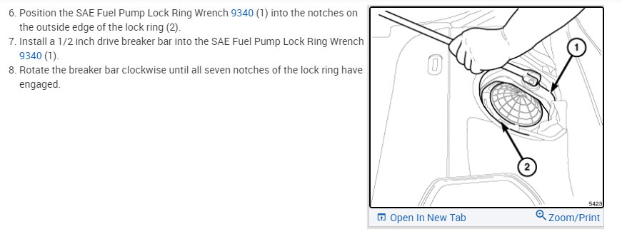

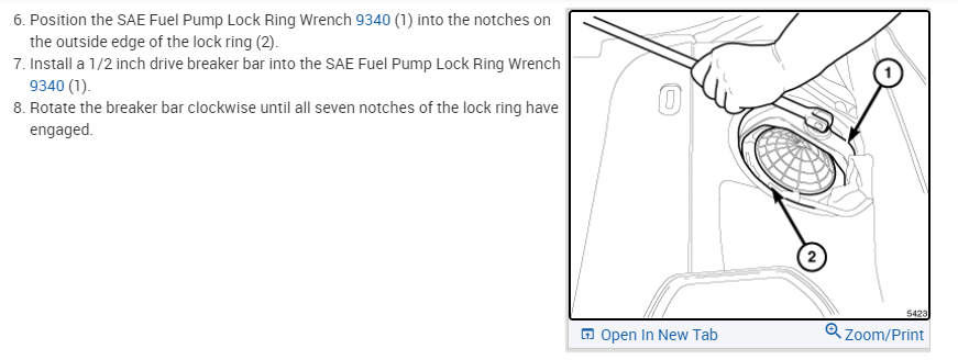

The fuel pump should have lifted first once you removed the retainer. Then the o-ring is between the pump and the tank. Is that how you have it installed or did you place the pump in the tank, the O-ring on top of the pump, and then the retainer? Also, there are notches on the lock ring. Make sure all seven notches of the lock ring have engaged.
Next, I attached the directions for the auxiliary fuel pump module installation. It indicated the o-ring must be replaced. I've never had a problem with one that was in good condition, but maybe that is the case with yours; it's damaged and not visible.
Take a look at the directions below. Make sure everything is clean and confirm the quick connector isn't the source of the leak.
Let me know what you find.
See pics below.
