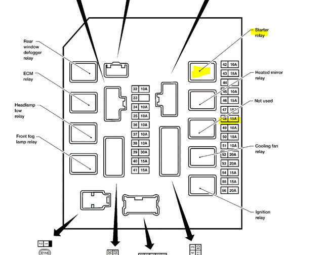

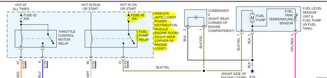

Trying to find the fuel pump relay and fuse location.
Jan 15, 2022 at 6:18 PM

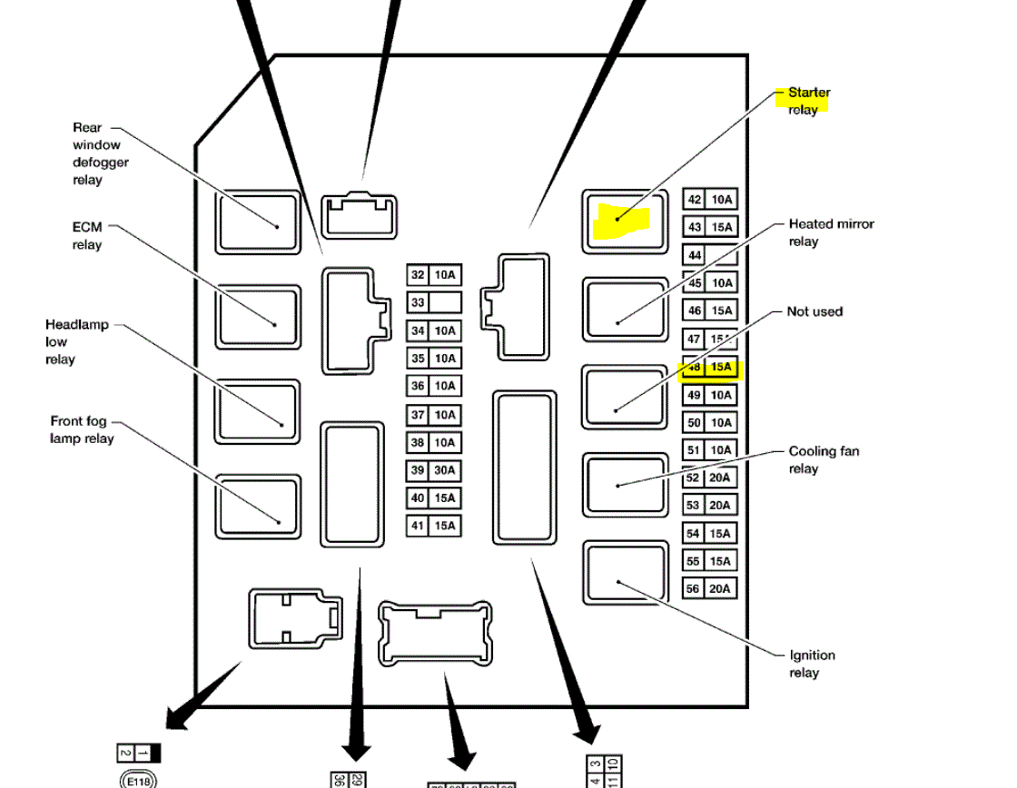

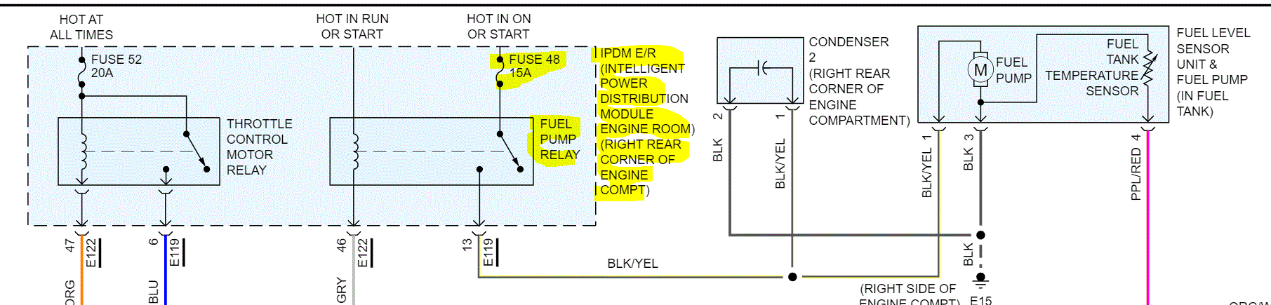

The relay and fuse are under the hood in the engine compartment. If you look at the pics I attached, it should help. Pic 1 is from the wiring schematic and in pic 2, I highlighted the fuse and relay locations.
Here are two links you may find helpful. Remember, when you check the fuse, also confirm it is getting power.
Let me know what I can do to help or if you have other questions.
See pics below.
