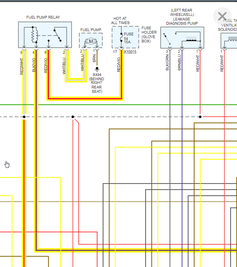

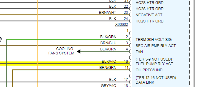

Let's do two things. First check for codes. If you have a code for something else that shares a power source that the fuel pump relay does then that will explain things a little more.
Next which wire have you checked for power at the relay? If you have it on the red/violet wire from the fuse then we have a relay issue. However, we need to test each of these wires while the key is on and see which has power and which does not.

Hello, thank you for the diagram! The problem was it was missing fuse #54 don’t know how but it wasn’t there put in fuse and car started right up.
