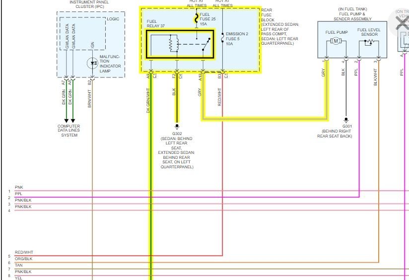

Fuel pump doesn't start up every time. Voltage at fuel pump relay on pin 85 is 12 sometimes and drops to 2 after 4 seconds. next time key is turned on voltage is moving between 2 and 4 volts. When that happens if I move shift lever from park to reverse or drive and back to park the voltage will jump up to 12 for 4 seconds and back down to about 2 volts. From what I read on YouTube I'm thinking I might have a bad PCM. Don't know how to test it. Will be waiting for your input. Thank you. John.

The fuel pump will only run for 2 seconds with the key turned to the on position. That is a primer time for the system. the dark green/white wire is what comes from the ECM.
The voltage should be constant while cranking as when the ECM sees a tach signal from the crank sensor, it will turn on the fuel pump.I attached a diagram for you to view of the relay controls.
What is the issue with the car?
