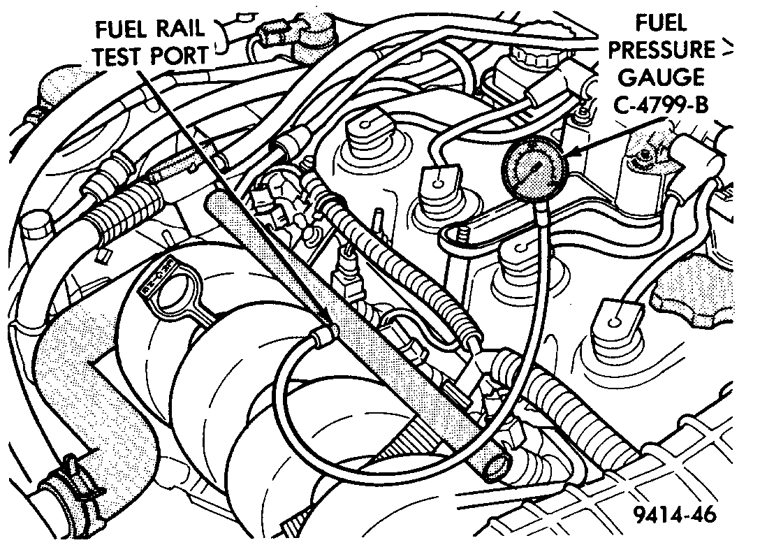

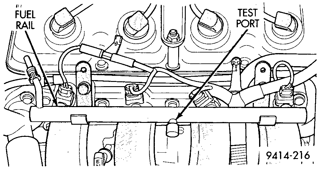

Fig. 18 Fuel Pressure Test Port
Pic 1
NOTE: The fuel system operates at approximately 331 kPa (48 psi). Check fuel system pressure at the test port on the fuel rail (Fig. 18).
1. Remove cap from fuel pressure test port on fuel rail.

2. Connect Fuel Pressure Gauge C-4799B to test port (Fig. 19).
CAUTION: When using the ASD Fuel System Test, the ASD relay and fuel pump relay remain energized for 7 minutes or until the test is stopped, or until the ignition switch is turned to the Off position.
3. Place the ignition key in the ON position. Using the DRB or equivalent scan tool, access ASD Fuel System Test. The ASD Fuel System Test will activate the fuel pump and pressurize the system.
- If the gauge reading equals 331 kPa (48 PSI) further testing is not required. If pressure is not correct, record the pressure.

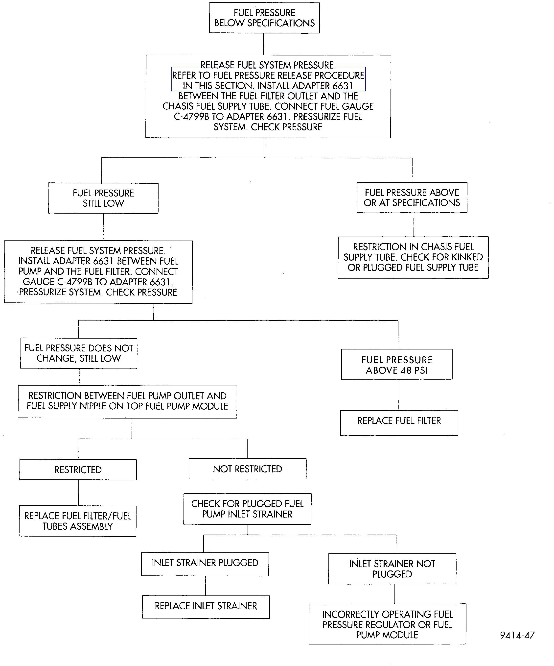

NOTE: If fuel pressure is below specifications, refer to the diagnosis chart below for Fuel Pressure Below Specifications.
Pic 3

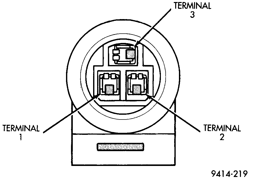

As far as the MAP, here are the directions. The attached pic correlates with the directions.

Fig. 30 MAP Sensor Connector
Pic 1
NOTE: Complete testing of this component and its circuit is done at the system level. See: A L L Diagnostic Trouble Codes ( DTC ) > Manufacturer Code Charts > DTC Test - CODE TO TC TEST CHART (Checking for Trouble Codes)
CAUTION: When testing the MAP sensor, be sure that the harness wires are not damaged by the test meter probes.
1. Test the MAP sensor output voltage at the MAP sensor connector between terminals 1 and 3 (Fig. 30).
- With the ignition switch ON and the engine not running, output voltage should be 4 to 5 volts.
- The voltage should drop to 1.5 to 2.1 volts with a hot, neutral idle speed condition.
- If OK, go to next step.
- If not OK, go to step 3.
2. Test PCM terminal 29 for the same voltage described in the previous step to verify wire harness condition.
