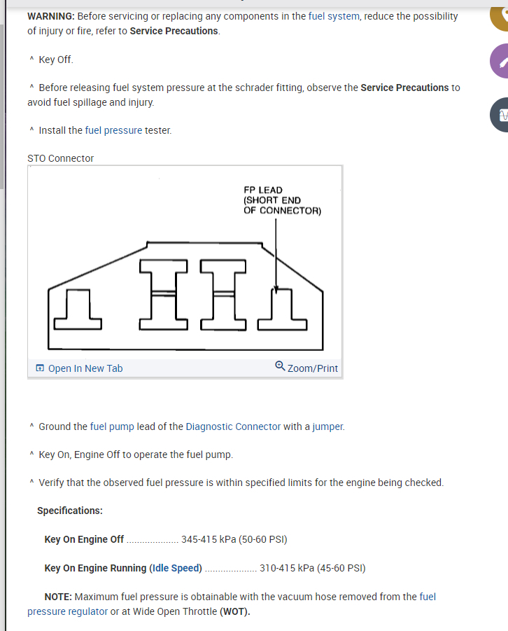

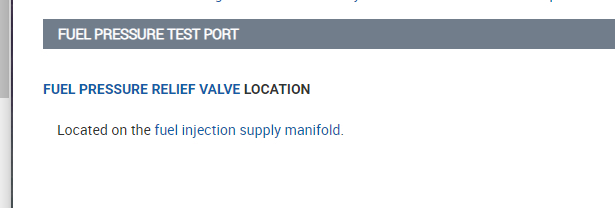

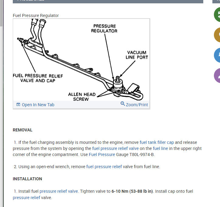

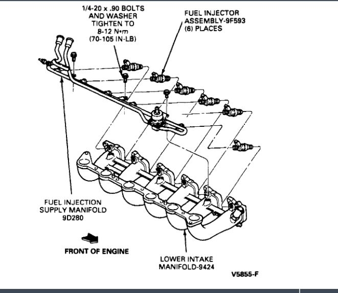

truck will stop at read lights and stop signs. after about thirty minutes it will start and run for about ten minutes and stop running again. i have no way to test the fuel pressure. the fuel rail does not have a test port. i fixed a broken wire under truck and i got the odometer started working.. i just don’t know we’re to start.
