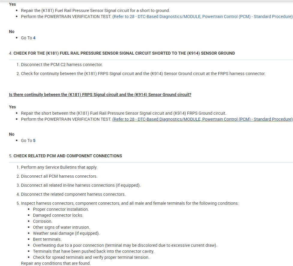

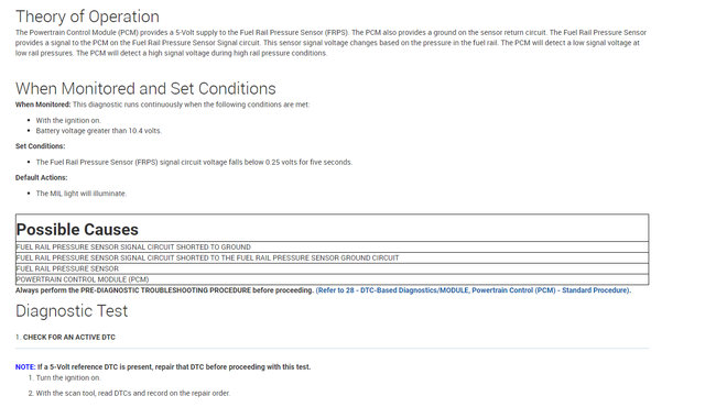

My vehicle (listed above) failed emissions and the resulting message was the "P018C CHRYSLER - Fuel Pressure Sensor 'B' Circuit Low".

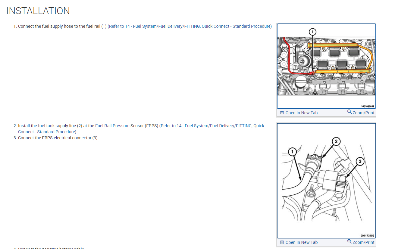

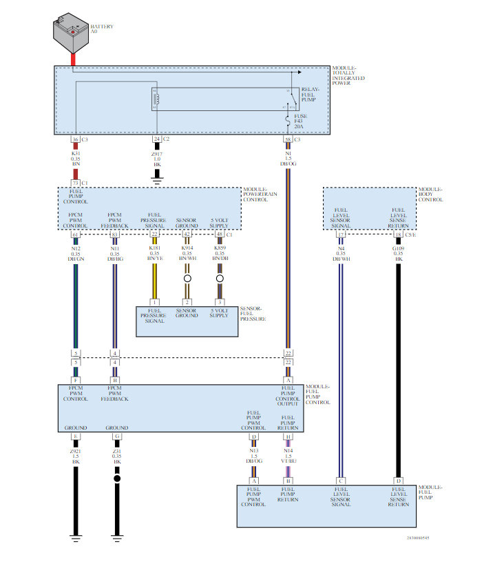

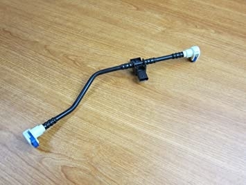

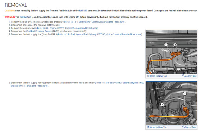

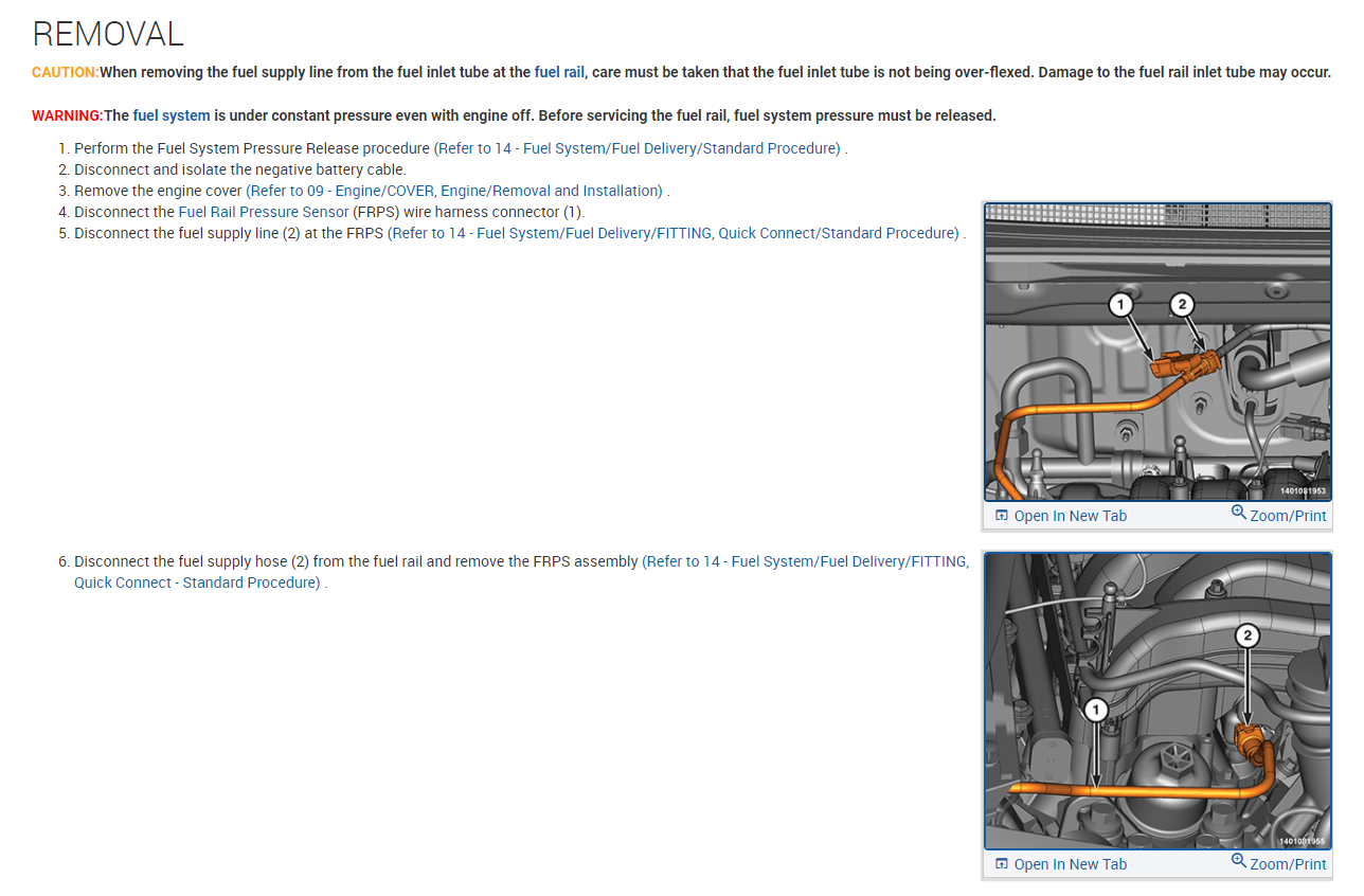

I should be able to replace this part myself, unless the mechanics here feel otherwise. I already have the part, but am having trouble locating the existing one.
Can someone either point me to a diagram or image showing this part in the engine bay or explain it to me? Thanks in advance.
