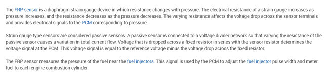

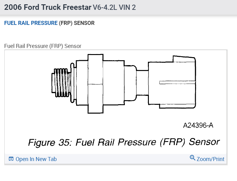

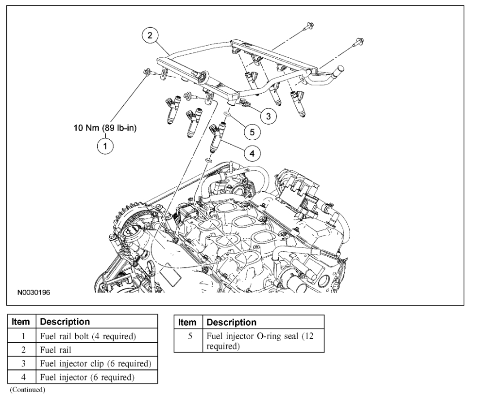

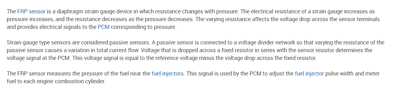

The fuel pressure sensor is on the fuel rail. Check out the images (below). Please let us know if you need anything else to get the problem fixed.
Jul 22, 2023 at 4:06 PM
There semes to be conflicting information on this car, it shows it has a fuel pressure sensor but the engine wiring diagrams do not show one. good luck! :/
