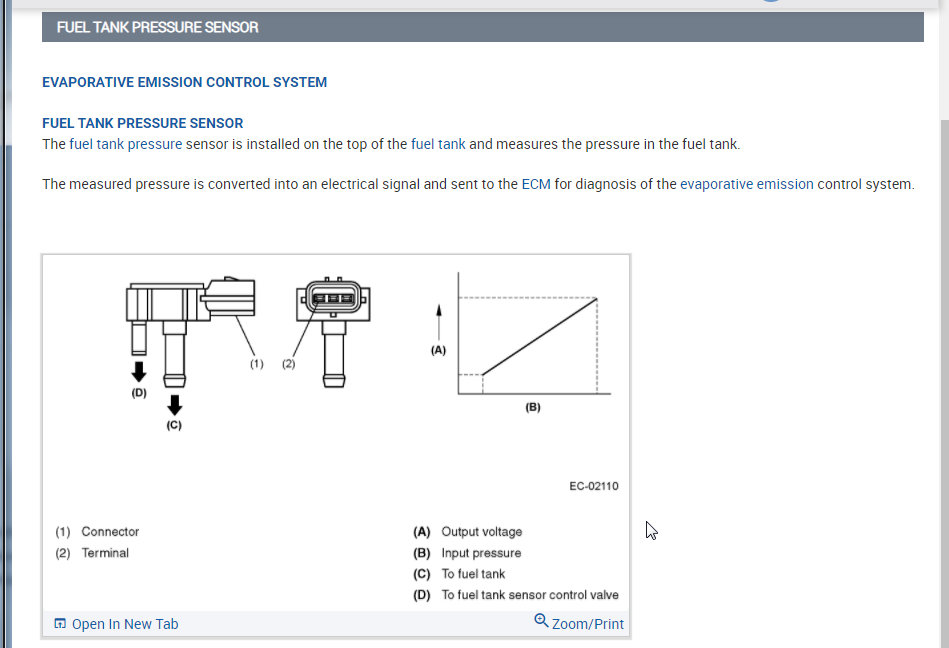

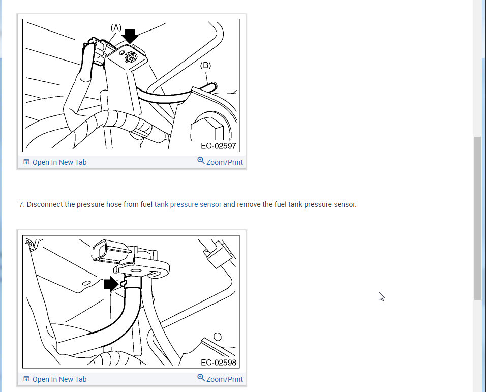

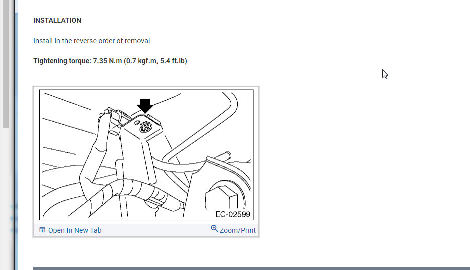

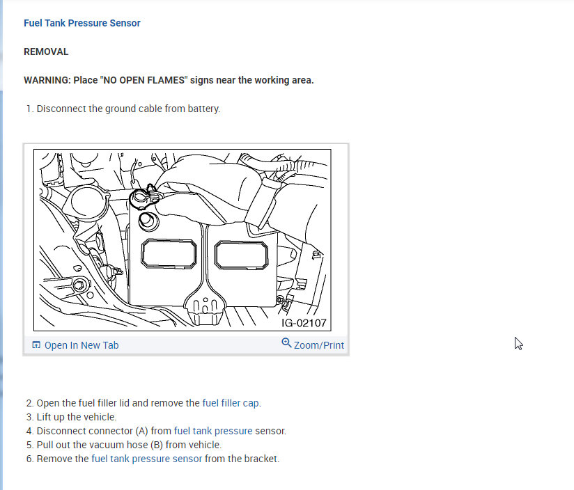

Is there a reason you are looking for this sensor? The reason I ask is you don't have a fuel pressure sensor but you do have a fuel tank pressure sensor.
It doesn't not monitor the fuel pressure but instead monitors the pressure in the tank and will vent the vapor through the emissions system if it gets too high.
I attached the info below on this sensor. Let us know what questions you have or if you have more info that would help with this. Thanks
