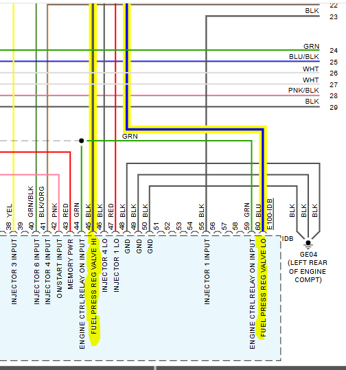

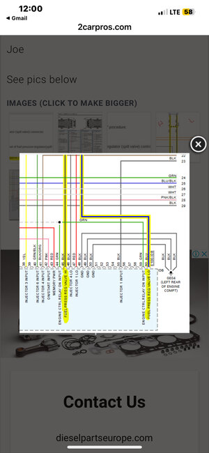

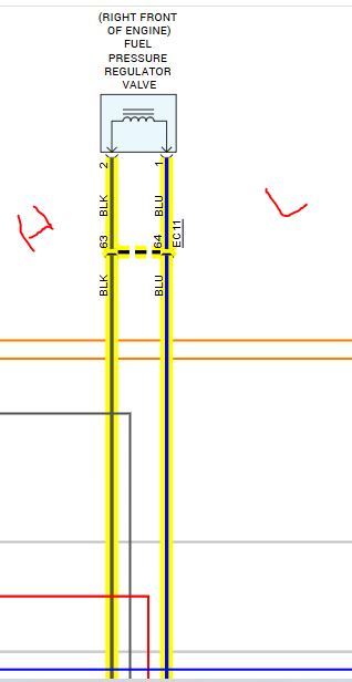

Hi, please can you provide me with the diagram for this high-pressure pump volt signals input and output, so I can compare if it’s within specification.
Fault code is P0090.

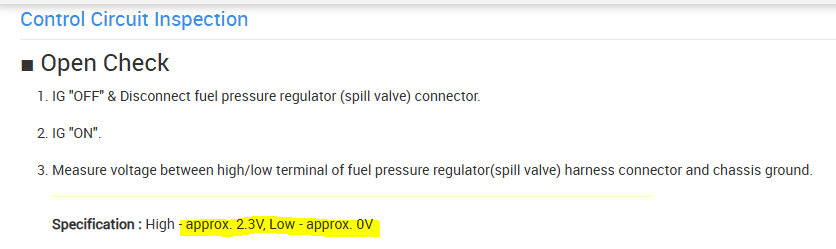

My current voltage reading is 1.44 on one cable with key on run position.
While the other cable I am getting a voltage of 1.49 with key on the run position. Please help me with the diagram and the signal outputs and inputs.
Sorry it’s All wheel drive.
