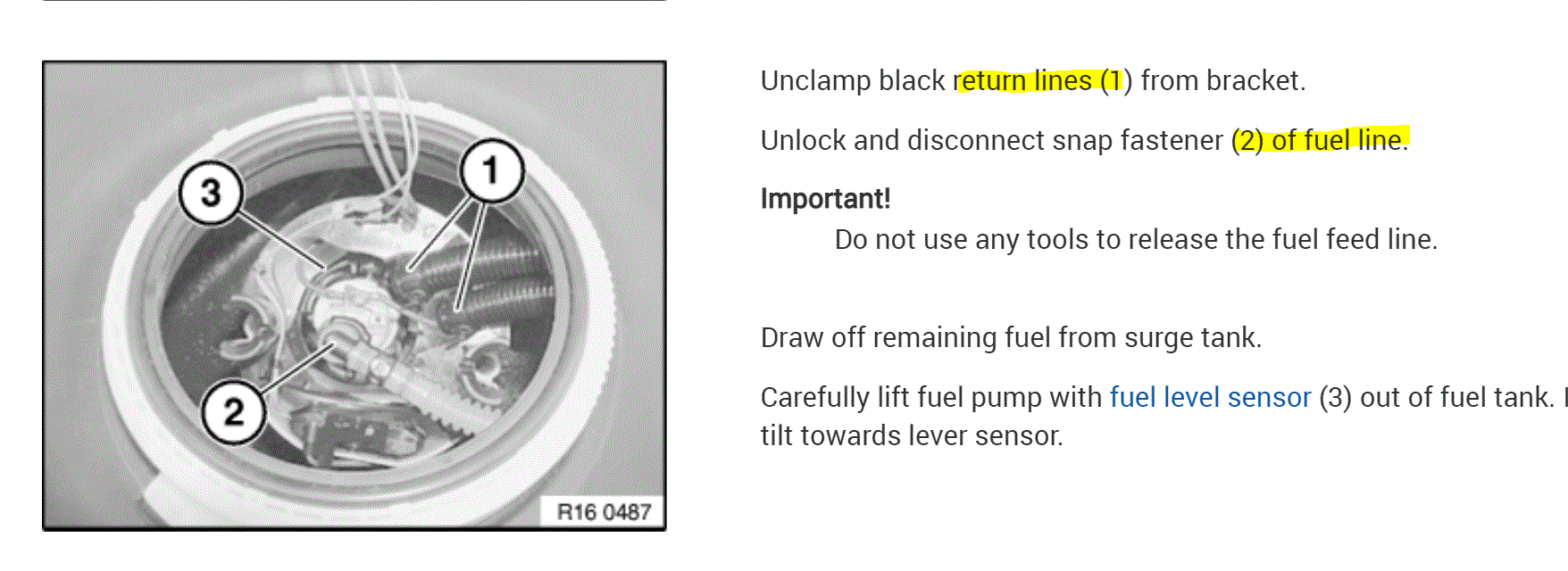

I attached a pic below of the fuel pump sending unit. It shows the return lines and the supply line. Which ones have fuel, and which don't? Also, let me know if that is what you are seeing. That is the US version. I just need to be sure we are on the same vehicle. LOL They change things based on destination.

Yes, there is no fuel on the side where the fuel pump sits, and there is lots of fuel on the side where the sending unit sits. When i put in some petrol it will start for a while and it will shut off, and when i open the tank i find all the fuel has been transferred to when the side where the sending unit sits. Yes, the picture you have shown is the right one, it is similar to the one I am talking about.
Form the little knowledge i have, i know the fuel pump pumps the fuel to the sending unit via fuel line (2) as you have shown and then to the injectors, but when it is supposed to return the excess fuel back to the other side it doesn’t do that, I don't know what causes that.

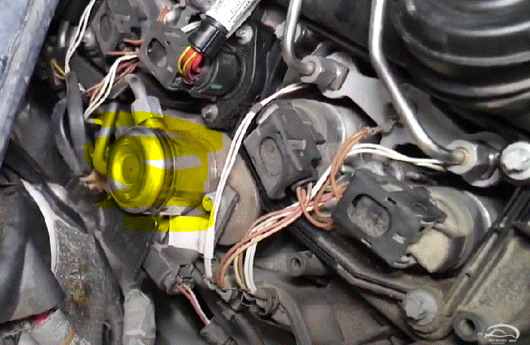

Okay, it sounds like an issue with the high-pressure fuel pump. If you remove the engine cover, locate the HPFP. See pic below. That is what you are looking for.
Is that where fuel makes it to and then stops?

That looks like a different engine than this one (e90 323), i can’t see where it’s located. i read someone say it’s under the manifold. But is it safe to drive it for a few kilometers to the garage with malfunctioning HPFP.

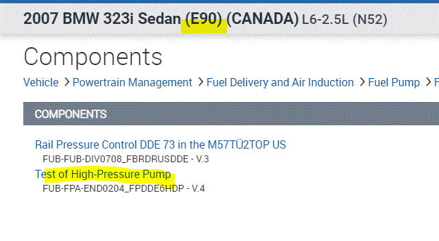

As far as I'm seeing, it should have a high-pressure fuel pump. By chance, are you located in Canada? I ask because the 323 isn't offered in the US, so I am much more familiar with the 335. If you look below, you'll see why I assumed it has one.
