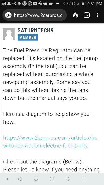

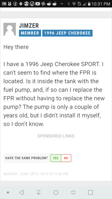

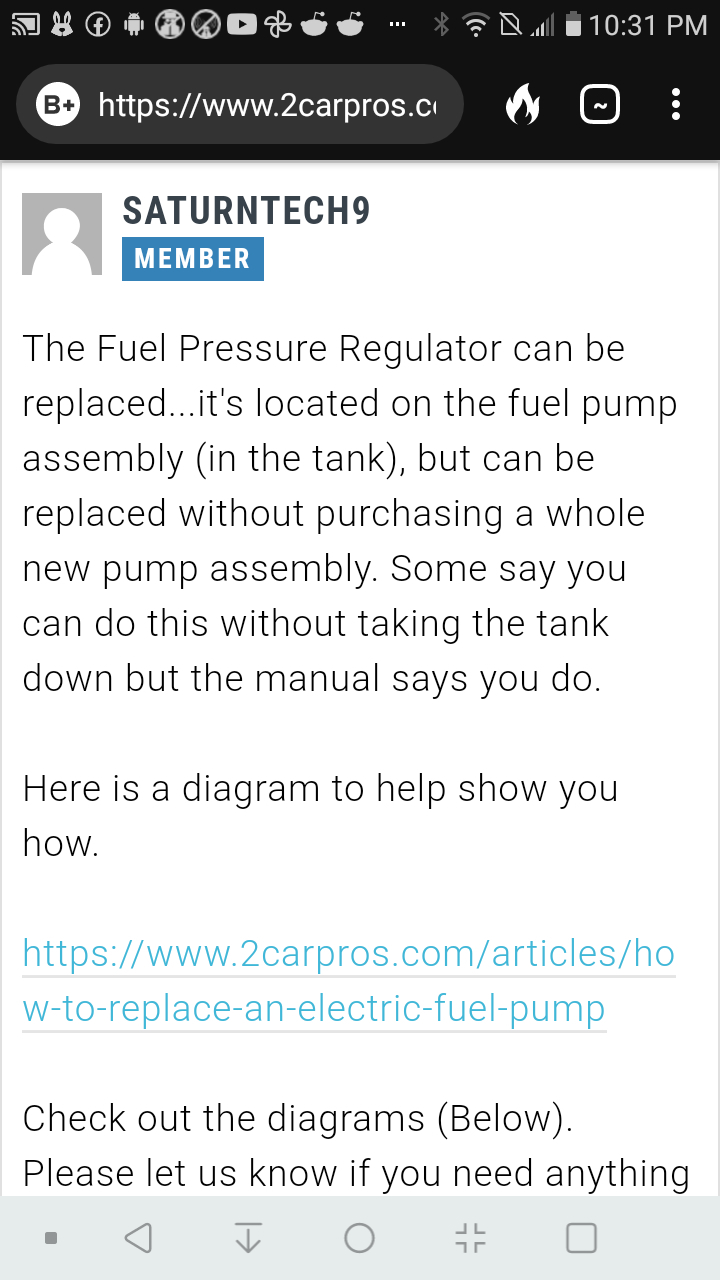

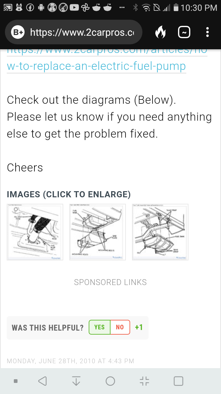

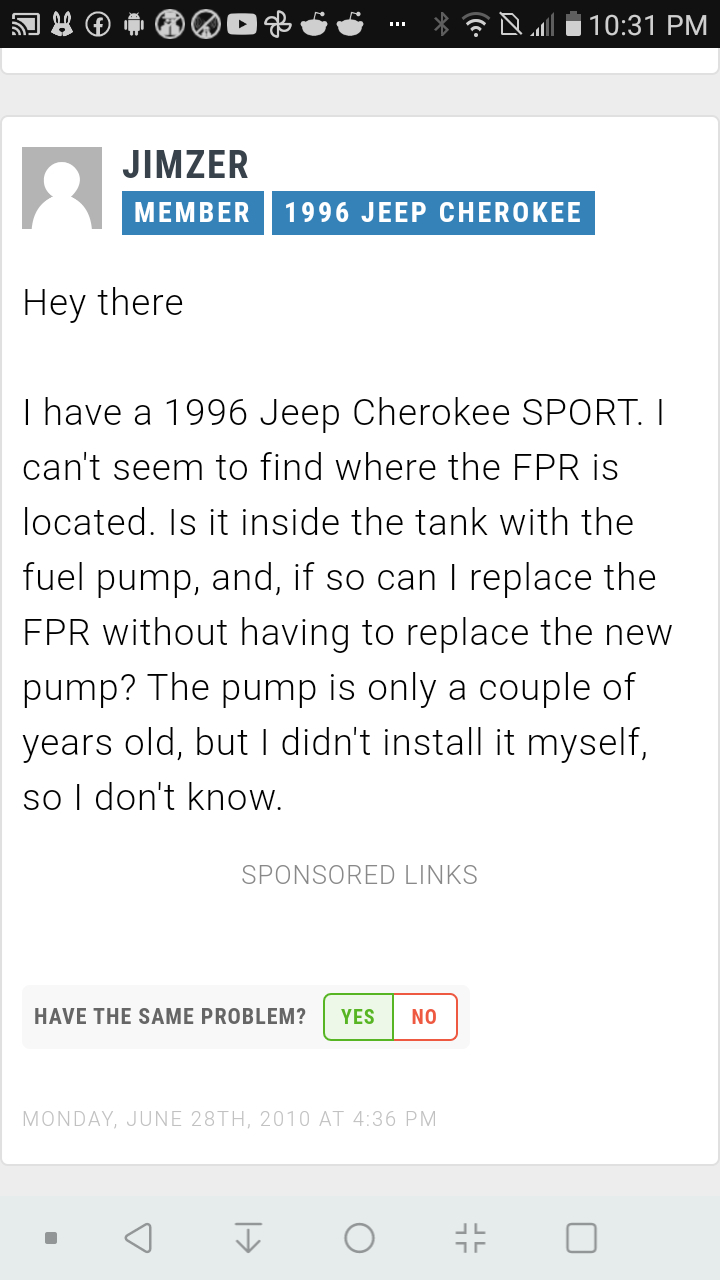

I read a post on your forum about someone who couldn't find their pressure regulator. It was from 10 years ago unfortunately but I was hoping maybe you could help out still?
They talked about how they couldn't find it on their fuel rail and asked if it was in the tank.
You responded telling them It was in fact in the tank and that it couldn't be replaced in its own and that they works have to replace the entire sending unit.

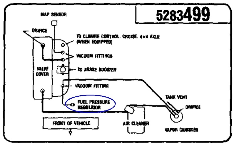

The fuel pressure regulator is indeed on the front of the fuel rail. The only drawing I can find is for the vacuum hoses, but it shows the location of the regulator.
What kind of problem are you trying to solve? I've never run into a defective fuel pressure regulator in over 30 years, except for a rash of failures on GM trucks. Those leaked fuel into the vacuum hose, but they still held normal pressure.

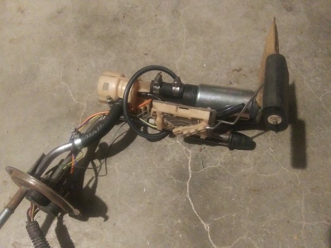

I don't believe it has failed yet. However, I recently replaced the fuel pump and when I did, I discovered a substantial amount of white residue covering all the components of the fuel module/sending unit along with rust.
In fact I had to replace the fuel tank itself because I developed a leak, multiple leaks actually directly underneath the tray that sits inside the fuel tank. The rust had eaten a hole through the tray and ultimately the tank.
I assumed the white residue was calcium/lime scale buildup. That buildup covered the entire regulator and since the pump failed immediately after I replaced the tank I naturally assumed the regulator couldn't be in that great of shape. Looking at the outside of it and the buildup on it made me think the inside of the regulator probably looked the same so I wanted to replace it before the vehicle stranded me again. Chrysler sells the module as a single component which includes the sending unit framing itself, pump, fuel strainer and regulator all in one but I couldn't afford the whole thing so I just bought a new pump and fuel filter at the time. Now I have the money so I purchased a new fuel strainer and regulator, minus the sending unit (framing)} to essentially complete the replacement of all the modules components.
There is one issue but I'm not sure it's even related, right after I start the vehicle and put it in drive, I'll press the gas and it will hesitate and momentarily lose power but then it almost immediately corrects itself every time and the issue stops for the rest of time while driving. Other than that it works just fine.
I never had any problems with it until the vehicle had been parked for nearly seven years outside unprotected from the elements. I'm not sure what caused it to allow water in to the tank exactly but it must have been pretty bad because I counted 30 pinholes on the tank.
Sorry for the winded response, I'm just trying to cover all the bases.

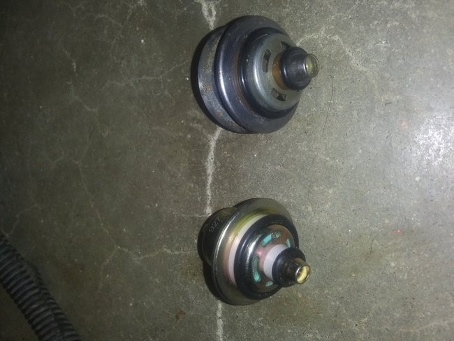

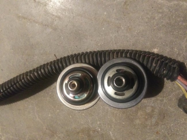

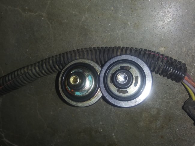

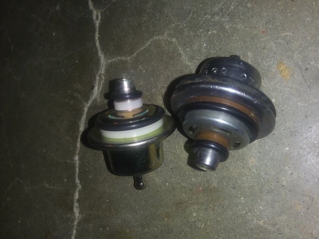

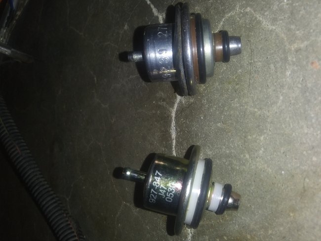

I pulled it all apart again so here are a couple pics of the new and old regulator. I'm not sure I have the right regulator as you'll see the subtle differences. They essentially look the same but the nipple is longer on the new one and the body itself is a little smaller than the old one. (O-ring on bottom) Also the inlet outlet holes are a different diameter. I just don't want to put it all back together if I have the wrong one. Advance auto has a regulator for $90.00 and Chrysler's version is about the same cost. I am poor so I bought a PR210 from eBay which by the number that would be a Standard Motor Products item but even theirs is $50.00 to $60.00 so I probably have a imitation. I paid $10.00 for this one, lol. New one is on the left (brass colored) old Chrysler one of the right (silver colored).

Dandy photos. If you were to cut a regulator open, you'd be amazed at how little is inside it. There's basically a round disc that's held closed with a spring. Pressurized fuel pushes that disc off its seat, then rushes past it and back into the tank. No powder or any other kind of debris is going to get stuck in there. Anything large enough to be caught under that disc can't make it through the screen on the fuel pick-up tube, and if that screen was cut or removed, the debris would lock up the fuel pump. It also wouldn't make it through the filter.
As for the powder you found, I suspect that is an additive in the gas that is normally dissolved and held in suspension. If that powder could make it as far as the regulator, it also made it to the injectors. Those have extremely fine-mesh screens to trap even the tiniest debris. A powder that doesn't dissolve would plug those screens in short order.
Chrysler is well-known for buying parts from multiple suppliers. This used to make replacing just one part of a half shaft somewhat confusing because at least four manufacturers supplied them, and all used different parts even though the shafts as an assembly easily interchanged. Chrysler did that because some suppliers couldn't keep up with production needs, and they weren't held hostage if the people at one plant went on strike. The same can be true of fuel pressure regulators. The only size that is important is the outer diameter of the two o-rings. You could have an old and a new regulator made by different manufacturers, or at different times after one made a design change. The hole in the middle of the smaller o-ring has no bearing on the calibration or pressure. It has to be large enough to pass 99 percent of the gas the pump is moving. That can easily be well over 50 gallons per hour. Only a little is tapped off to go through the injectors and into the engine. The rest goes back to the tank through the return line where it flows up a ramp around the outside of a bowl the fuel pick-up and screen sits in. That flow creates a venturi action that draws more fuel with it to keep that bowl full. Planting the pick-up in that bowl prevent the gas from running away from the pick-up when fuel level is low and you're going around a corner or up or down a hill. It's also how they keep a four-inch-tall bowl full when there's less than an inch of gas left in the rest of the tank.
