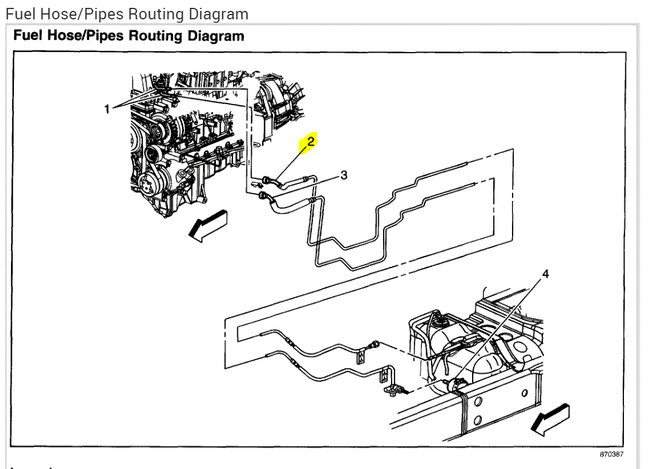

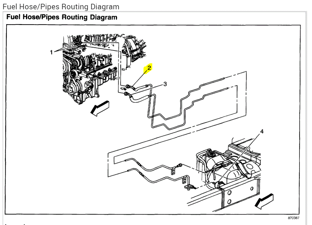

Next, the fuel system has a return line to the fuel tank. If the problem continues, I'm questioning if something has plugged the return. However, since it ran well for a few trips, I'm even questioning that. If you look at pic 1, it shows the fuel lines. The highlighted one is the return.

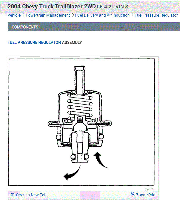

As far as the regulator is concerned, it's a very simple design. The fuel pressure regulator is a diaphragm relief valve. The diaphragm has fuel pressure on one side and regulator spring pressure on the other side. The fuel pressure regulator maintains a constant pressure across the fuel injectors under all operating conditions. If it keeps failing, either we have poorly made regulators (which may be the case), or there is extreme pressure being built that it can't handle. That doesn't make sense to me yet, but anything is possible.

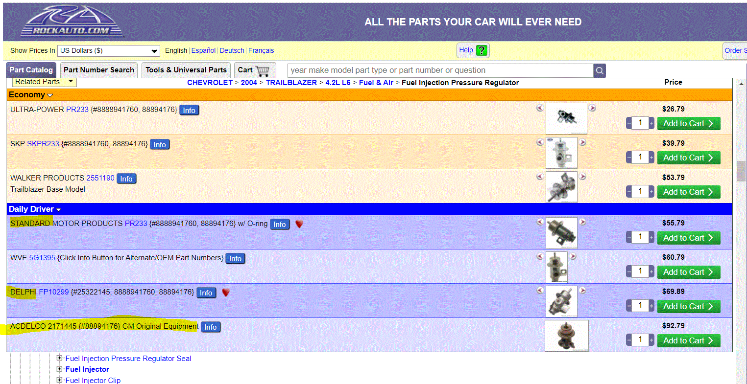

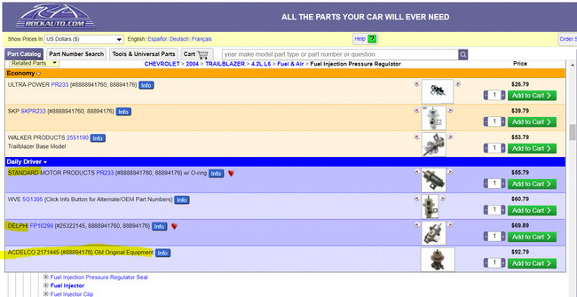

Let me know if the new one takes care of the issue. If it doesn't, return it and get your money back. Get one at a parts store manufactured by a well-known company. For example, Delco, Standard, and there are many others are well known for what they do. Often times when you get parts from online, it's difficult to tell where they came from.
Keep in mind, this is a theory at this point.
You know, I didn't realize how expensive they are for this vehicle. I did a little research for you and found a few on rockauto.com that I recognize. I attached it in pic 3.
