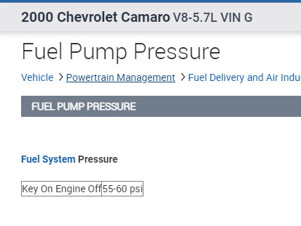

That would be my first thought, the regulator. Before you jump into the regulator, please know that it requires the removal of the fuel tank to access. So, we need to check the fuel pressure to make sure it is within the manufacturer's specifications.
Here is a link that explains how to check fuel pressure:

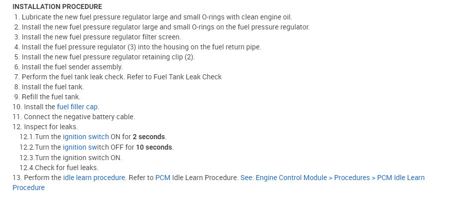

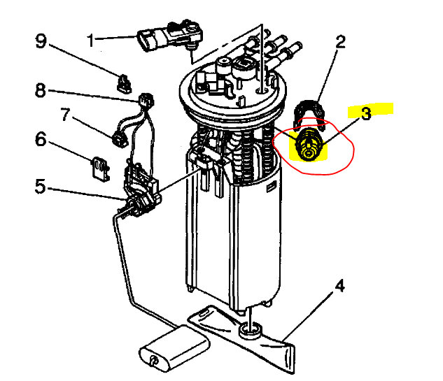

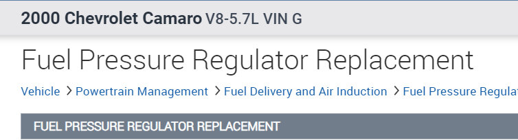

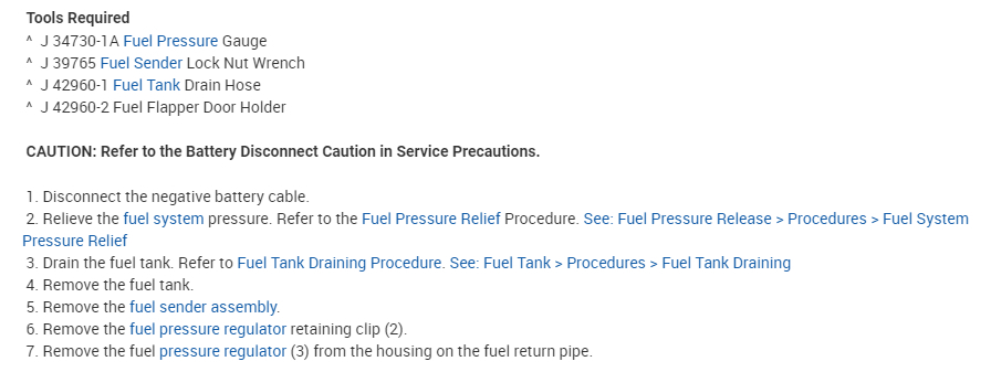

Pic 1 below provides the manufacturer's fuel pressure specifications. Additionally, the remaining pics are the directions for replacing the regulator.
See pics below.
