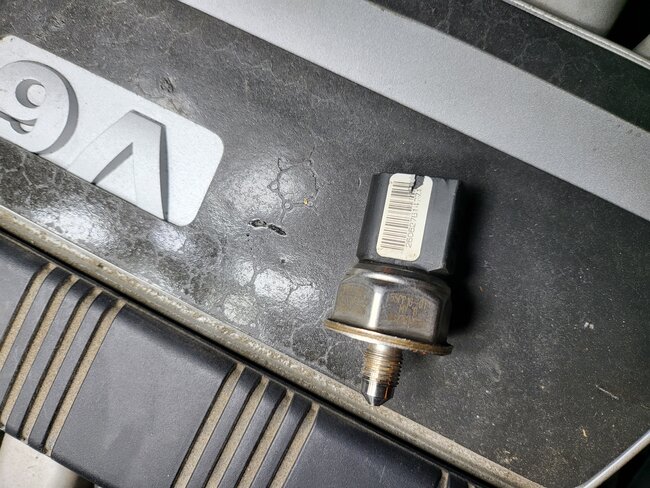

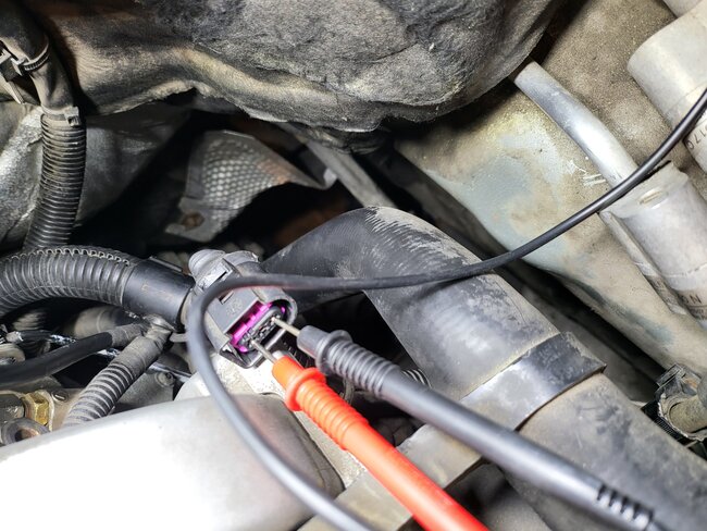

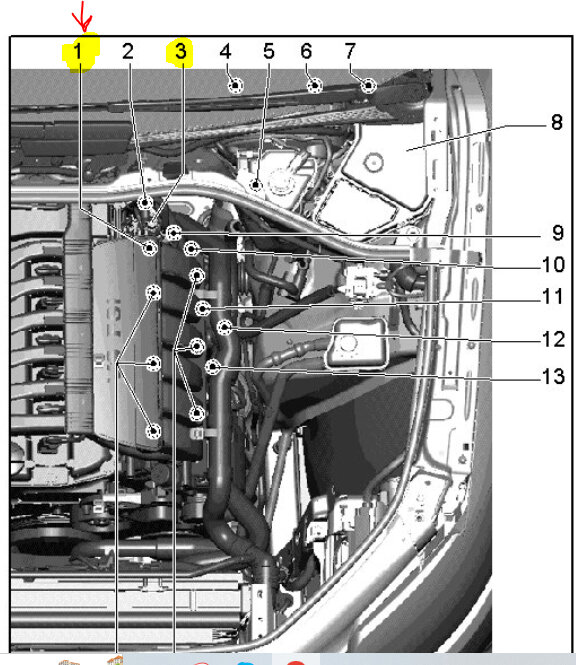

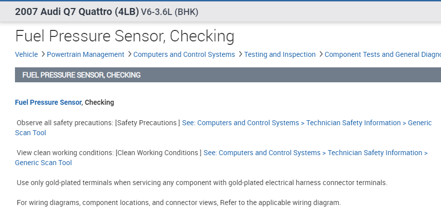

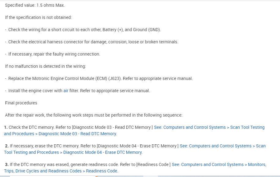

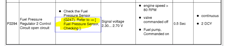

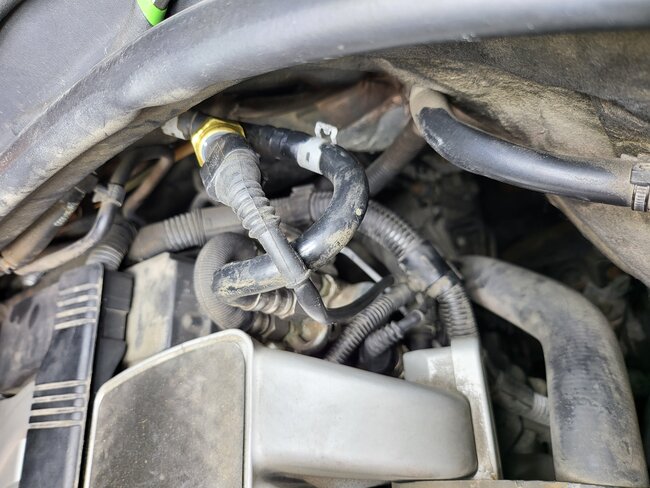

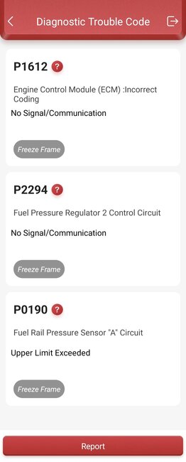

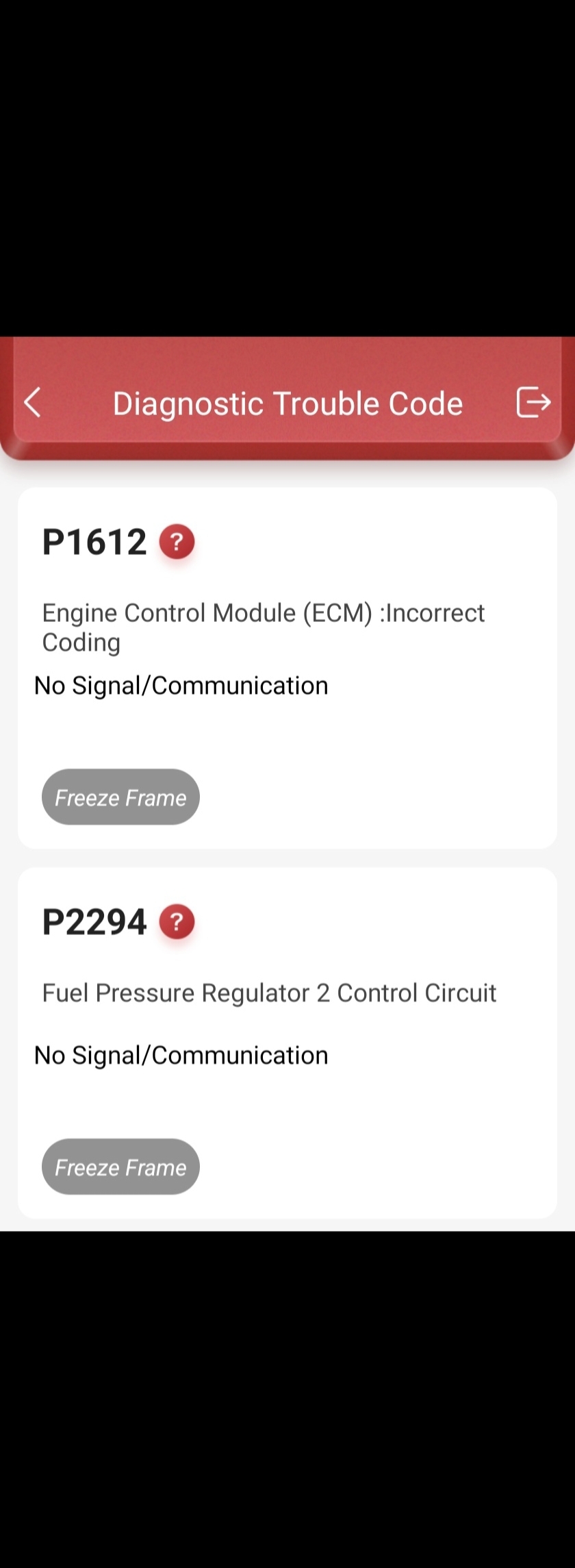

My OBD Show there are P2294 code in my car.
Which is the fuel pressure regulator 2.
I changed the one under the back seat. And i still have same code and same issue.
So, i don't know where is the fuel pressure regulator 2 located in this car.
