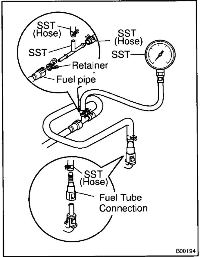

That car doesn't have one, instead you need an adapter that connects inline to the fuel line connection on the fuel rail. It should be from 44-50 PSI. key on engine off.
