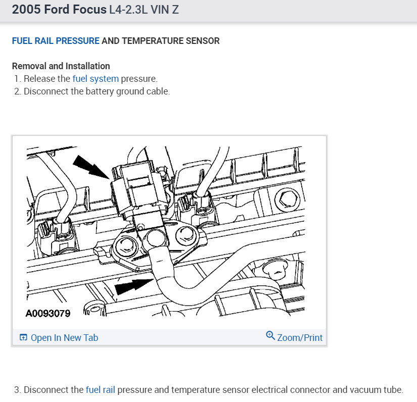

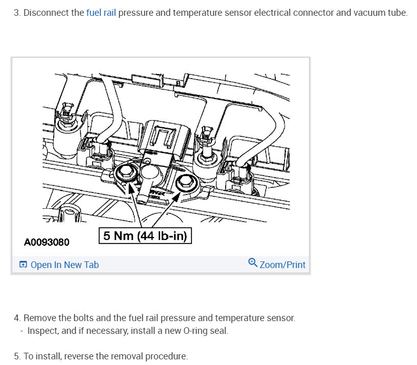

OBDII codes P0190 and P0191. Scanner shows 10 lbs of fuel pressure. Changed FRP sensor and fuel filter. Here's the weird thing: starts fine with 40-45 lbs of pressure according to the scanner. Warms up fine. After five to ten minutes of driving fuel pressure drops to 8-10 pounds (with accompanying engine stutter or shut down). If you turn off the engine and immediately re-start it the pressure reads 40-45 lbs again. After five to ten minutes of driving does it again. Cleaned FPDM contacts - no change. Maybe they sold me a bad FRP sensor? Additional Information: I hear the fuel pump energize when the key is turned on. Fuel pressure reads one pound with key on engine off. It jumps up quickly after starting.
