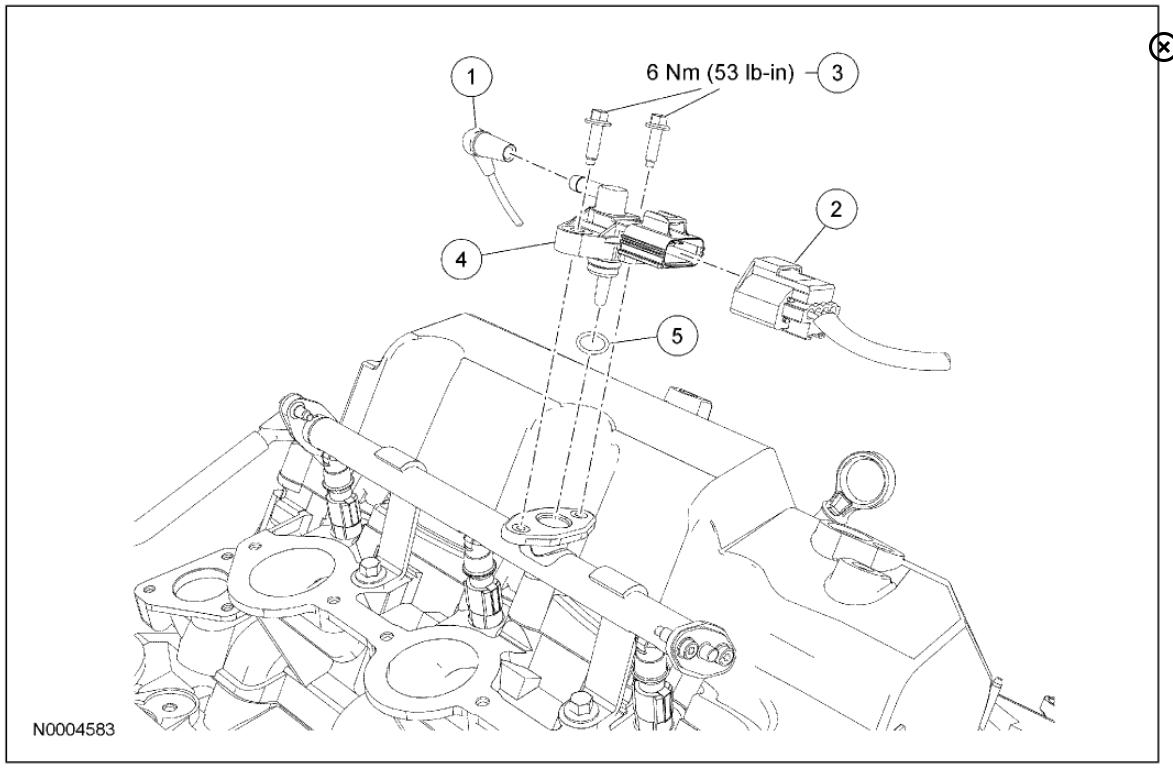

It sounds like the fuel pressure sensor has gone bad which will cause the engine to not run correctly.
Here are some diagrams to help you get the sensor changed out. When changing the sensor a small amount of fuel should come out so be ready. Engine off and cool when you are doing the repair.
