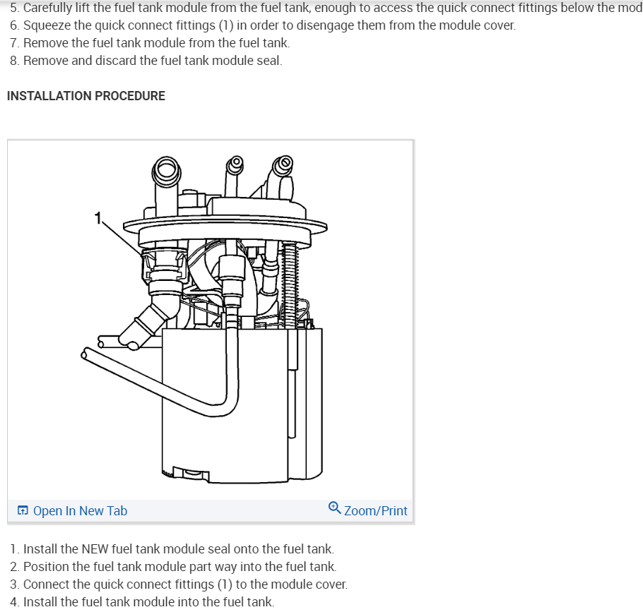

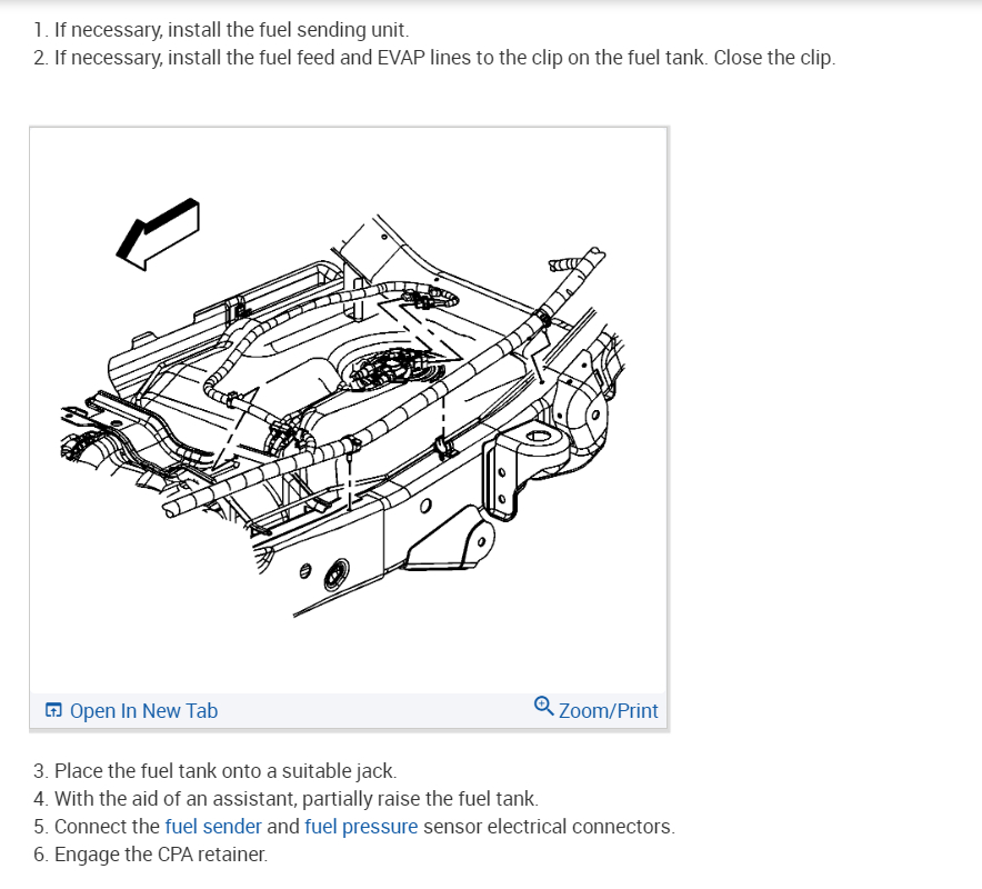

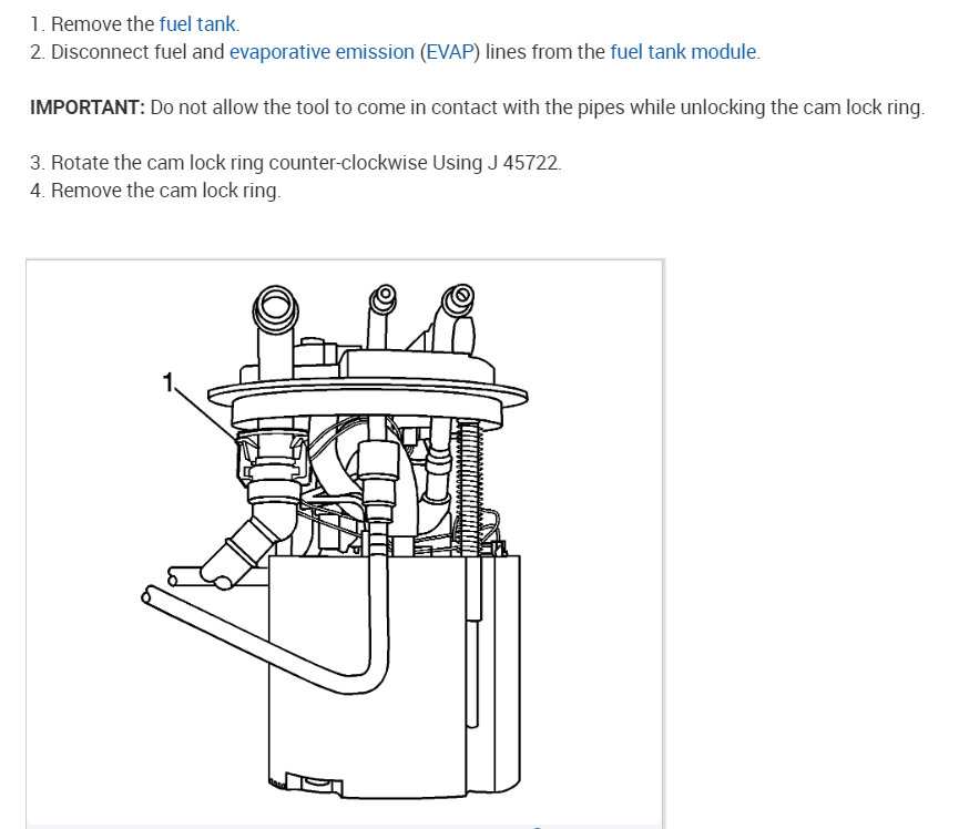

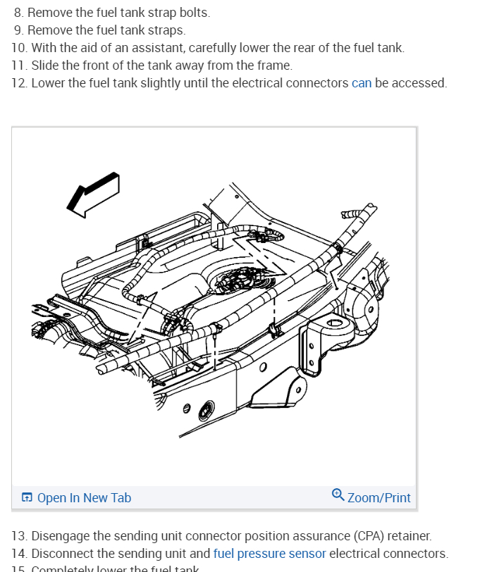

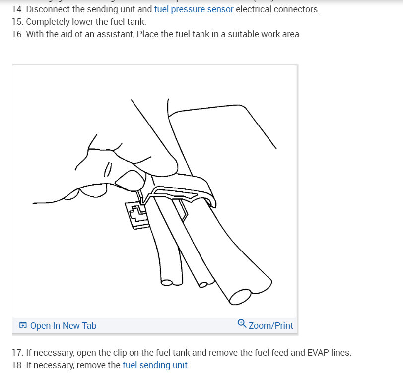

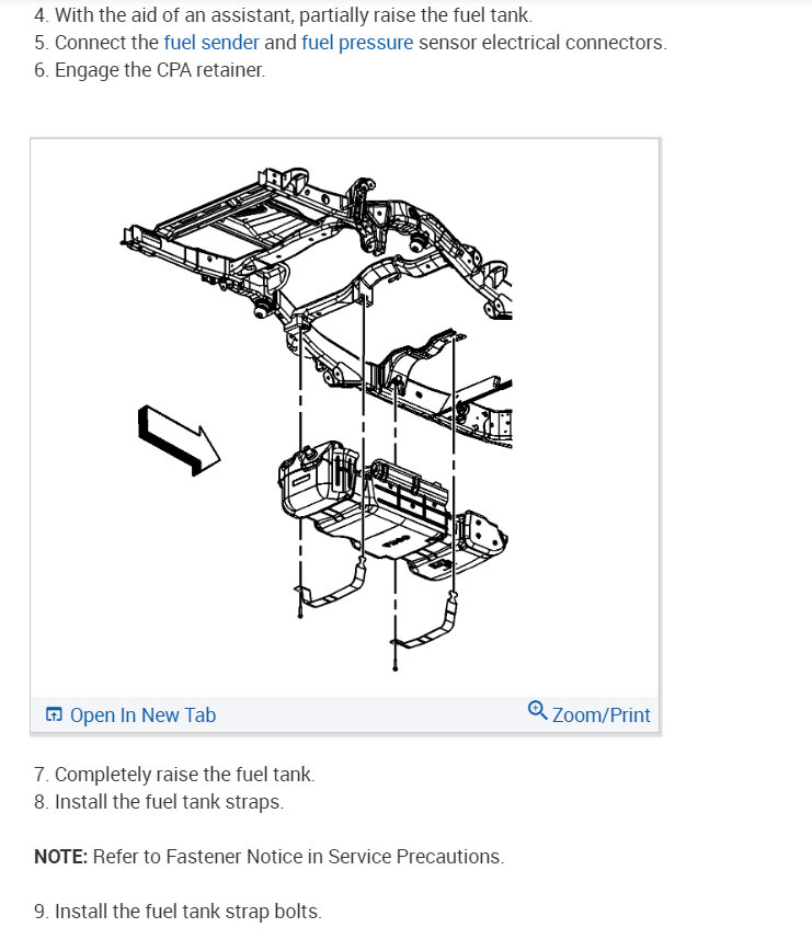

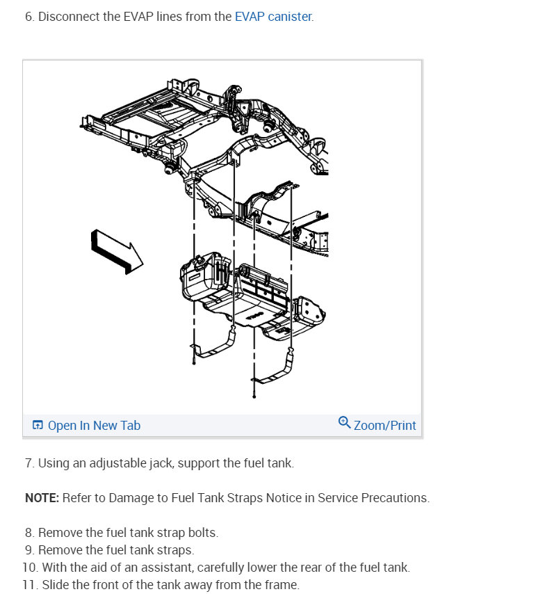

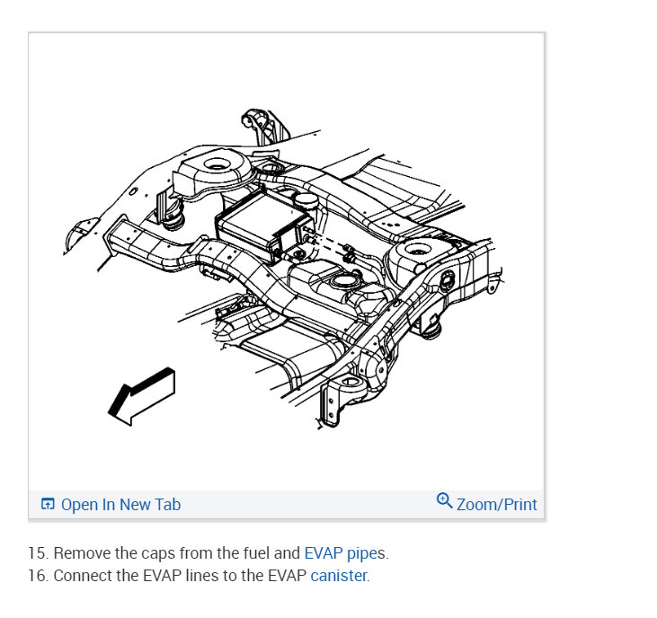

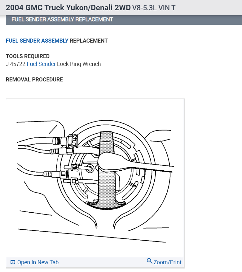

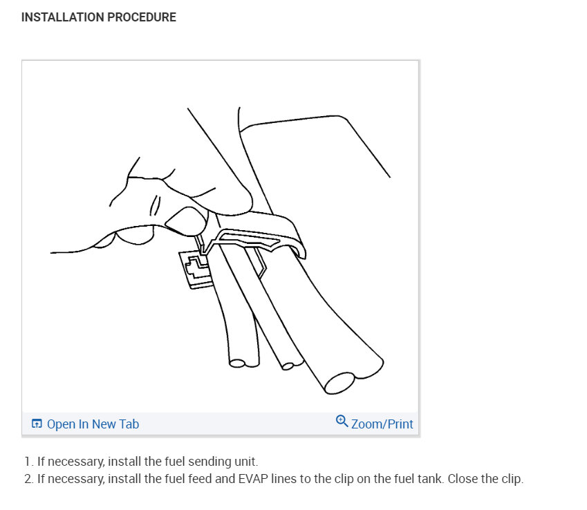

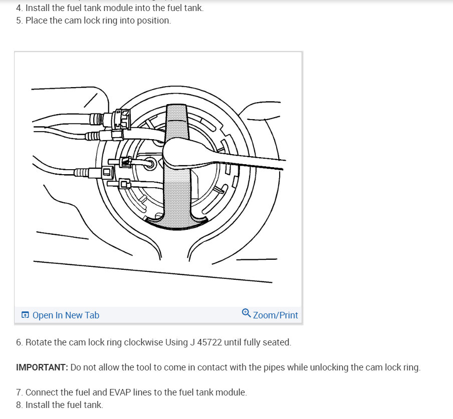

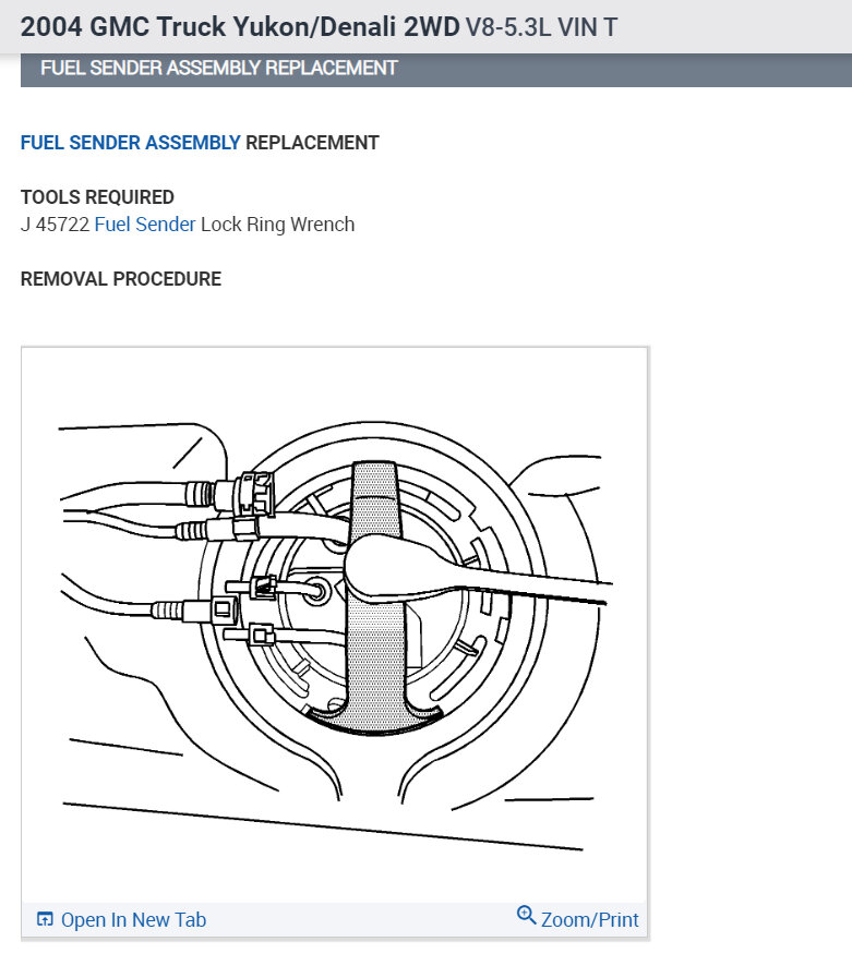

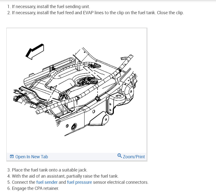

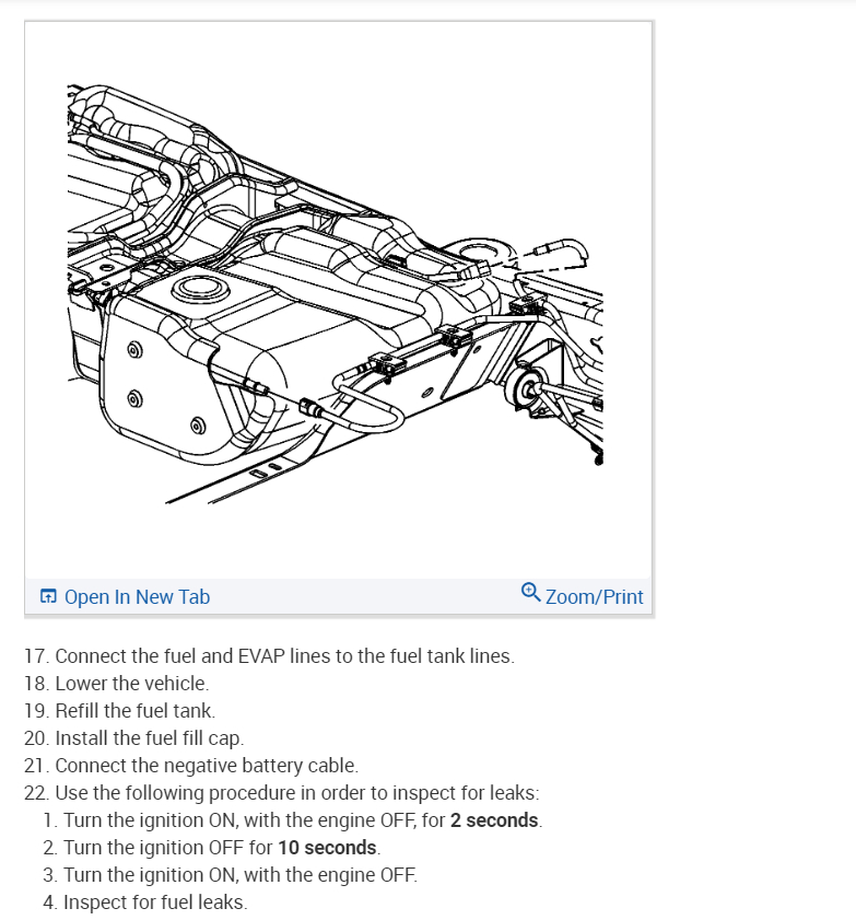

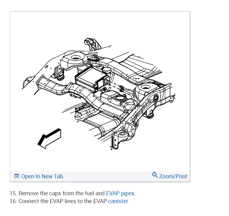

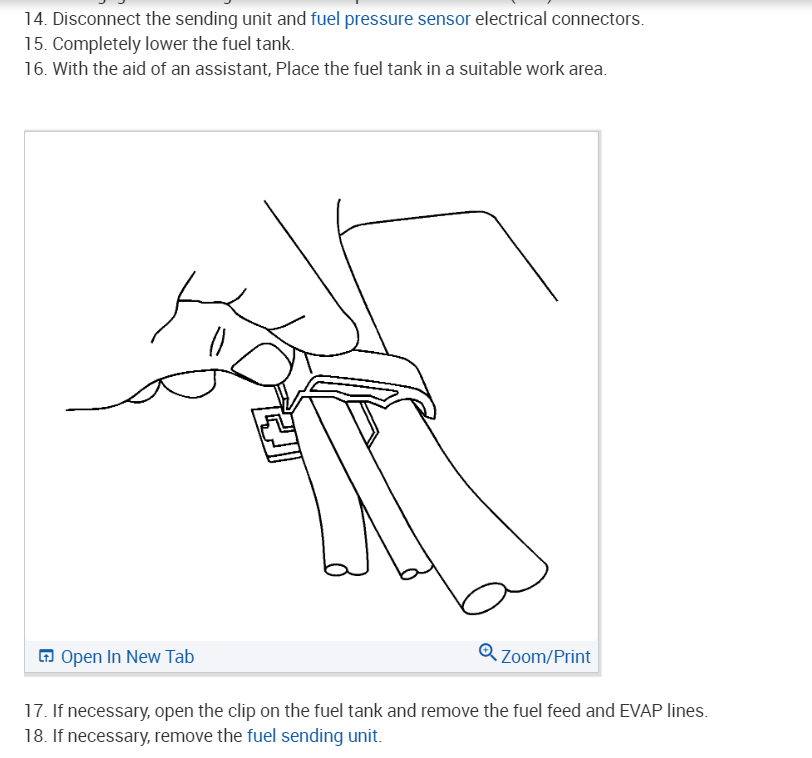

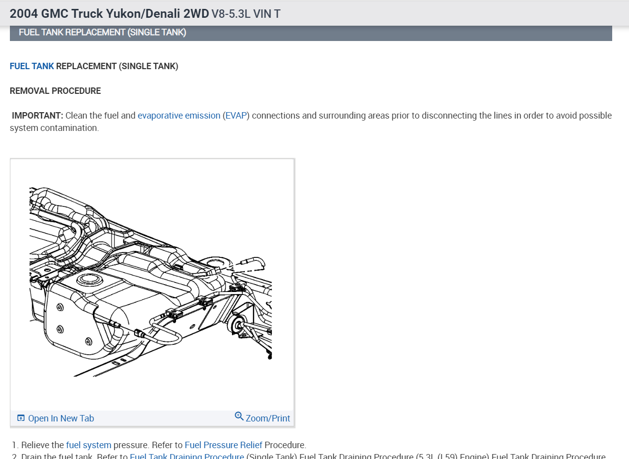

It does sound like the fuel pump is going bad, here are the fuel pressure specs and how to change the pump out in the images below:
Fuel Pressure (Key ON, Engine OFF) .................... 385-425 kPa (55-62 psi)
Fuel Pressure (vin Z) .................... 335-375 kPa (48-54 psi)
Check out the images (below). Please let us know if you need anything else to get the problem fixed.
