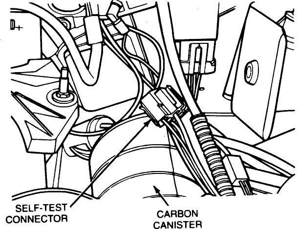

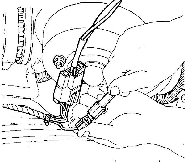

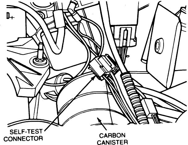

You might want to connect a small battery charger in case this test takes some time. Look for the diagnostic connector under the hood. From the drawings, it appears it is going to be near the battery. Along with that plug, there will be a single separate wire with a terminal on the end. That is the wire that must be grounded to turn on the fuel pump. Use a small jumper wire from that terminal and connect the other end to a paint-free point on the engine or body. The Engine Control relay has to turn on too, which means the ignition switch must be in the "run" position.
If the pump still sounds strong when the pressure drops, suspect the pick-up strainer.
