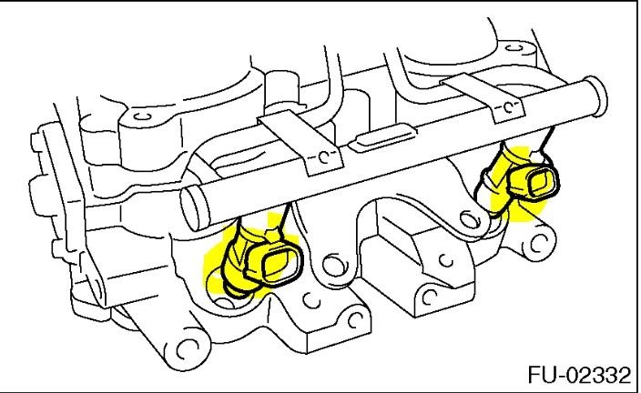

The fuel pressure seems good. However, it shouldn't drop off that fast. Since the engine isn't running as it should fuel mileage has dropped, it almost seems as if there is a stuck injector or at least a leaking injector.
Do me a favor. Here is a link that explains how to check injectors. Read through it and see if everything seems to be working properly on the vehicle.
Also, the reason I am saying injector for the pressure drop is because if the issue was before the engine (pump, filter, and so on) it wouldn't be causing decreased MPG. Try this and let me know what you find.
https://www.2carpros.com/articles/how-to-test-a-fuel-injector
The injectors aren't real easy to access. I attached a pic of how they are located on one side.
Let me know what you find.
