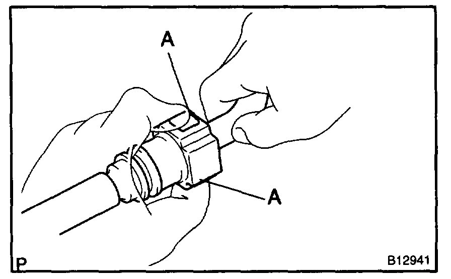

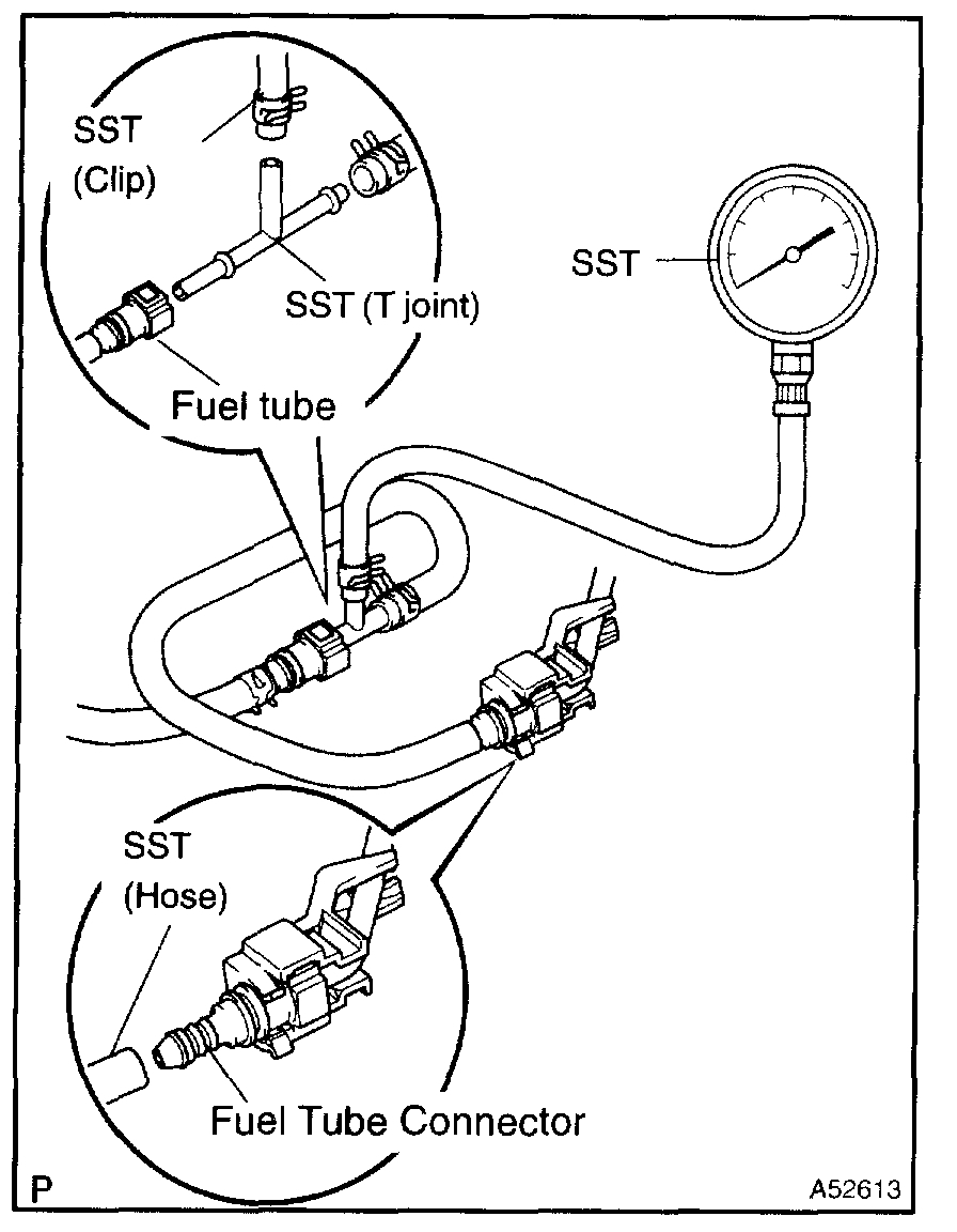

Where do you connect the fuel pressure gauge to check the fuel pressure? I do not see a Schrader valve like most cars have.
Oct 17, 2018 at 2:16 PM
Here are general directions for testing fuel pump pressure:
Here are the directions specific to your vehicle. Note: No engine size was provided, so I have attached directions for both the 4 and 6 cylinder engine. First is the 4 cylinder. Pictures 1-4 correlate with these directions. Pressure specifications are in the directions.
__________________________________________
ON-VEHICLE INSPECTION
CHECK FUEL PRESSURE
a. Prepare for inspection.

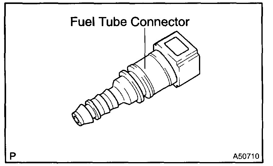

1. Purchase the new fuel tube and take out the fuel tube connector from its pipe.
HINT: Part No. 23901-28130
b. Work for prevent gasoline from spilling out.

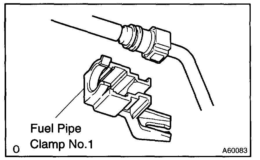

c. Remove the fuel pipe clamp No.1 from the fuel tube connector.
d. Disconnect the fuel tube connector from the fuel pipe while pinching part A with fingers as shown in the illustration.
CAUTION: Perform disconnecting operations of the fuel tube connector (quick type) after observing the precautions.
As there is retained pressure in the fuel pipe line, prevent it from splashing inside the engine compartment.
e. Install SST (pressure gauge) as shown in the illustration by using SST and fuel tube connector.
SST 09268-41047 (90467-13001, 95336-08070), 09268-45012 (09268-41250)
f. Wipe off any splattered gasoline.
g. Reconnect the negative (-) terminal cable to the battery.
h. Connect the hand-hand tester to the DLC3.
i. Measure the fuel pressure regulator.
Fuel pressure: 304 - 343 kPa (3.1 - 3.5 kgf/sq.cm, 44 - 50 psi)
If pressure is high, replace the fuel pressure regulator.
If pressure is low, check the fuel hoses and connections, fuel pump, fuel filter and fuel pressure regulator.
j. Disconnect the hand-held tester from the DLC3.
k. Start the engine.
l. Measure the fuel pressure at idle.
m. Stop the engine.
n. Check that the fuel pressure remains as specified for 5 minutes after the engine has stopped.
Fuel pressure: 147 kPa (1.5 kgf/sq.cm, 21 psi) or more
If pressure is not as specified, check the fuel pump, pressure regulator and/or injectors.
o. After checking fuel pressure, disconnect the negative (-) terminal cable from the battery and carefully remove the SST and fuel tube connector to prevent gasoline from splashing.
p. Reconnect the fuel tube (fuel tube connector).
CAUTION: Perform connecting operations of the fuel tube connector (quick type) after observing the precautions.

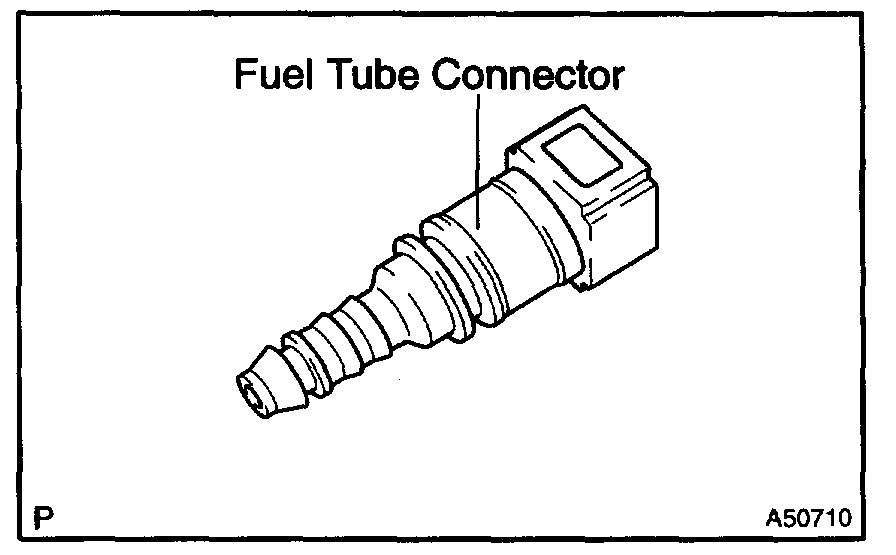

1. Purchase the new No.1 fuel pipe and take out the fuel tube connector from its pipe.
HINT: Part No. 23801-20140

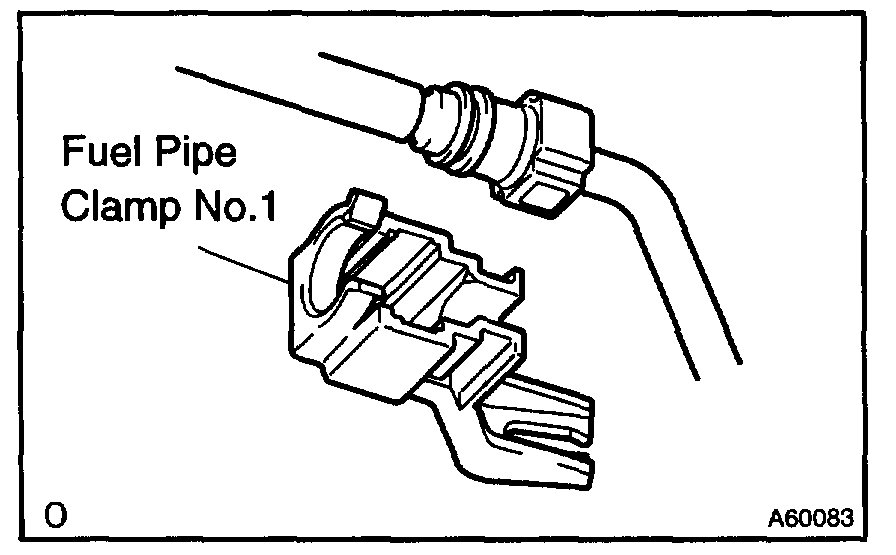

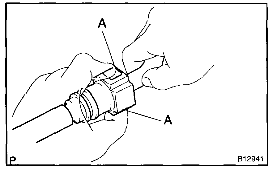

d. Disconnect the fuel tube connector from the fuel pip while pinching part A with fingers as shown in the illustration.
CAUTION: Perform disconnecting operations of the fuel tub connector (quick type) after observing the precautions.
