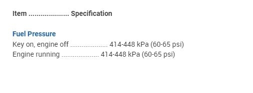

What should fuel pressure be at the fuel rail? Would like koeo and while idling please and thanks.
Feb 27, 2020 at 1:50 PM
Good afternoon,
I attached the specs for you to view.

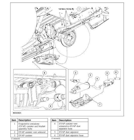

It could also be the charcoal canister at the rear of the truck. It gets filled with fuel from filling up and floods the engine.

No to the filter or regulator. It would do it all the time.
The canister I told you about is for the evap system which is all about fuel vapors.

I would check and see if there is any fuel in the canister.
Feb 27, 2020 at 6:21 PM
JUSTIN STUDDARD
  • 49 POSTS
Do they just open up once you take it off?
Feb 27, 2020 at 6:25 PM
No, it is sealed. You can remove it and turn it upside down and see if fuel comes out?
