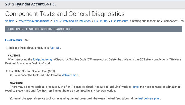

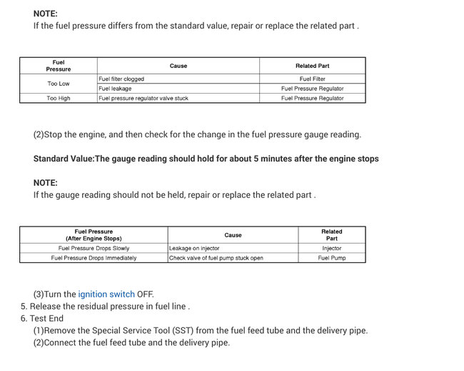

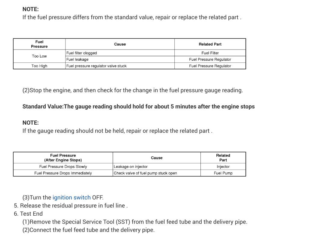

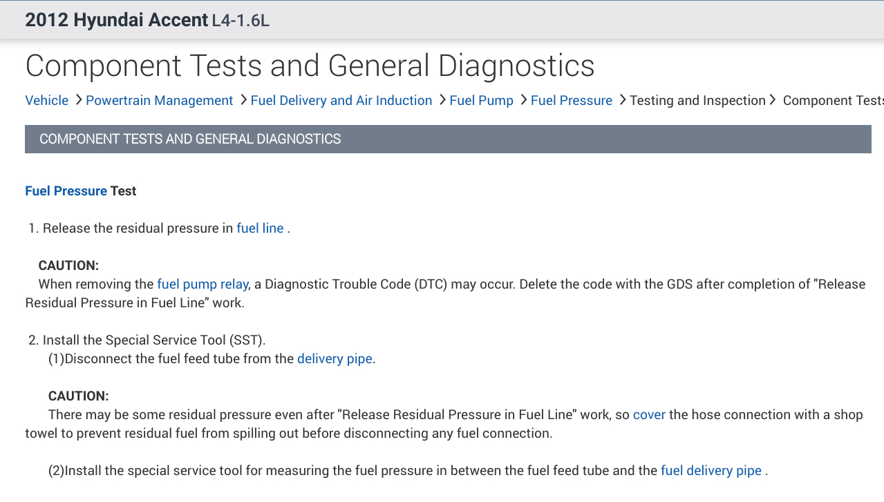

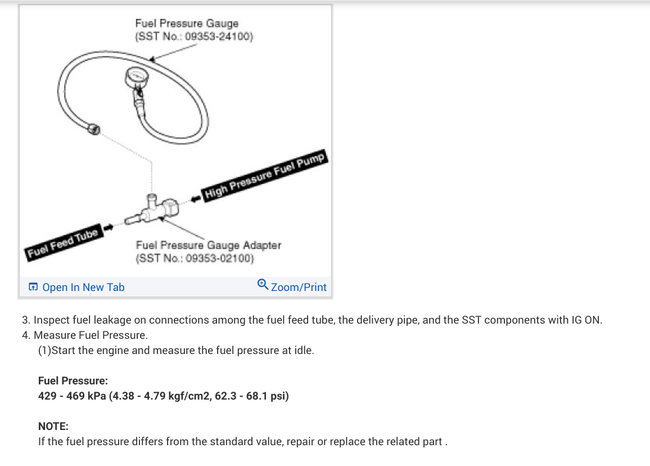

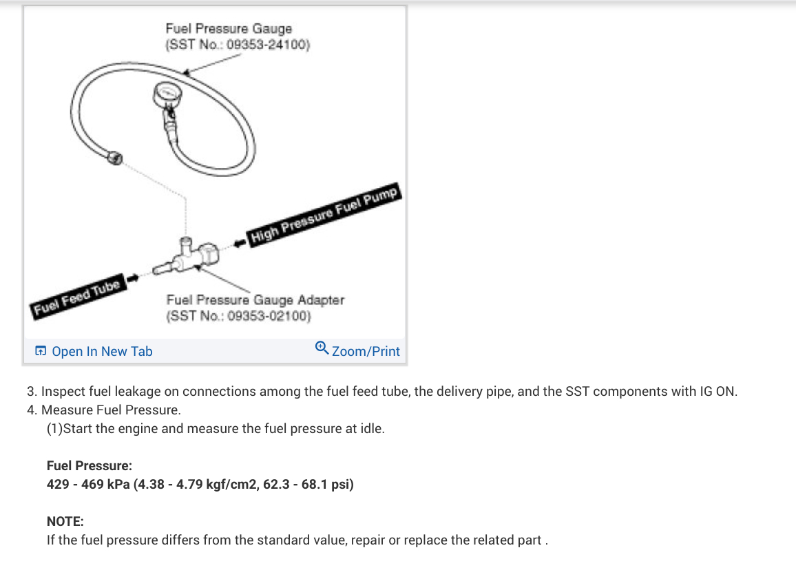

In the diagrams down below I have included the instructions for how to test the fuel pressure on your vehicle. You should be able to rent a fuel pressure tester from your local auto parts store, like AutoZone for a refundable deposit. Please go through this guide and get back to us with how everything turns out.
Thanks,
Alex
2CarPros
Mar 3, 2020 at 8:49 AM
This guide will help walk you through the testing:
