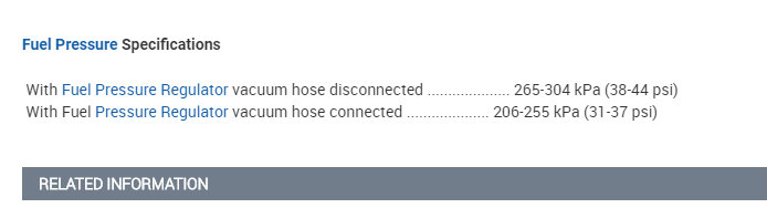

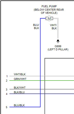

Okay. So you only need the starter fluid after it sits overnight? Then after it starts using the starter fluid and you shut it off then restart, it fires right up? If this is the case, we need the fuel pressure when you turn the key to the on position before you use the starter fluid to get it started.
If you have a weak spark, starter fluid would have no effect on it. If you have weak spark then why adding starter fluid gets it to start? Plus if you had a weak spark then why does it restart just fine after you get it going the first time?
I see no issue with the spark because you are not doing anything to change the spark to get it to start. You are only adding fuel so I see no need to suspect you have an ignition issue.
Again, when you are adding starting fluid, you are adding fuel. If it starts using this then the spark is fine and you have a fuel issue.

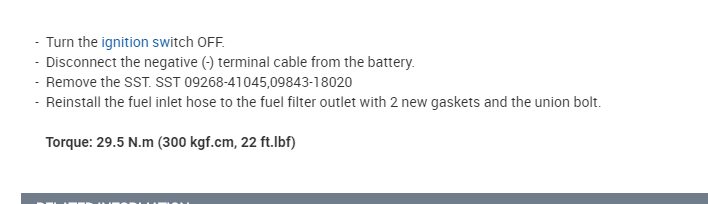

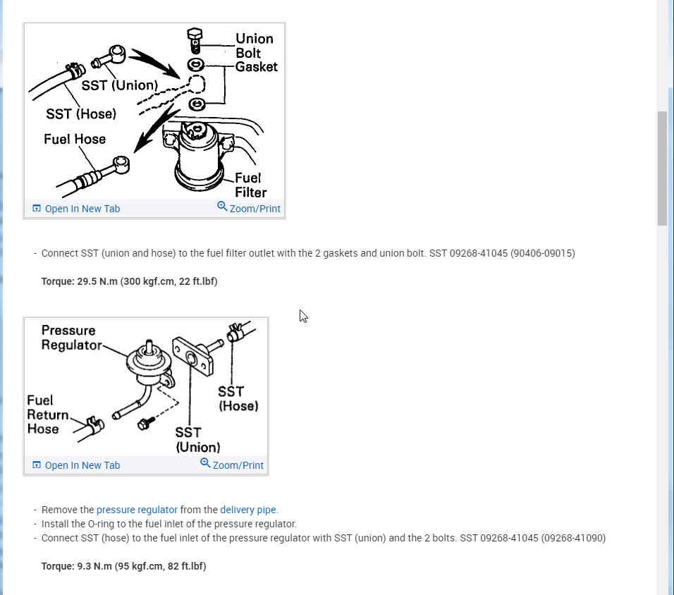

Let the car sit until it will not start without using starter fluid and just turn the key to the on position so the fuel pump primes the system and tell me what the pressure is.
