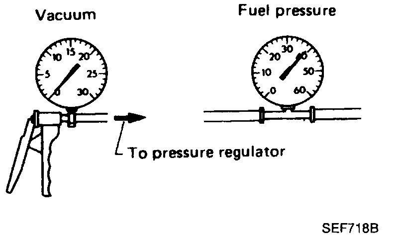

2. Disconnect fuel hose between fuel filter and fuel tube (engine side).
pic 1
3. Install pressure gauge between fuel filter and fuel tube.
4. Start engine and check for fuel leakage.

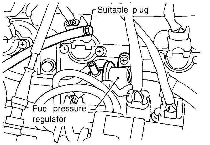

6. Stop engine and disconnect fuel pressure regulator vacuum hose from intake manifold.
Pic 2
7. Plug intake manifold with a rubber cap.

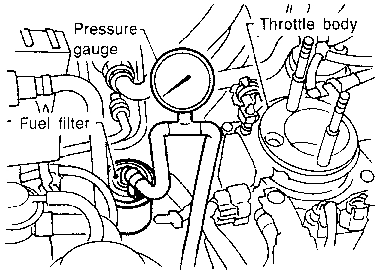

8. Connect variable vacuum source to fuel pressure regulator.
Vacuum/fuel Pressure Test
Pic 3
9. Start engine and read indication of fuel pressure gauge as vacuum is changed.
Fuel pressure should decrease as vacuum increases. If results are unsatisfactory, replace fuel pressure regulator.
