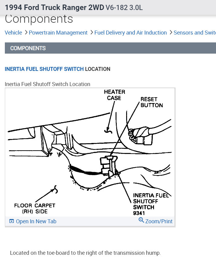

I'm going to do a fuel press check on my ranger. The manual reads that in order for the pressure to be relieved, I have to unplug the fuel pump switch. According to the manual, the switch is "directly behind the glove compartment". Can't find it. Do you guys have an idea of the location and what does it look like? Thanks a lot for your help. It is greatly appreciated.
