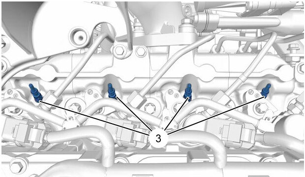

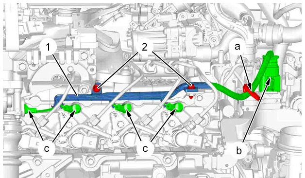

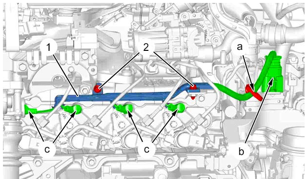

See images below for the location of the glow plugs.
These are located directly behind the injectors on top of the cylinder head.
