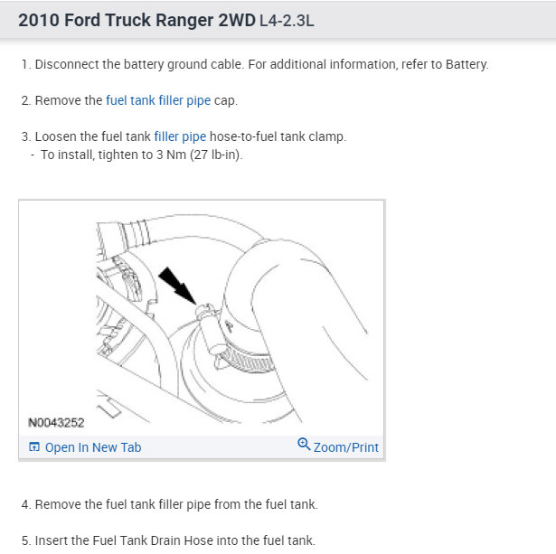

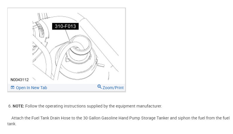

If you have not started the vehicle since adding the diesel fuel, you will need to drain the tank and fill it with fresh gasoline.
You will have to remove the fuel tank filler pipe in order to drain the fuel.

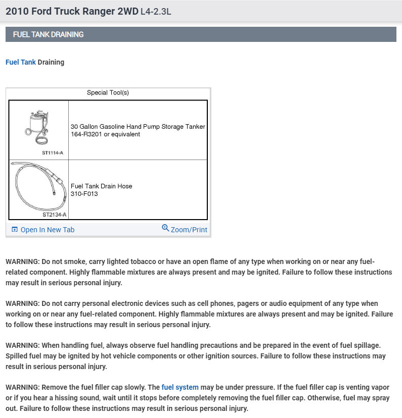

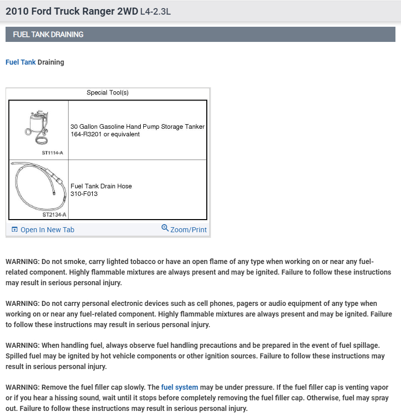

If the engine has been started, then it will require the fuel draining as well as purging out all the fuel from the lines and clean the injectors.
I have attached the fuel tank draining process below for your reference.

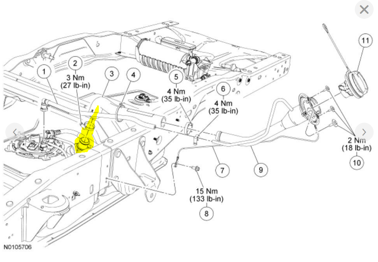

The filler pipe is attached from the filler neck to the tank. It is on the upper part of the tank, next to where the fuel pump module goes in, same side you have the filler neck. It is typically secured by a clamp.
Look at the diagram below, you want to remove the clamp on the filler pipe that I have highlighted.
