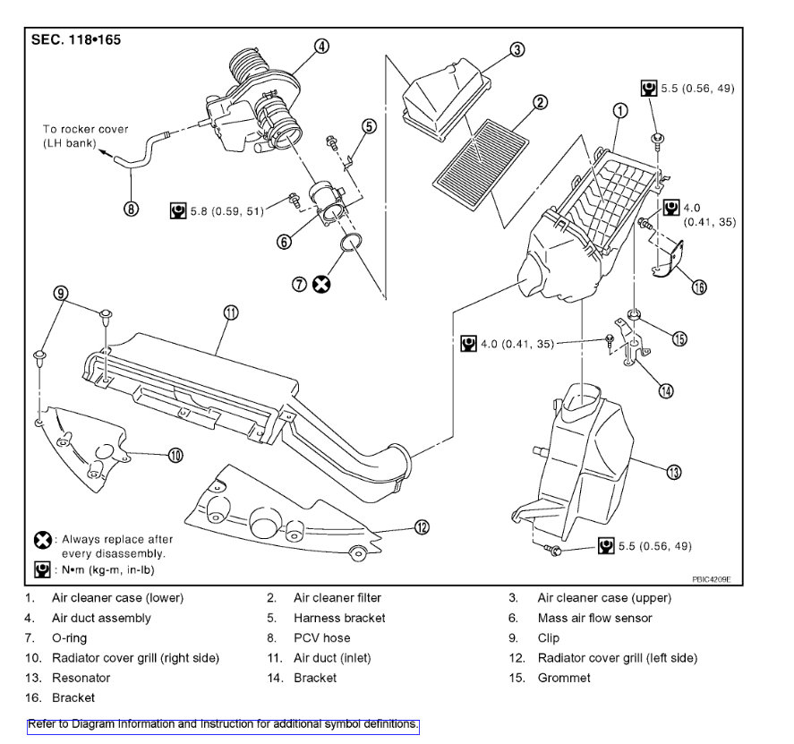

When you say throttle body and sensor do you mean the MAF sensor? I have shown its location in the diagrams below, this can cause the issue as well. Check out the diagrams (below). Let us know what happens and please upload pictures or videos of the problem.

Yes, it was the MAF sensor that I changed. I don’t have a thermometer or vacuum gauge to perform the tests. I will upload a video ASAP of the issues I am having though.
