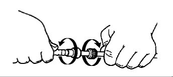

Hi and thanks for using 2CarPros.com. I have attached the directions for removing and replacing the coupler. Once you have it apart, check to make sure the o-ring between the two components is good. Check for cracks, nicks.
Here are the directions. It does require a special tool. The attached pictures correlate with these directions.

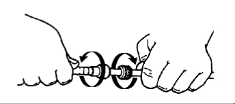

Grasp both sides of the fitting. Twist the female connector 1/4 turn in each direction to loosen any dirt within the fitting.

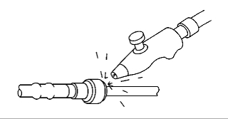

Blow dirt out of the fitting using compressed air.

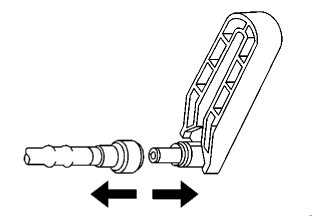

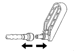

Choose the correct tool from J 37088-A for the size of the fitting. Insert the tool into the female connector, then push inward to release the locking tabs.
Pull the connection apart.

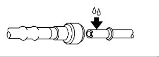

CAUTION: In order to reduce the risk of fire and personal injury, before connecting fuel pipe fittings, always apply a few drops of clean engine oil to the male pipe ends.
This will ensure proper reconnection and prevent a possible fuel leak.
During normal operation, the O-rings located in the female connector will swell and may prevent proper reconnection if not lubricated .
Apply a few drops of clean engine oil to the male pipe end.

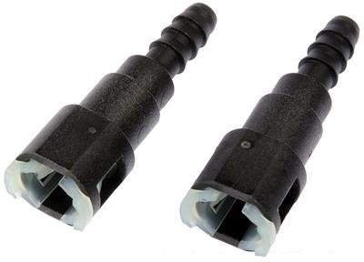

I completed the procedure. However, the fitting is loose and there is still fuel leaking out of the fuel rail. Do I have to replace the whole line? Also, my connection is nylon not metal. Does that make any difference?
May 23, 2018 at 5:19 AM
Hi again. You should be able to purchase a new o-ring as well as the clip that holds it together. However, if you would rather, they make a replacement fitting. I attached a picture of what one looks like for a GM vehicle. It helps eliminate the replacement of the entire fuel line. I believe the Dorman part niumber is 800-080. Confirm that is the correct part for your vehicle, but I believe it is. If you call a local parts store, just tell them you want a replacement fitting made by Dorman and you believe the part number is 800 080. Then have them confirm it is the correct one for your vehicle.
Let me know if this helps.
