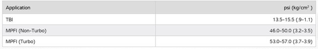

what was fuel pressure? if not minimum in pic then pump is bad, or a plugged fuel filter. sure sounds like it.
