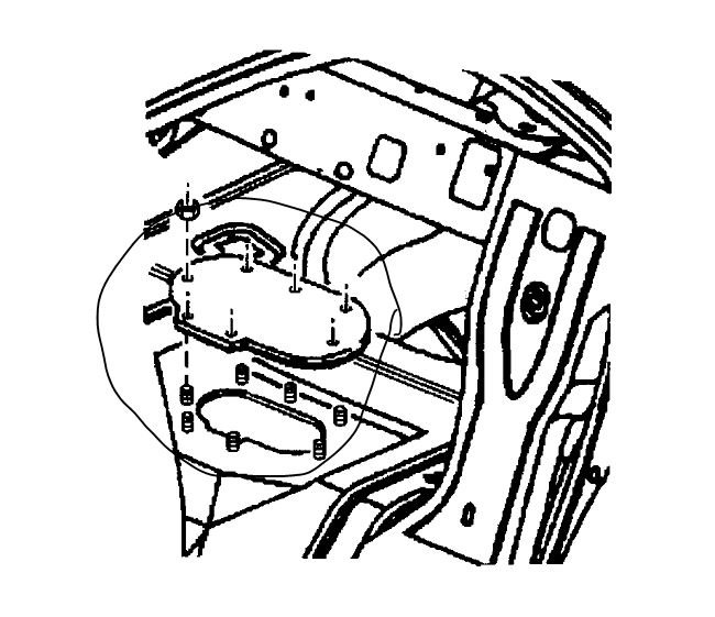

Two part question:
1》 Where is my fuel level sensor?
2》 Is it easy to replace?
3》Would this be the cause of my incorrect gauge readings when the gas is low it reads out of gas but when I drive the car 1/8 mile, the lever goes up one bar.

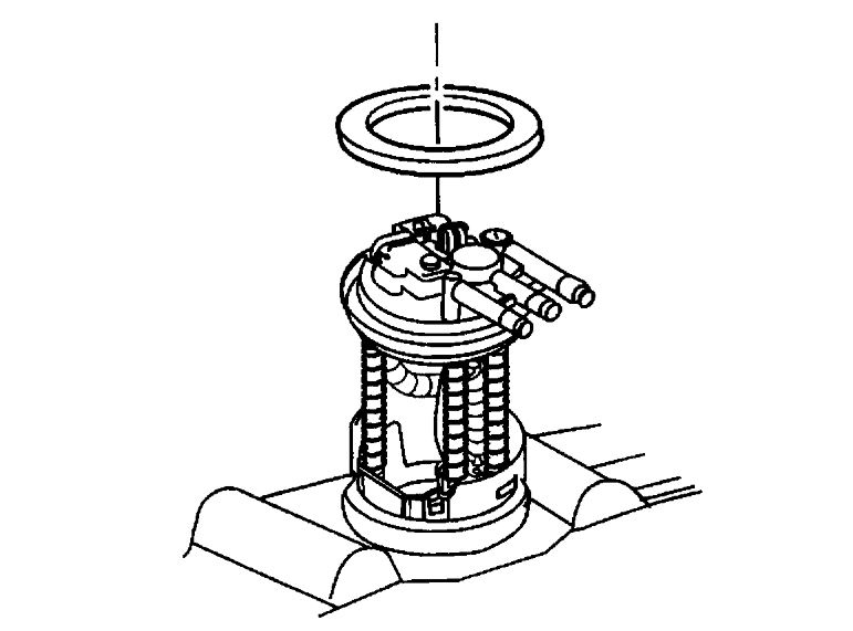

The fuel level sensor is in the fuel tank and is part of the fuel pump assembly. You will have to replace the fuel pump assembly.
The fuel tank will have to be dropped to gain access to the unit. There are some models that have an access panel in the trunk. You will need to verify it. If there is no panel, the tank must be dropped.

Always replace the fuel sender O-ring when reinstalling the fuel sender assembly.
The modular fuel sender assembly will spring-up when the snap ring is removed.

1. Relieve the fuel system fuel pressure. Refer to Fuel Pressure Relief Procedure.
2. Remove the trunk liner.
3. Remove the (7) nuts retaining the fuel sender access panel.
4. Remove the fuel sender access panel.
5. Disconnect the fuel tank pressure sensor electrical connector.
6. Disconnect the fuel sender electrical connector.
7. Clean the fuel pipes, and fuel sender assembly to prevent possible fuel contamination during removal.
8. Disconnect the quick-connect fittings at the fuel sender assembly.
