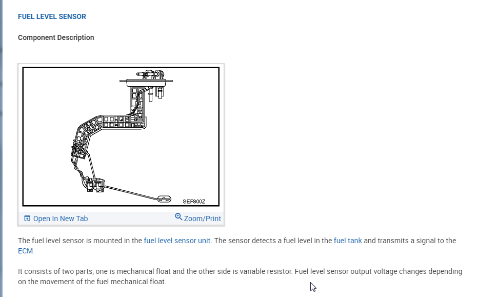

I attached the operation of the sensor and it takes the position of the float via a voltage signal and sends that to the ECM. Then the ECM sends that to the cluster for it to display the proper reading.
So to confirm this, we need to check voltage output from the sensor or use a scan tool to monitor the voltage output from the sensor.
Once we know this, we will know the position of the float.

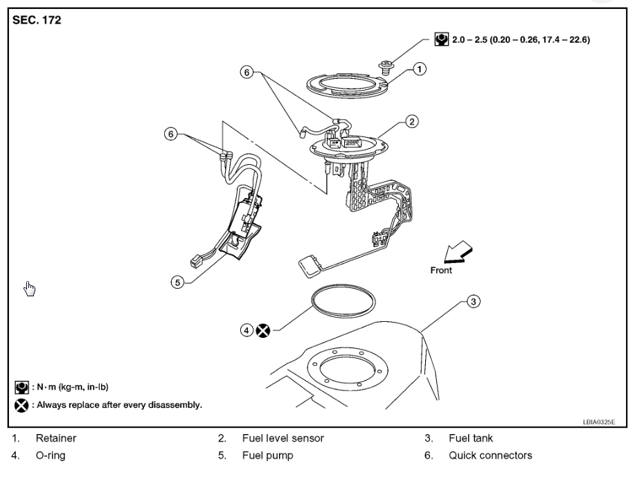

Yeah. I have never done one on an Xterra so I can't speak from experience but I included a picture of the assembly and orientation to the front of the vehicle. Hopefully this helps.
Aug 11, 2020 at 6:47 PM

am pretty sure I installed it with the floater towards the front, I will check again. Thanks

I turned the whole assembly a bit and watched the gauge and it went up to half, it works now. thanks guys
