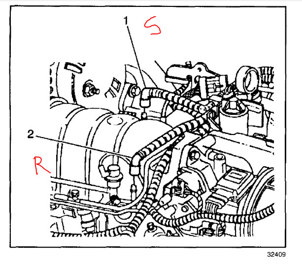

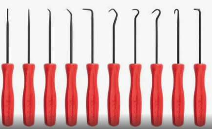

Often times, the connector is replaced. They make replacement parts that get installed onto the existing hose. On the other hand, once the connector is off, you will see the 0-ring inside the connector. To replace it, I always use a pic to remove the old one.
One out, you have to get the same size o-ring for replacement. If it isn't the same as the original, it will leak. There is a good bit of pressure on it.
Once you get the new one, it's nothing more than reinstalling it into the connector. I like to put (don't laugh) a little Vaseline on the new o-ring to help prevent the chance of damage when installing it.
Let me know if that helps.
