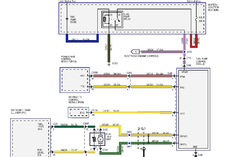

Make sure battery has a full charge and connections are good? Note the diagram, I can't go by what somebody else said, I'd have to do testing. See the fuse, upper right, check that fuse, also use test light on fuse circuit, hot all the time. See the fuel pump relay, has two sides, the switch side is right side in the diagram, the control side, left side in picture. You can pull relay, use test light between cavities 85 and 86, engine cranking if the test light lights up, you have voltage and ground good enough for the test light. Terminal 30 cavity at relay, hot all the time, note the fuse. At the bottom of diagram, see the M, that is fuel pump motor, the yellow wire is voltage, the green wire is ground, You use test light there, also.

Use a jumper wire at the fuel pump driver module and jump pins 1 to 5 and 4 to 8. If it runs, replace the fuel pump driver module.
Mar 1, 2019 at 8:04 PM
MLJOHNSON1999
Thanks guys for all your help....we took a chance a went and bought a fuel pump driver module for 82 bucks..plugged it in and car started right up. I appreciate all your help and answers!!

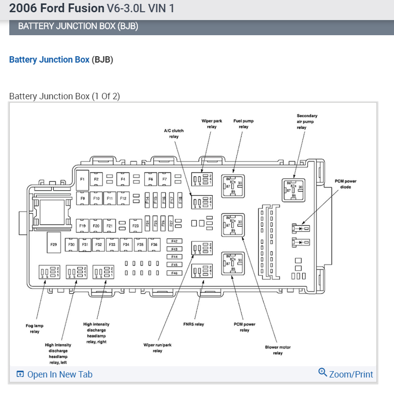

The 2006 does not have a driver module.
Sep 24, 2019 at 9:05 AM

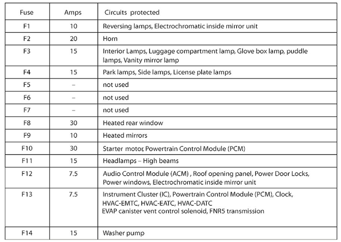

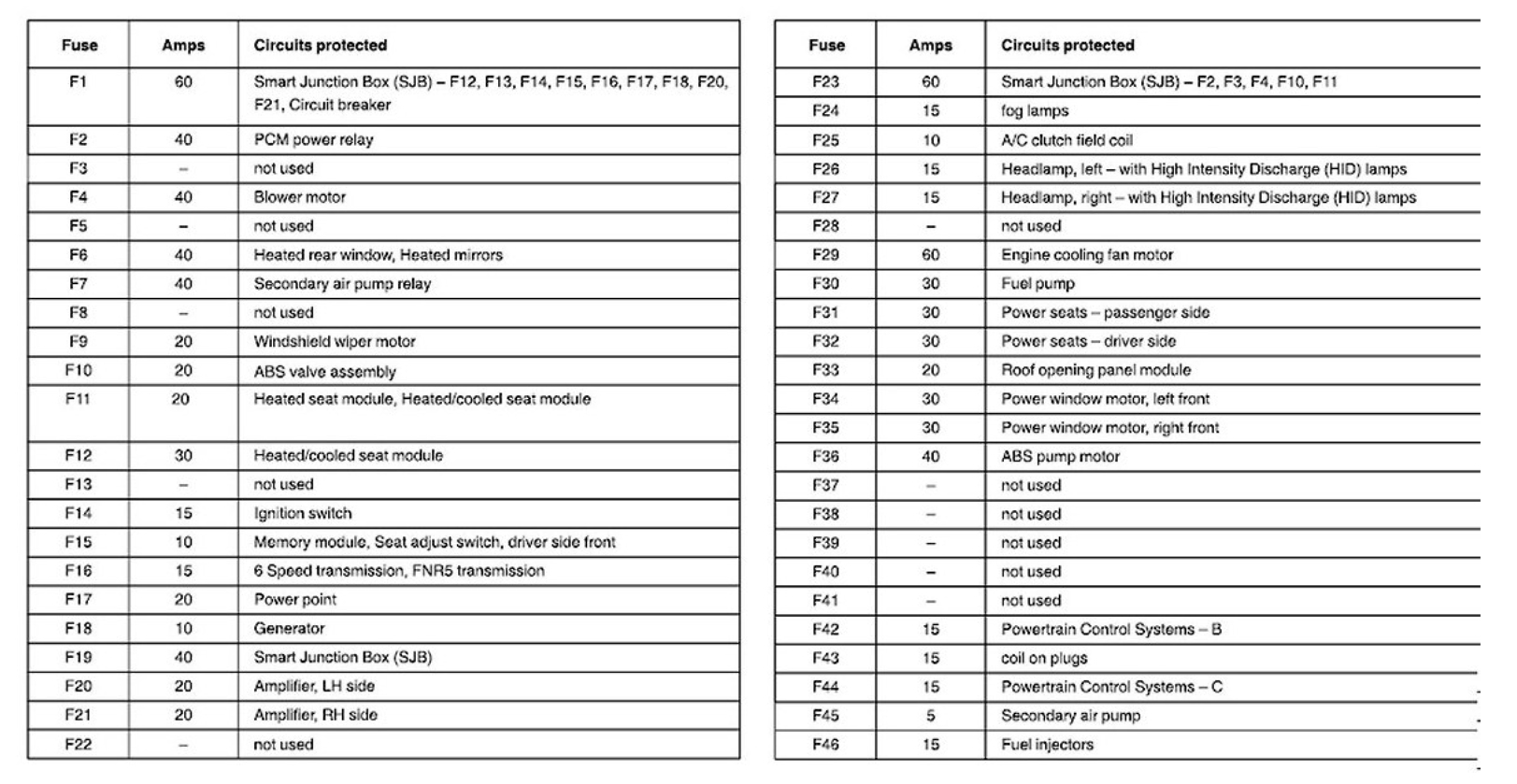

In 2006 there is a fuel pump relay under the hood. here is the location with a guide to help check it:
Here are the fuse and relay locations you can save this in your favorite for future reference. Check out the diagrams (below). Please let us know what happens.
