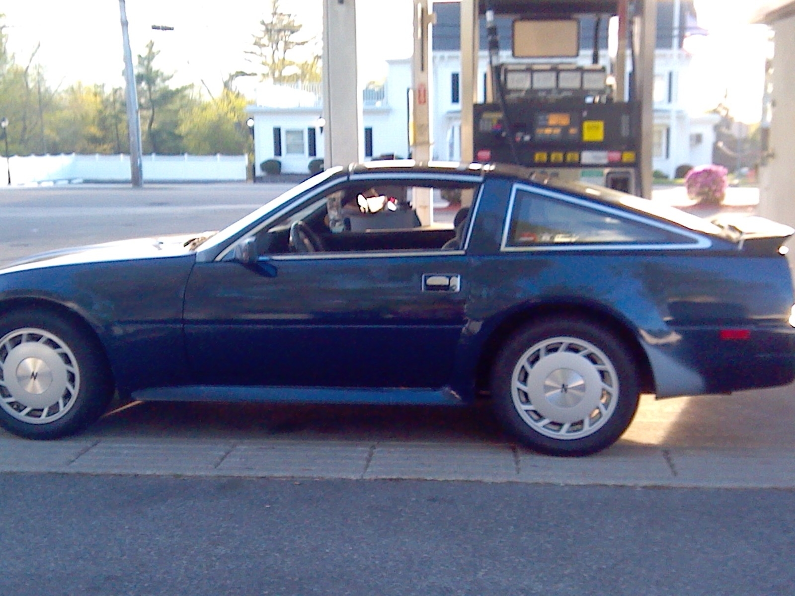

I received my "new" used computer from a guy in Virginia and installed it, but it is still not getting injector pulse. It starts with starter fluid. I do not know if computer is good or bad? It must be good? I have an 1988 motor in a 1986 body. Could the fuel pump possibly be bad? Gas is getting past the filter when key is turned, but have not tested how much pressure is in the line. And the injectors do still not get signal to open and close!
I have a new distributor coming Tuesday with the crank angle sensor.
Thanks for trying to help. I will let you know how I am making out.
Yes, it is the same car.
