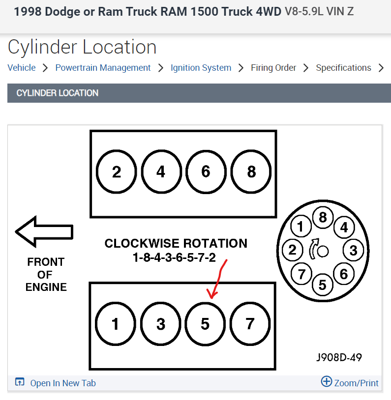

I don’t know the numbering for the injectors I need to replace one for cylinder 5 for misfire P0305. the numbers labels ripped off and don’t know what fuel injector goes to cylinder 5.
Sep 15, 2024 at 1:13 PM

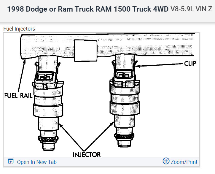

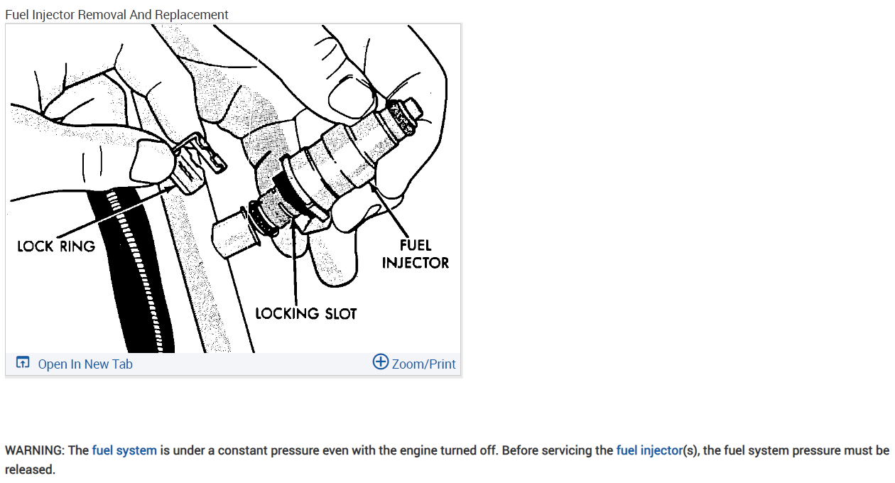

Here is the engine cylinder ID so you replace the correct fuel injector, also I have included instructions on how to do the job. Here is a generic guide to help you step by step with instructions in the diagrams below to show you how on your car.
