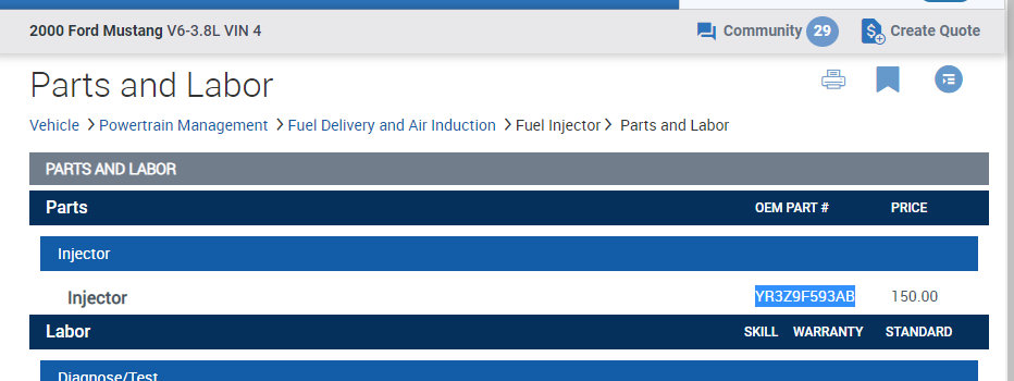

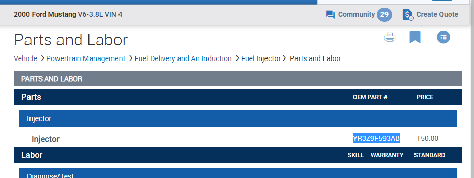

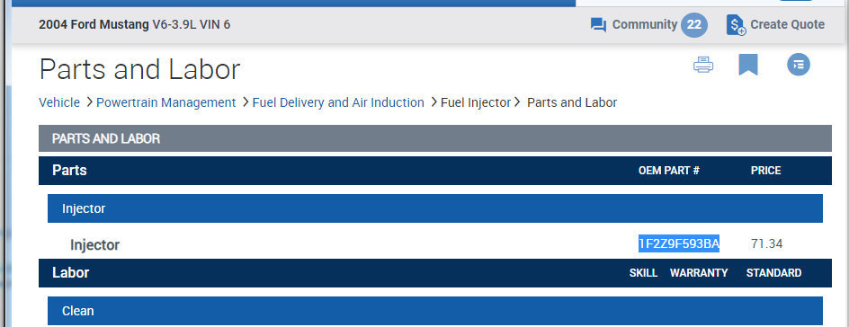

Are the fuel injectors on the car listed above the same as on a 3.9 2004 Mustang? If so or not can i put injectors from a 3.9 2004 Mustang on a 3.8 2000?
Feb 2, 2021 at 4:03 PM
They are different part numbers but it looks like they fit both the 3.9L and 3.8L. This would make sense as they are basically the same engine. However, what I cannot find is that the 2000 3.8L fits the same as the 2004.
Due to not finding the direct compatibility, I cannot tell you for sure but if you have access to a set of them then I would lay them side by side and see if they are different. I am seeing enough info that tells me they would work.
The connectors are the same and they operate the same so that is not the issue. The only question would be is if they physically fit.
Let us know what you find. Thanks
