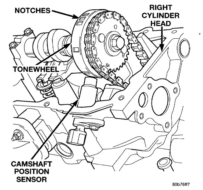

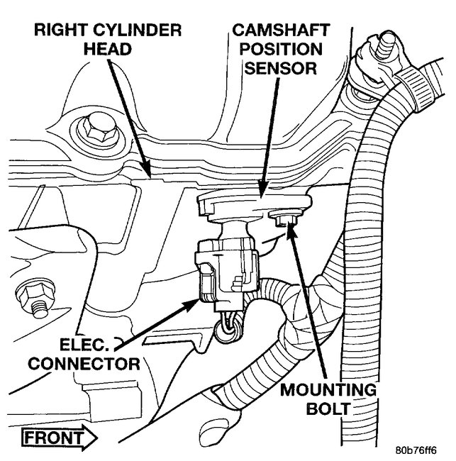

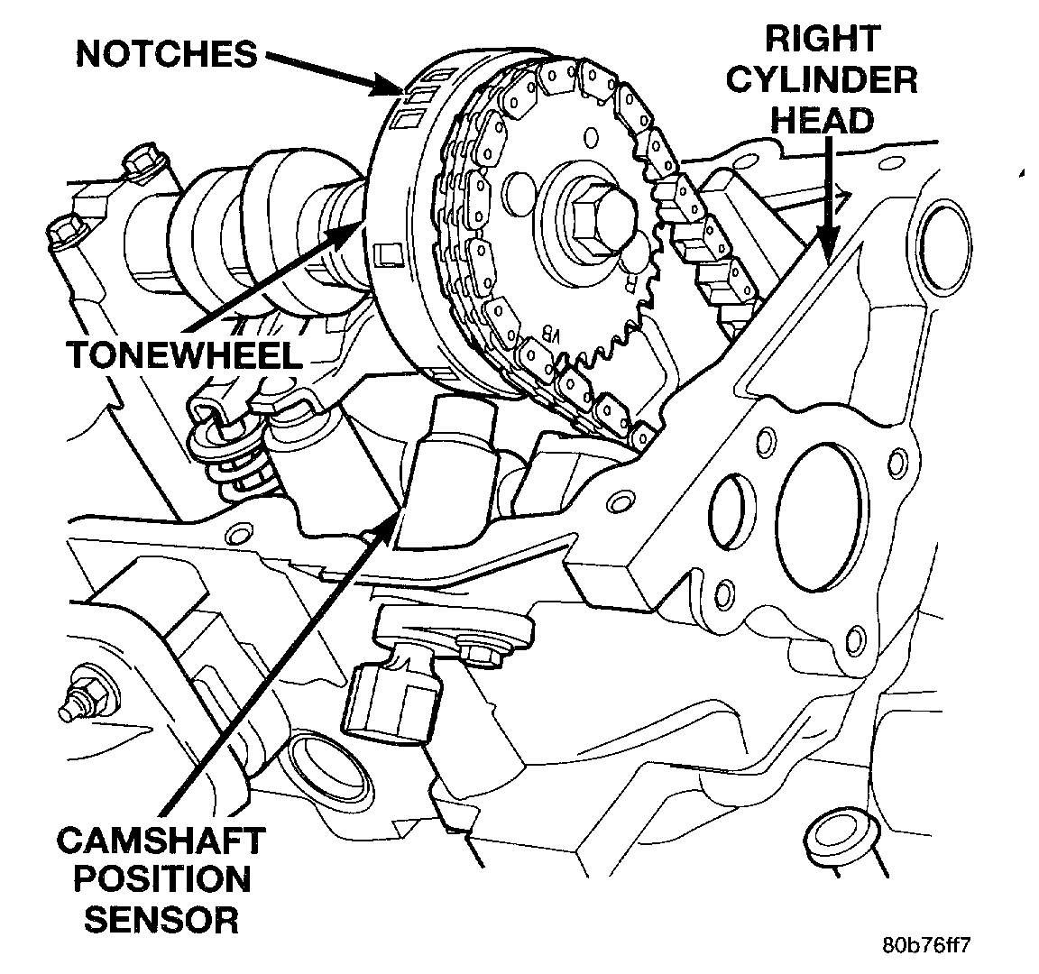

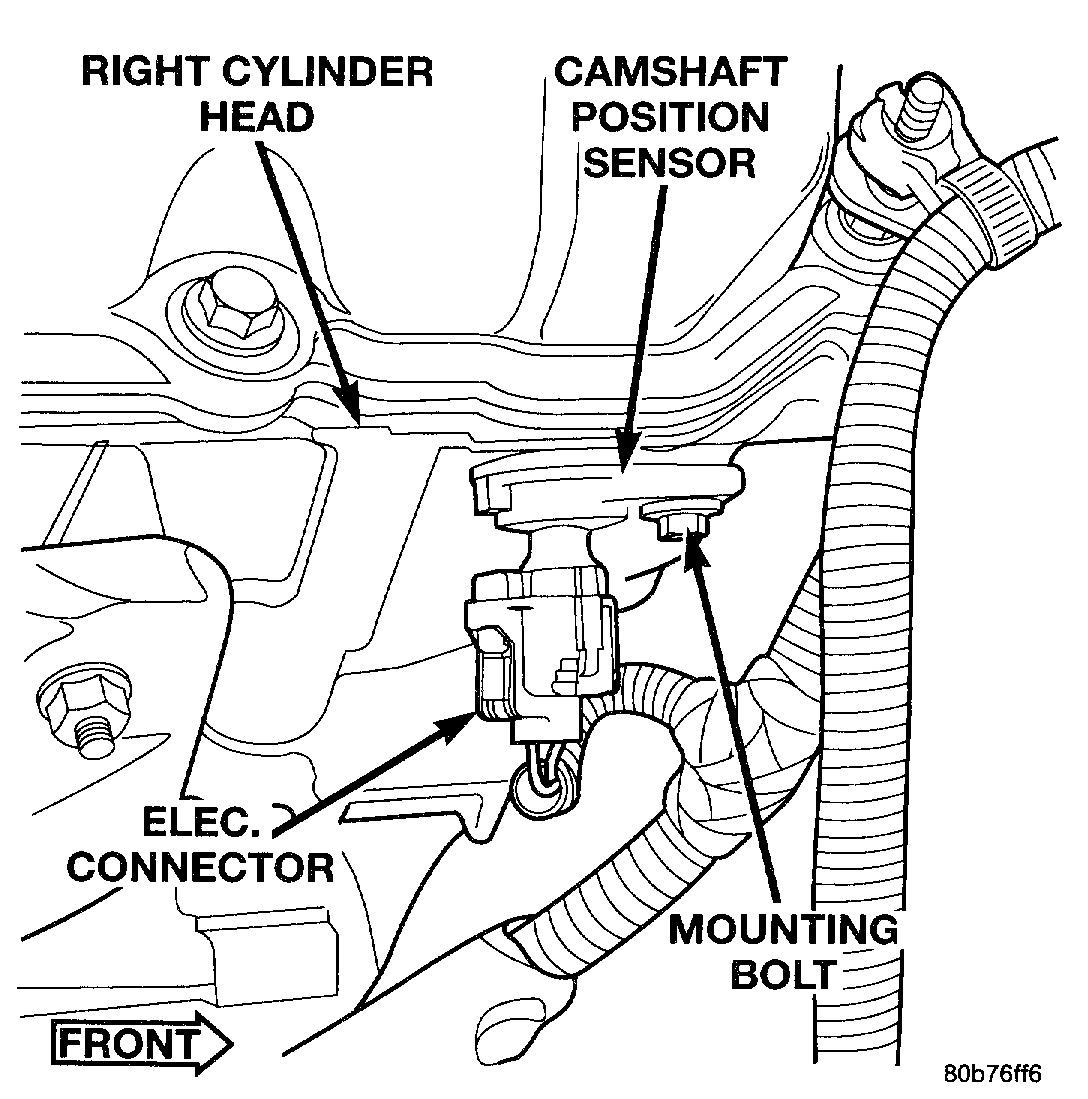

It sounds like you may have a problem with the camshaft position sensor (CMP). The camshaft position sensors (CMP) contains a hall effect device called a sync signal generator to generate a fuel sync signal. This sync signal generator detects notches located on a tonewheel. The tonewheel is located at the front of the camshaft for the right cylinder head. As the tonewheel rotates, the notches pass through the sync signal generator. The pattern of the notches (viewed counter-clockwise from front of engine) is: 1 notch, 2 notches, 3 notches, 3 notches, 2 notches 1 notch, 3 notches and 1 notch. The signal from the CMP sensor is used in conjunction with the crankshaft position sensor to differentiate between fuel injection and spark events. It is also used to synchronize the fuel injectors with their respective cylinders. I attached a two pictures of the unit and where it is located.
