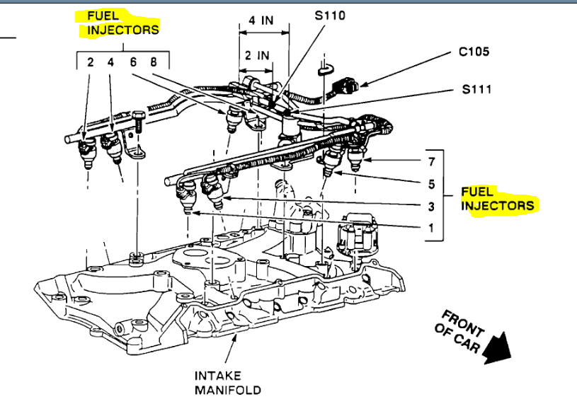

Where is the location of the fuel injectors?
Mar 18, 2023 at 7:11 AM
The fuel injectors are between the intake manifold and the fuel rail. See pic 1 below.

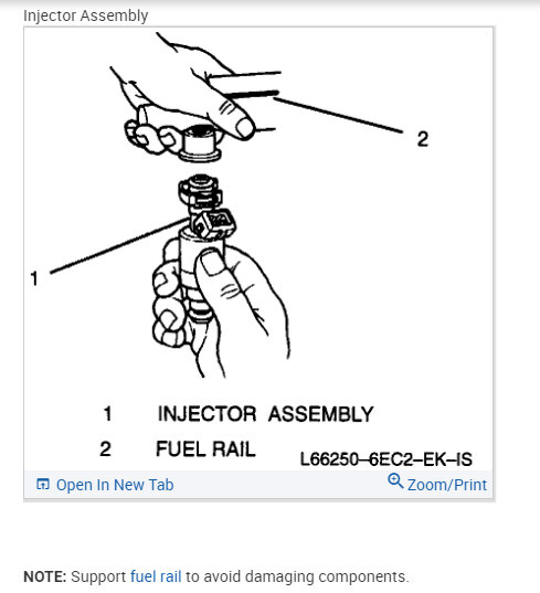

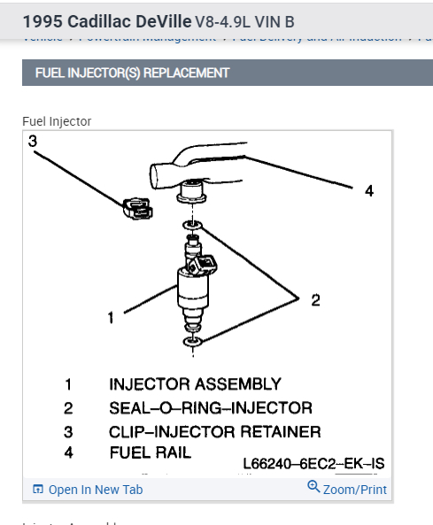

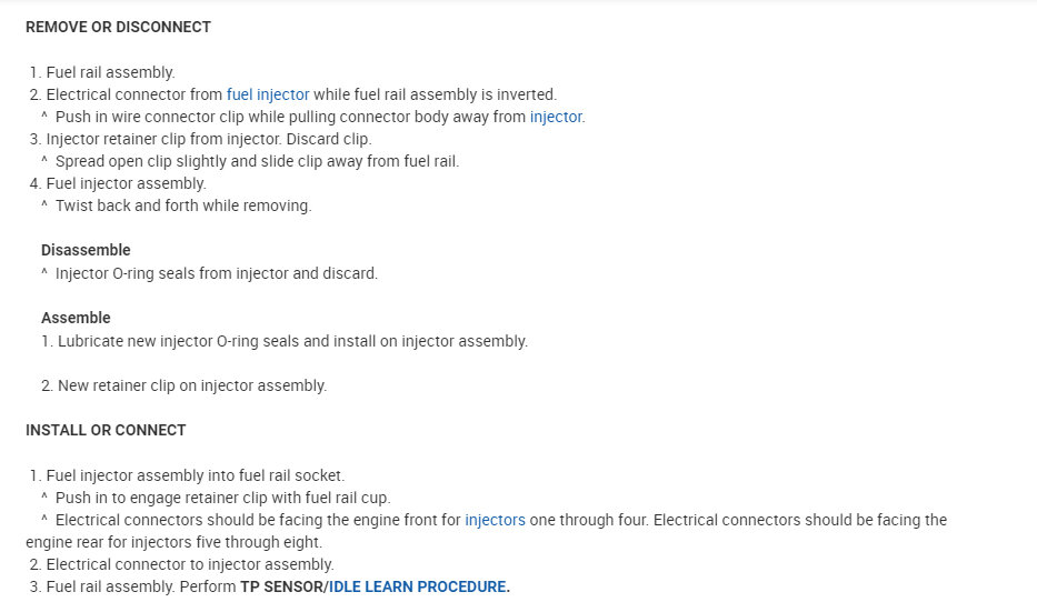

As far as replacement, you will need to disconnect the negative battery terminal first. Next, the fuel rail is unbolted. Once you have done this, the injectors are accessible.
I attached the directions for replacing them for you below. (Last 3 pics) Also, here is a link that explains in general how it is done. Actually, you will likely find this more helpful than the manual's directions. LOL
https://www.2carpros.com/articles/how-to-replace-a-fuel-injector
Let me know if this helps or if you have questions.
