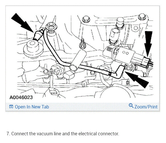

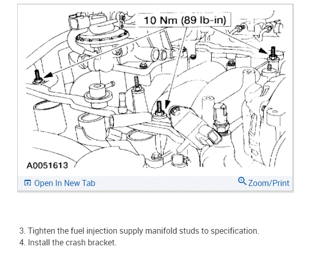

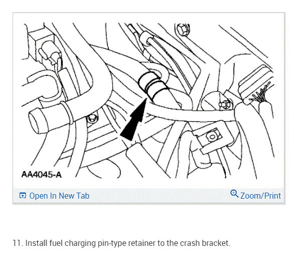

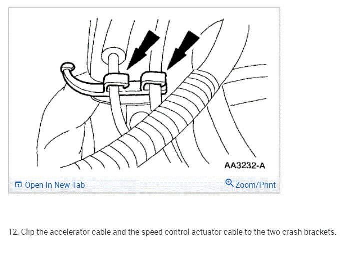

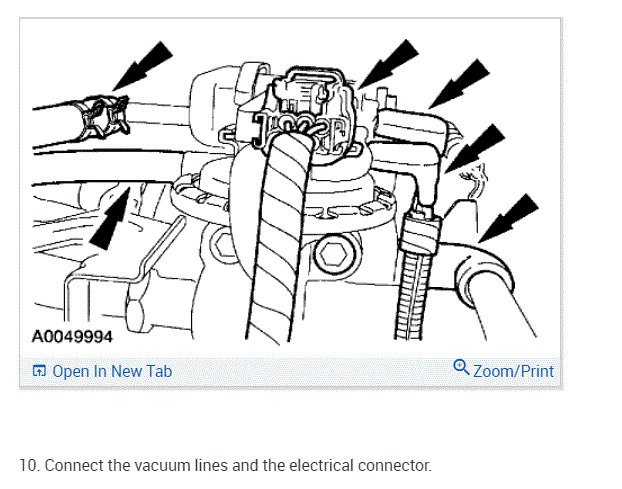

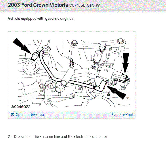

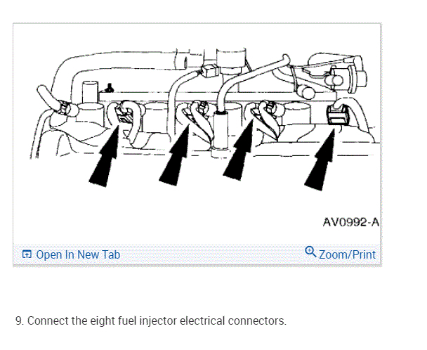

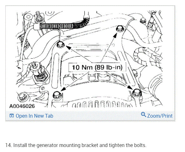

I released the pressure on the fuel rails, then pulled them to get to the spark plugs, and changed them out with new ones. Then I put the rest of the parts back on, and tighten fuel rails. Now the car won’t start. All it does is crank over and over. Please help please detailed answers.
