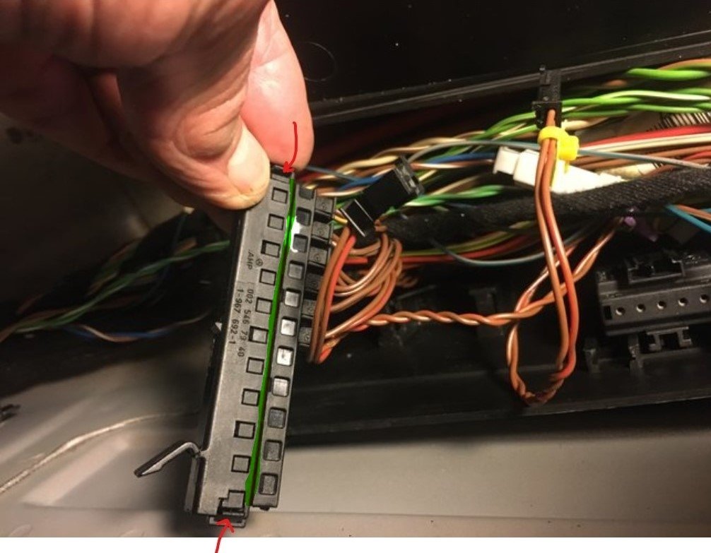

Hi Wendy,

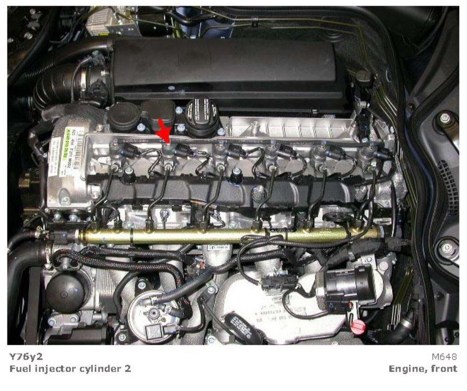

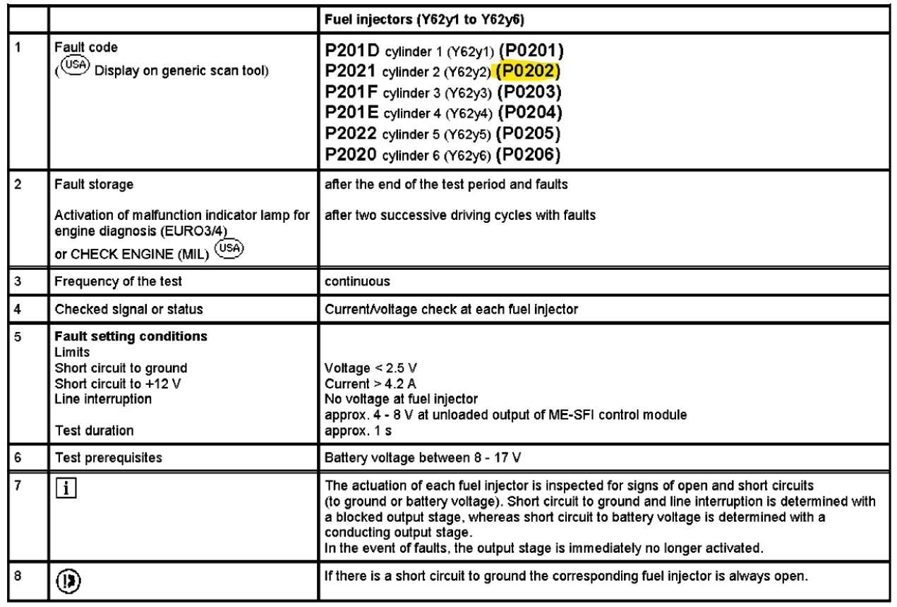

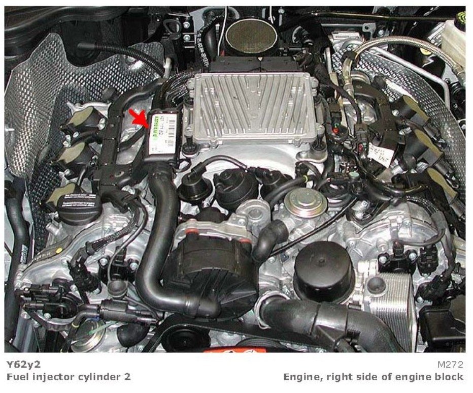

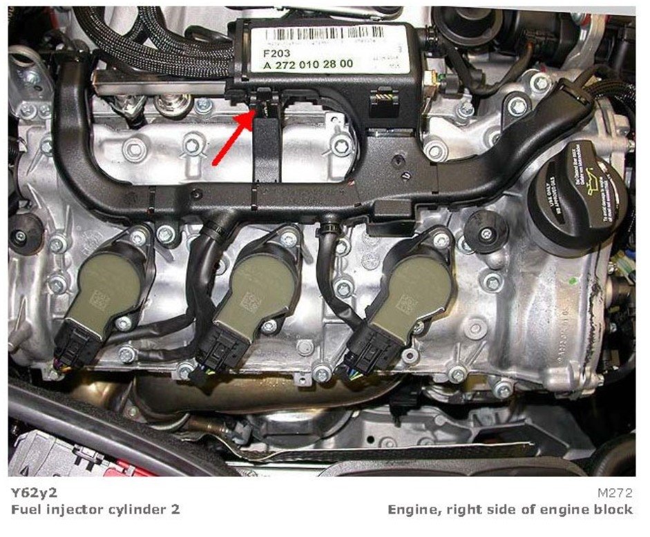

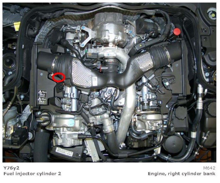

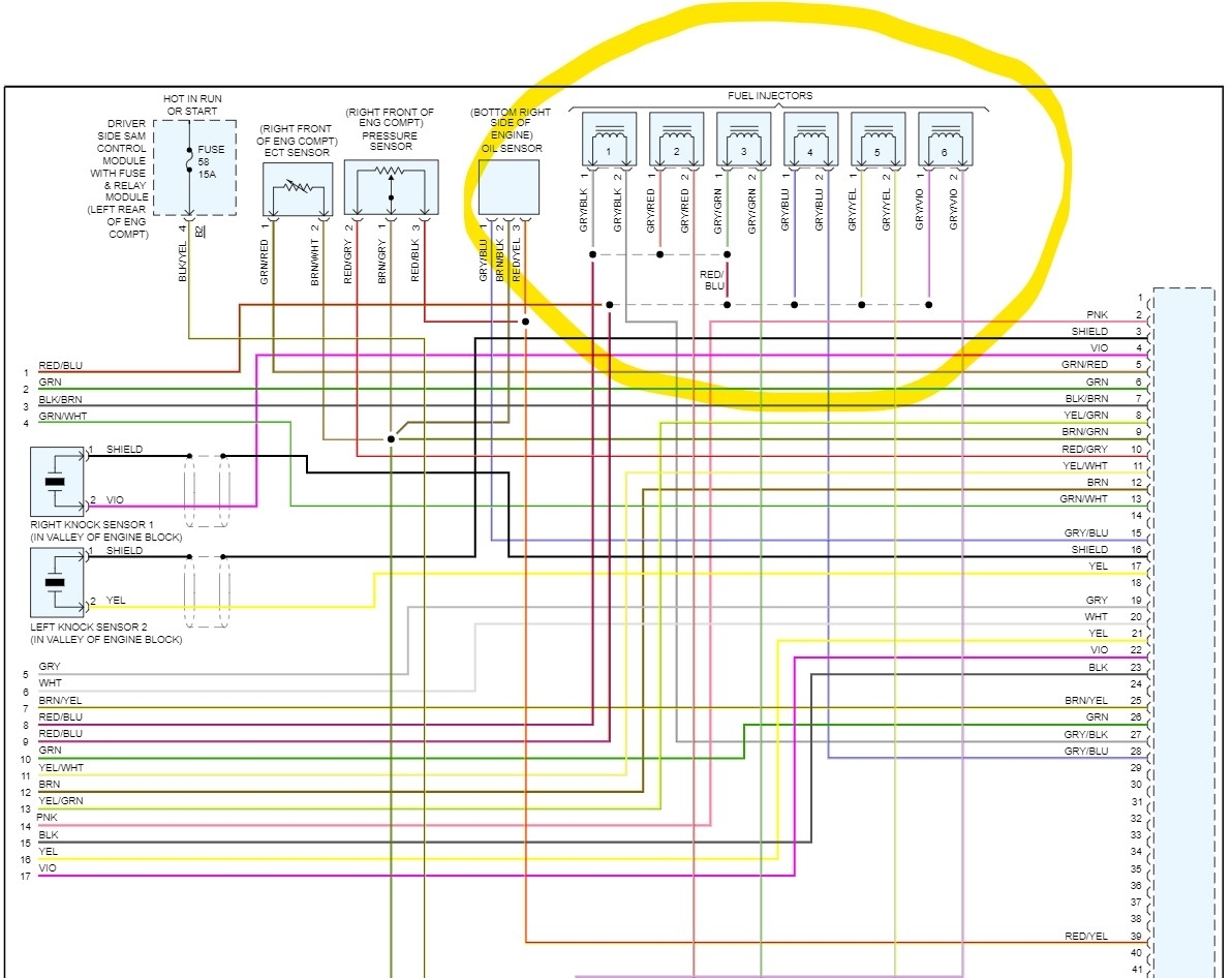

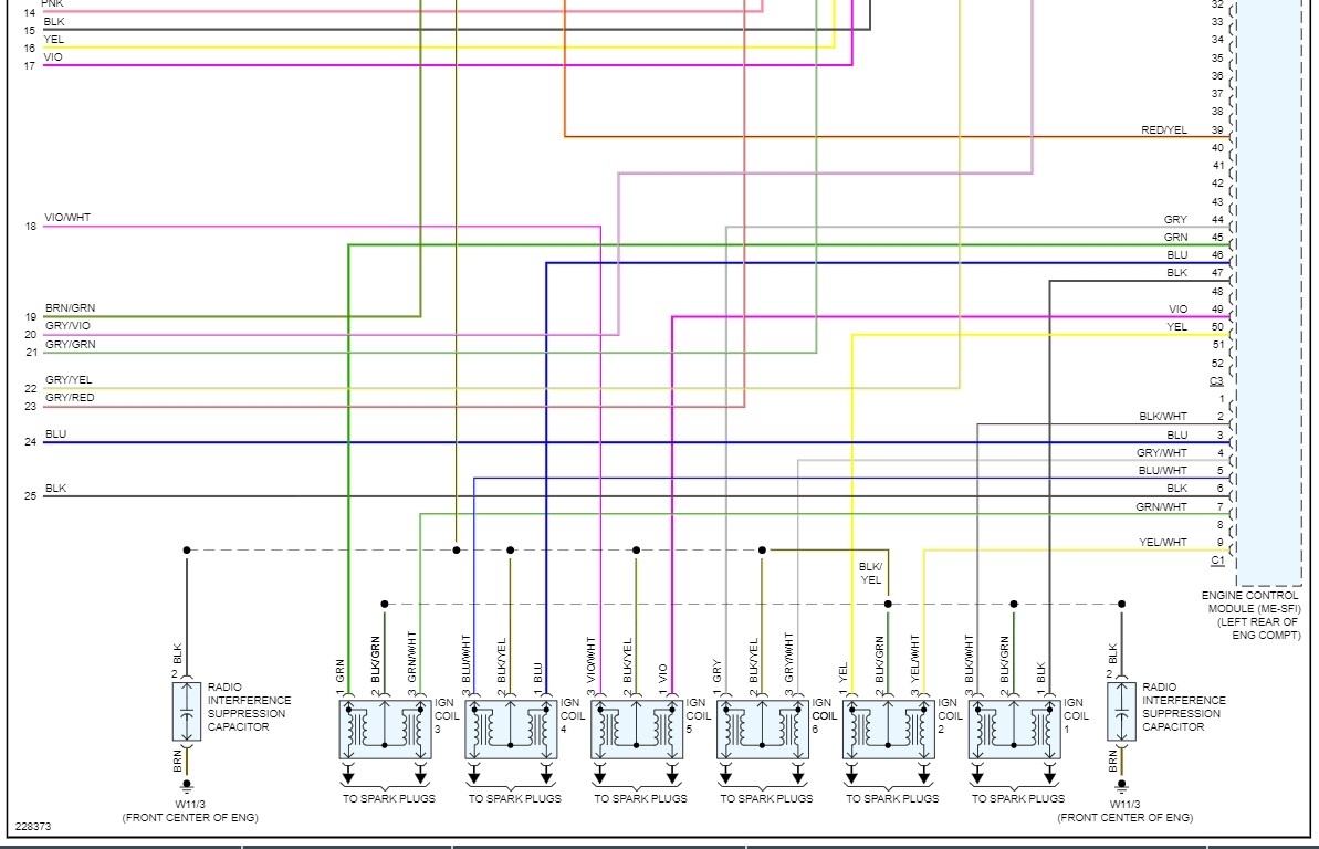

Your curiosity was an educational concern. Injector 2 did not pass the continuity test. The other injectors averaged 15. I installed another injector that averaged 16. You were "right-on"!

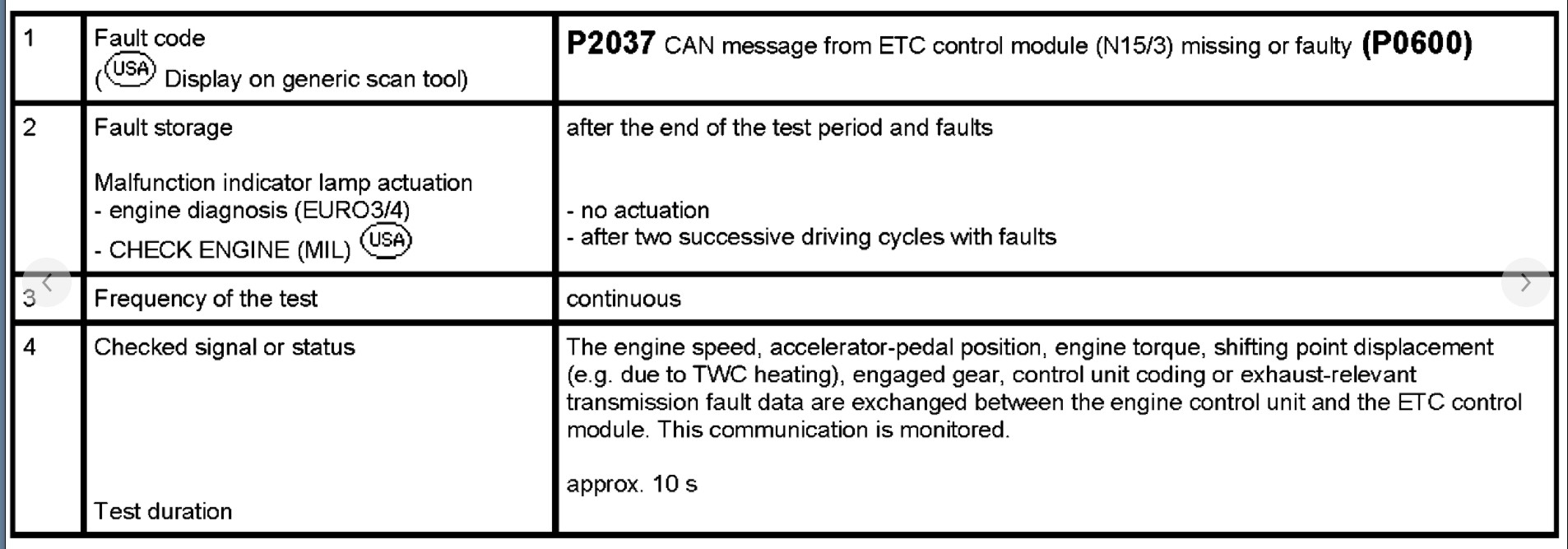

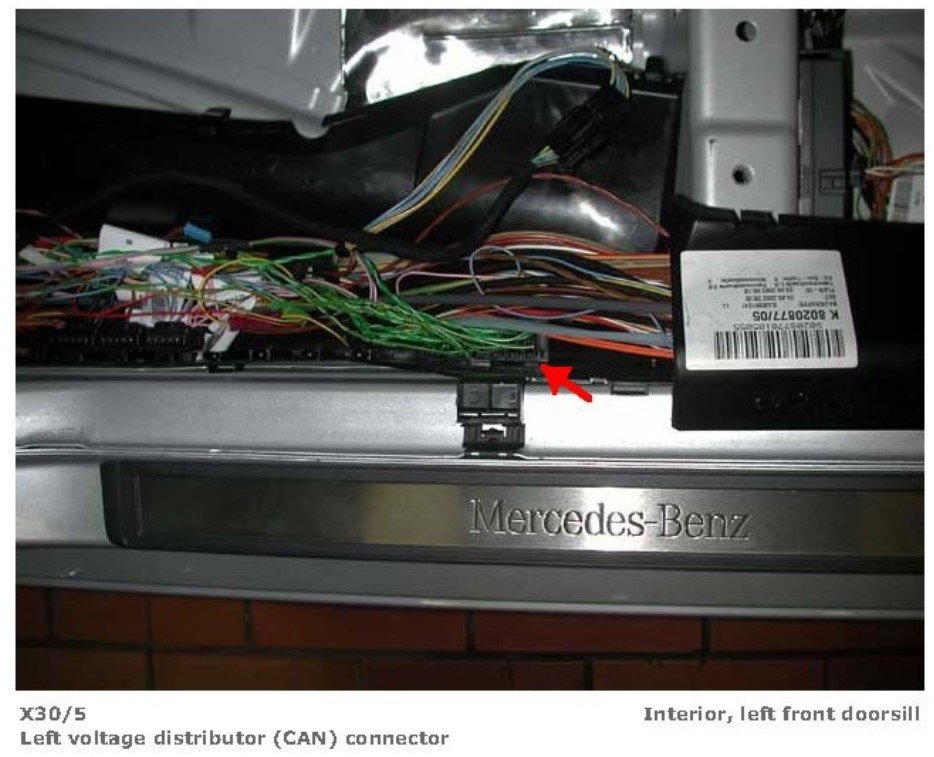

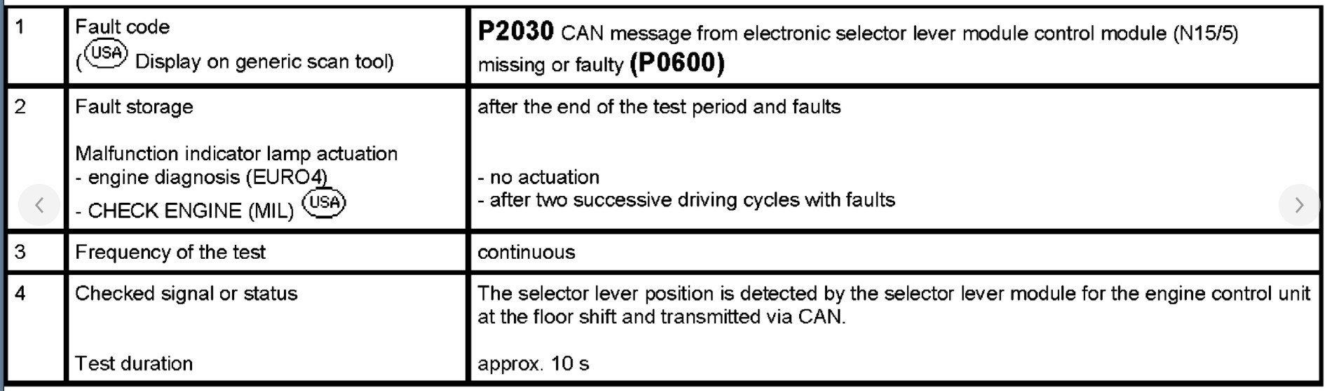

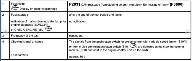

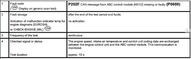

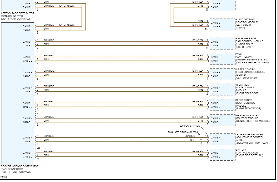

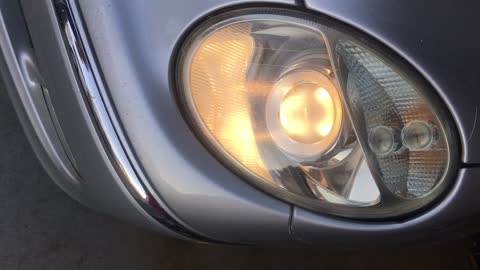

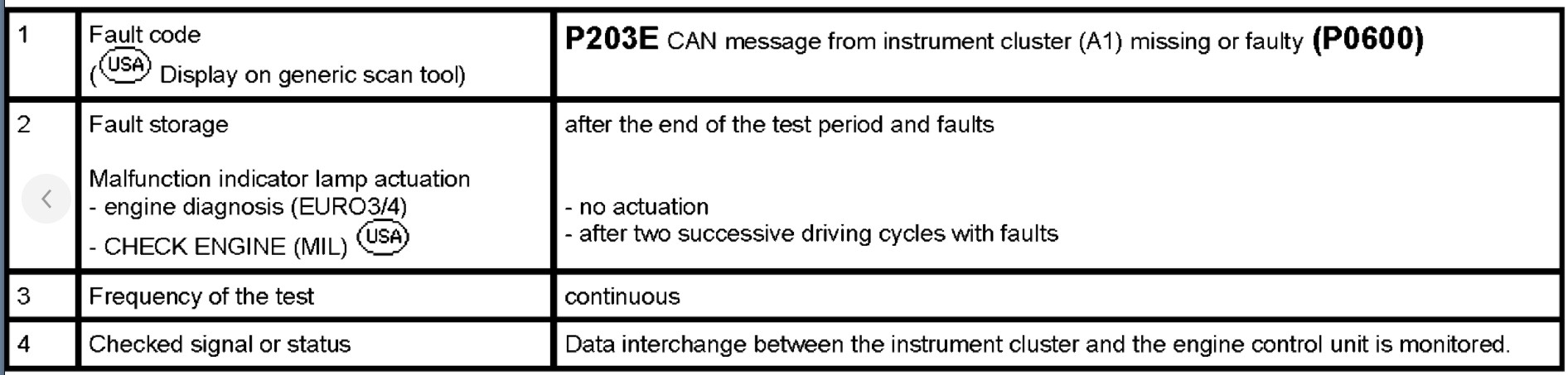

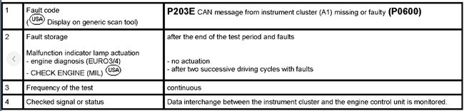

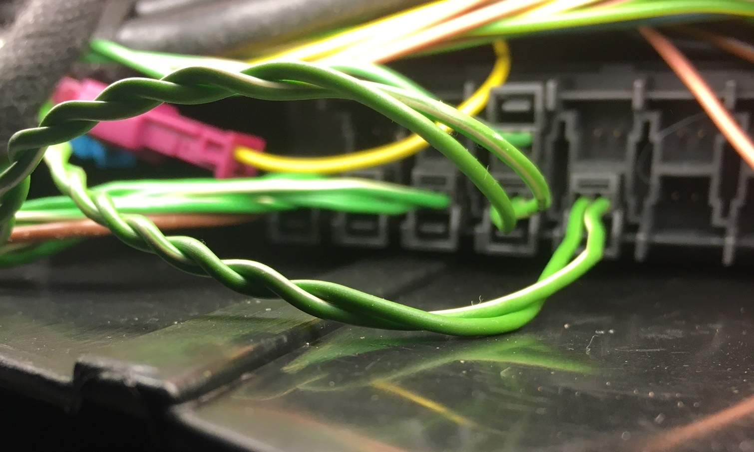

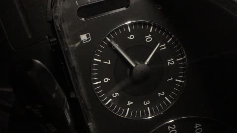

Last summer I was getting a 0600 code and the clock would start turning in one direction and then the other but would stop after about five minutes. Then weeks later the clock would turn, and the headlights would go on and off and the turn signals would not work. until about 5 minutes and all would normalize.
I chose to be proactive and decided to change the spark plugs and the injectors.

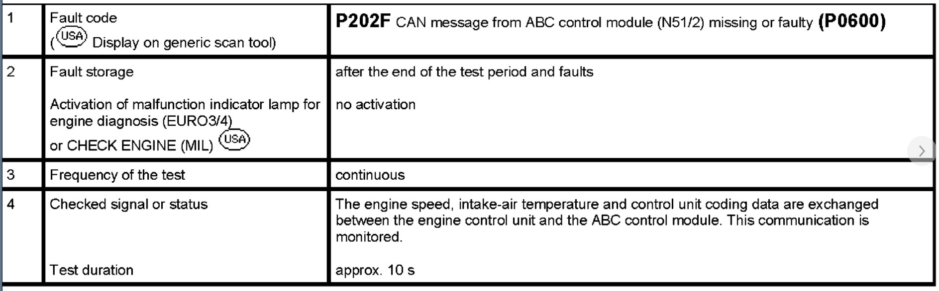

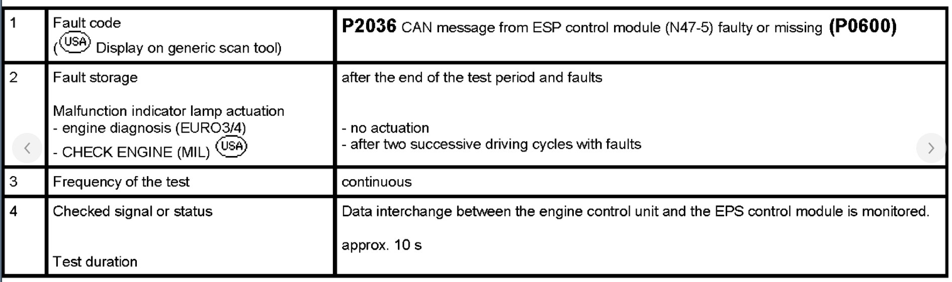

All worked well for about a week, then I started getting error 0202 along with the 0600. I communicated with an online mechanic. (I'll reveal that later if necessary)

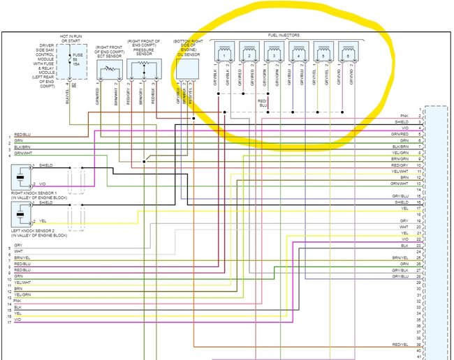

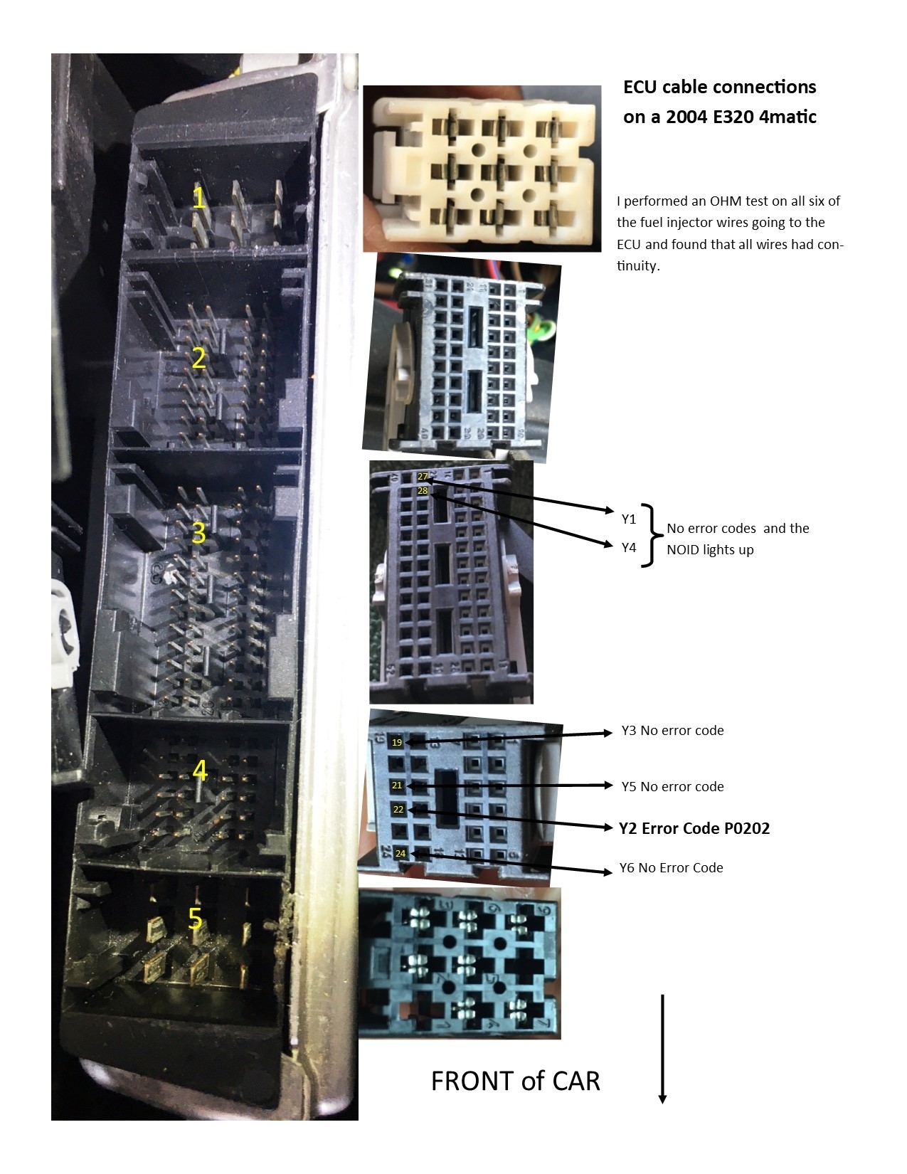

He said check the continuity of #2 injector with the plug on the ECU. It checks out good. He said that it was the ECU. I sent the ECU for repair, and they said that it did not exhibit any problems and sent it back.

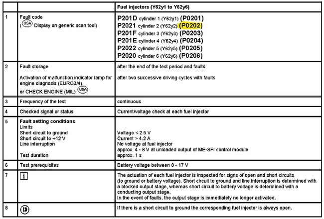

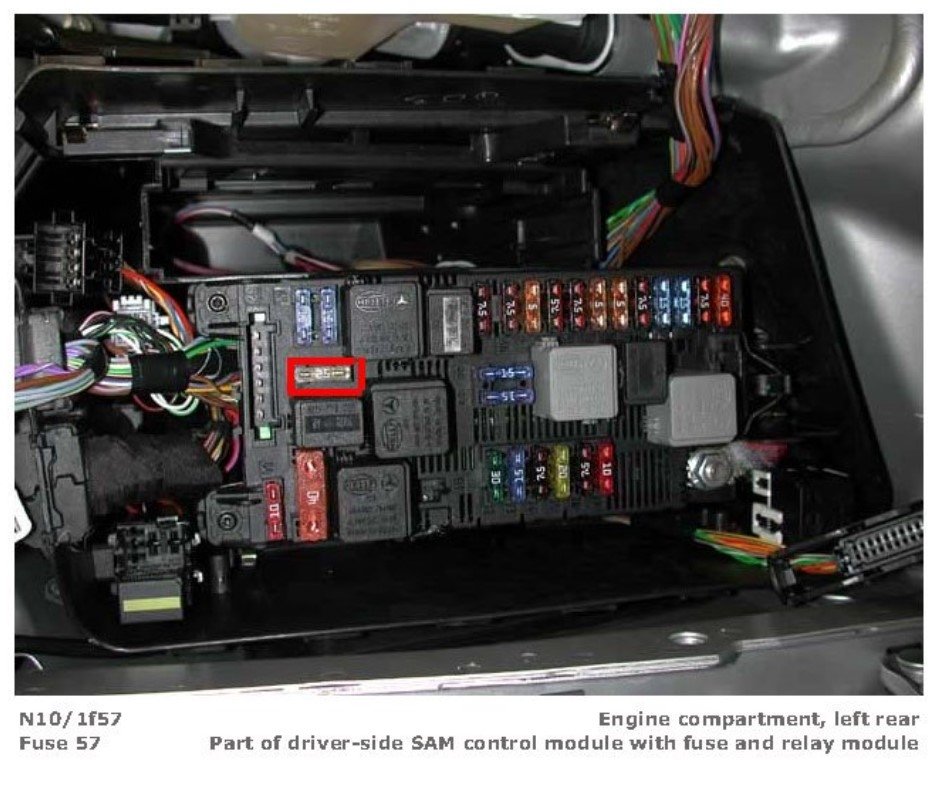

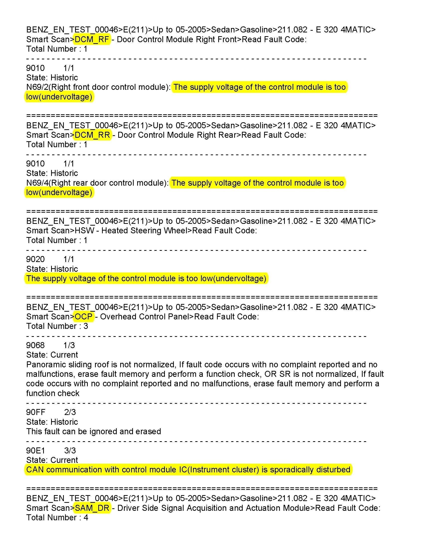

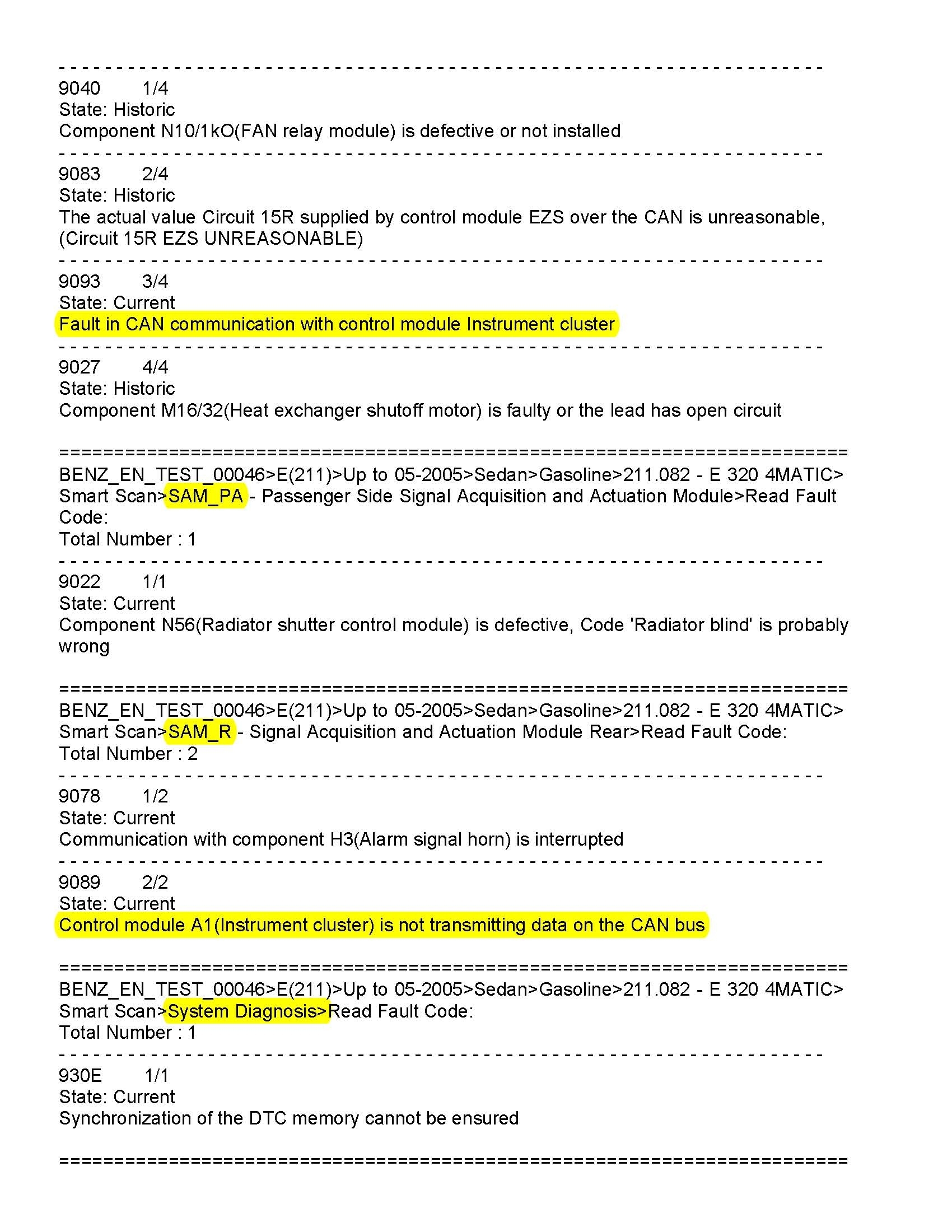

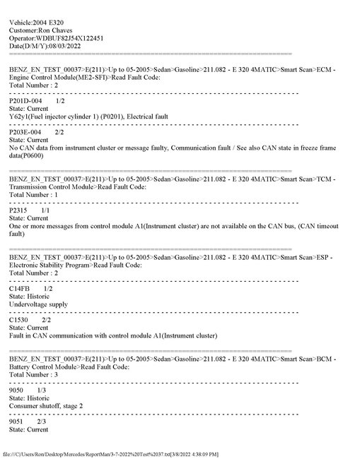

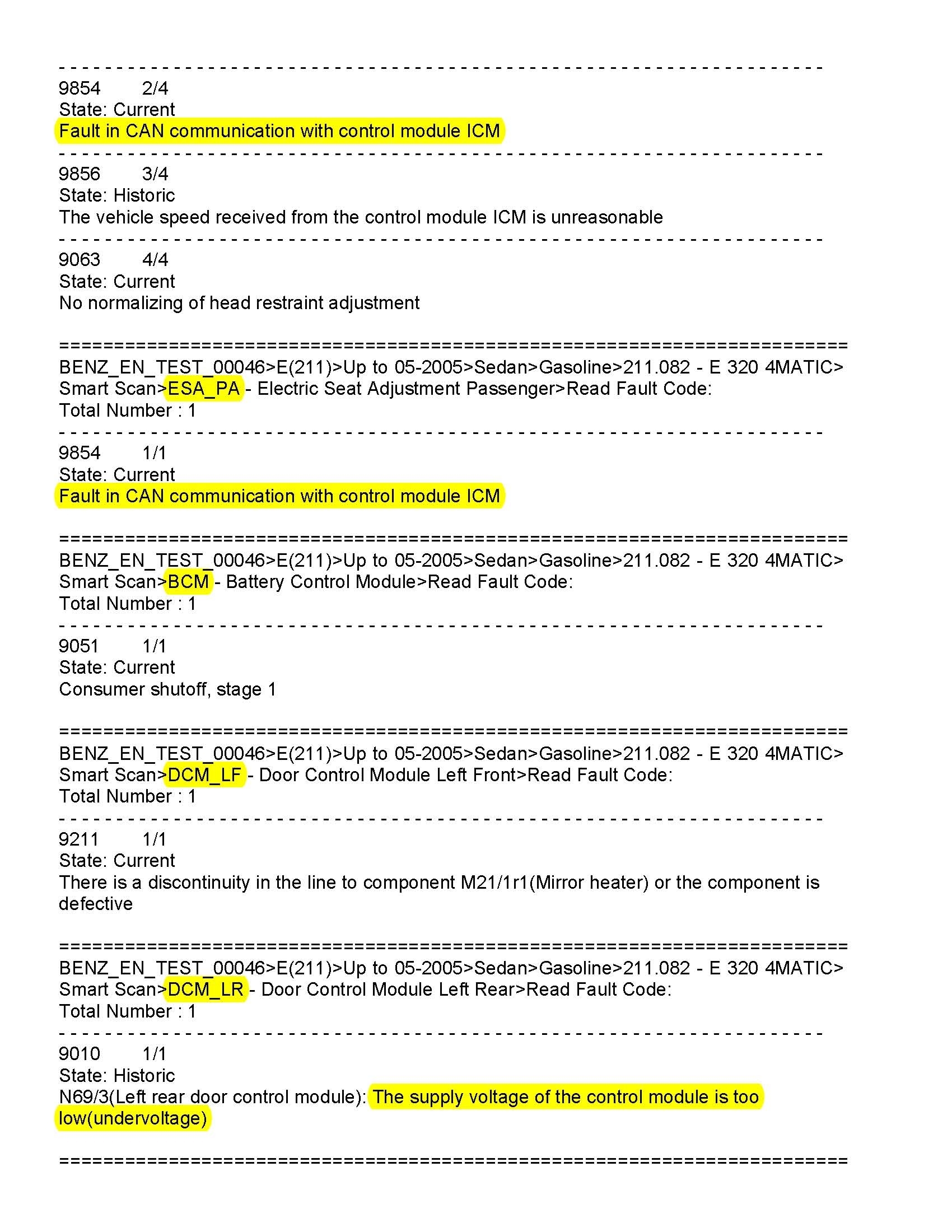

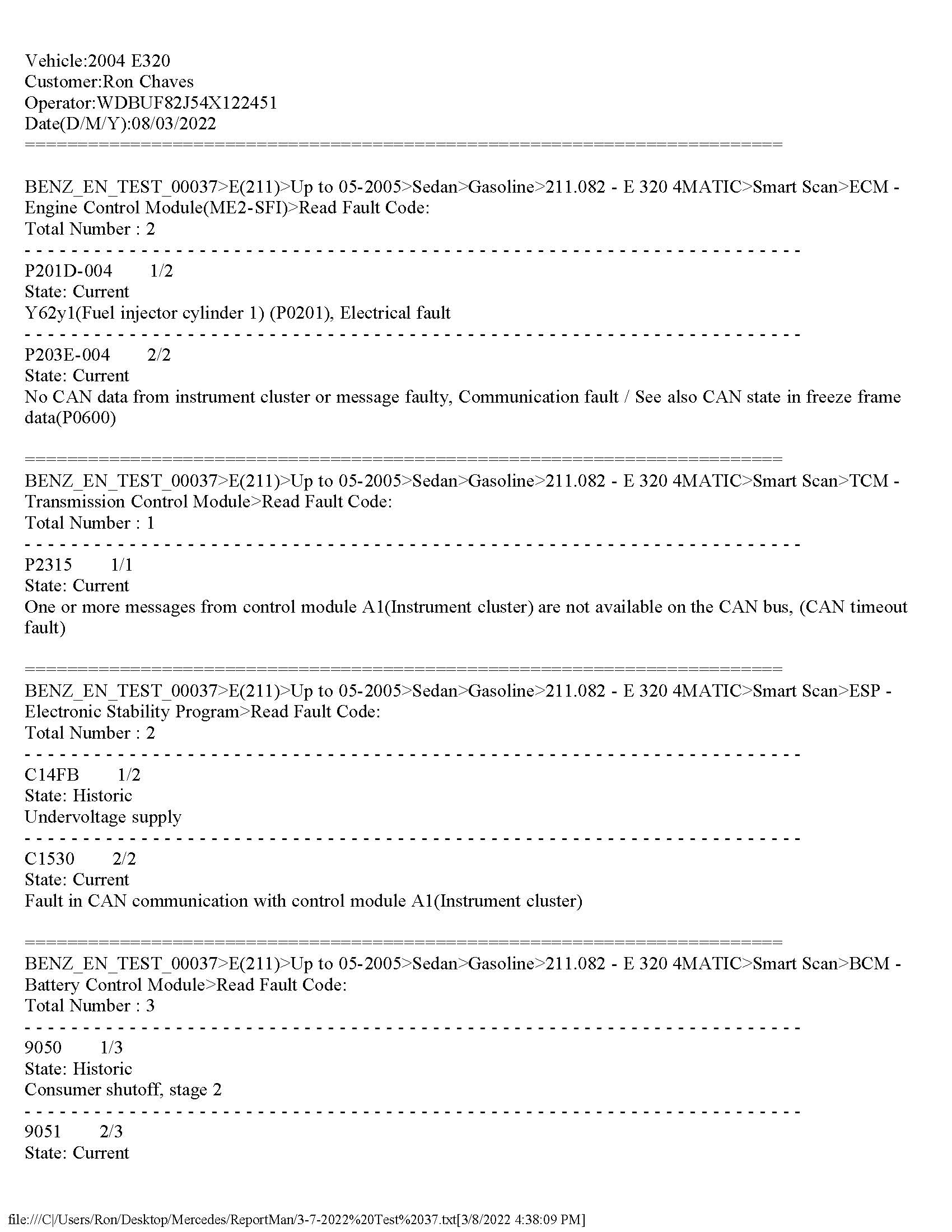

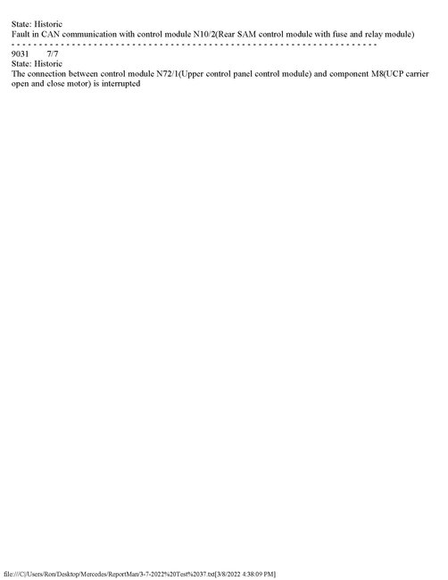

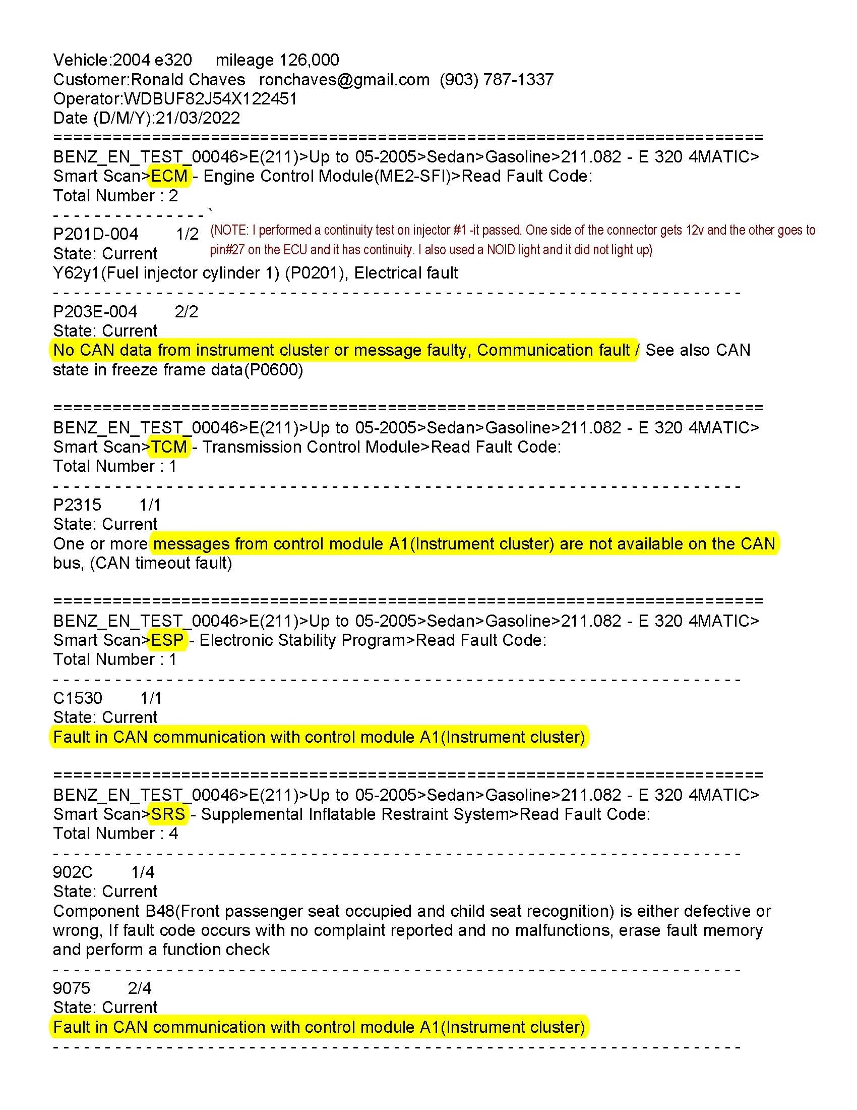

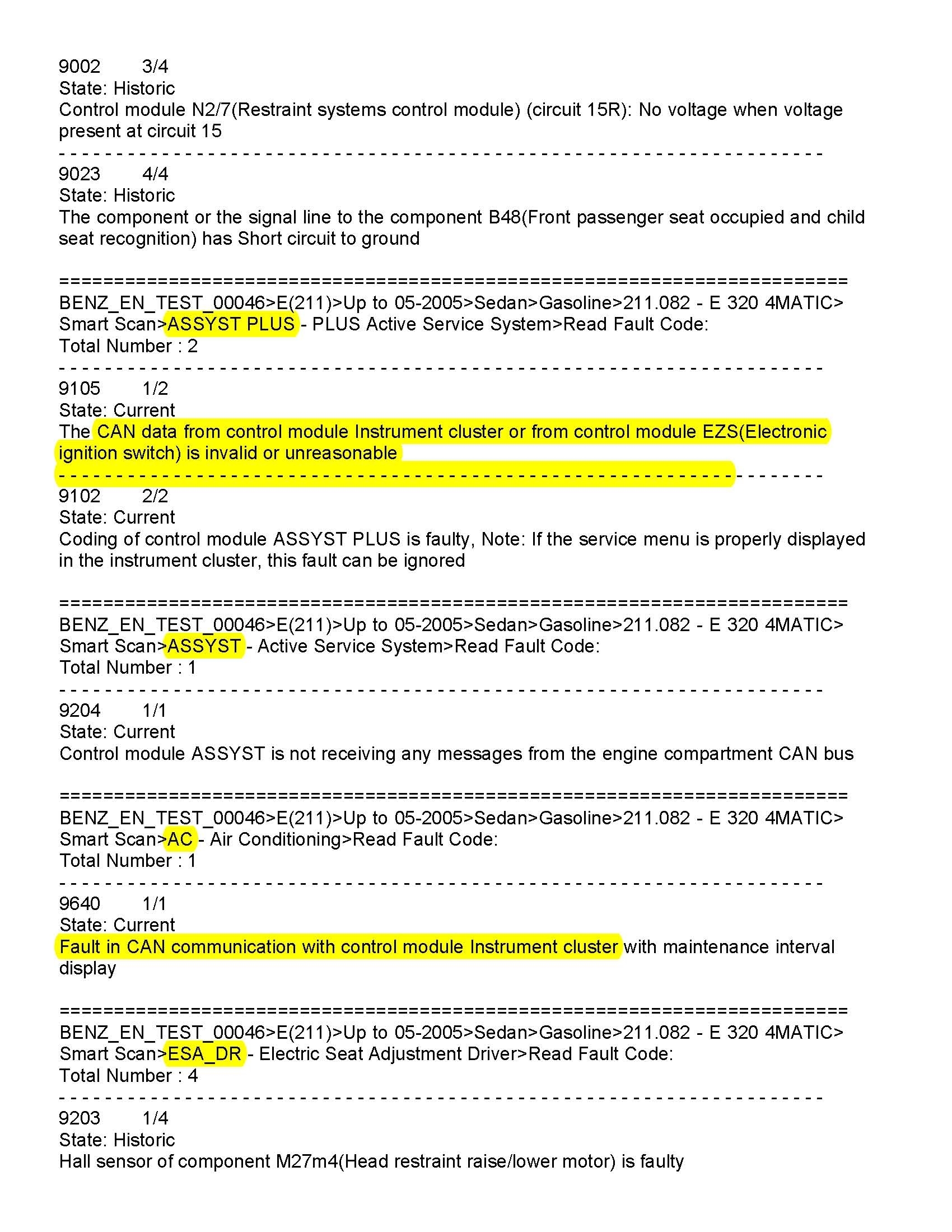

I have an ICarsoft II for Mercedes. The 0202 error code is gone but a 0201 remains. It passed the continuity test and the injector had 15. I connected a NOID light that did not light up. I inspected all of the fuses under the hood.

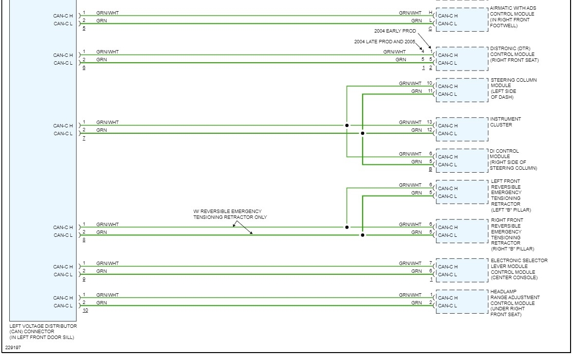

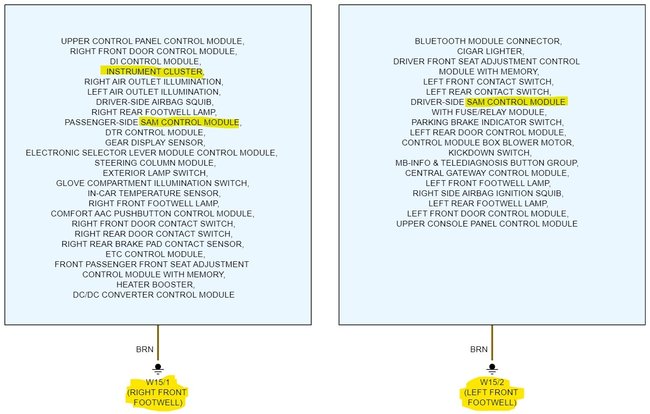

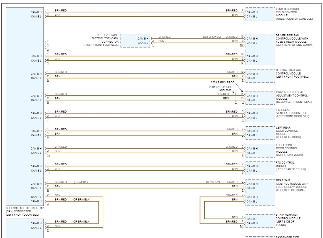

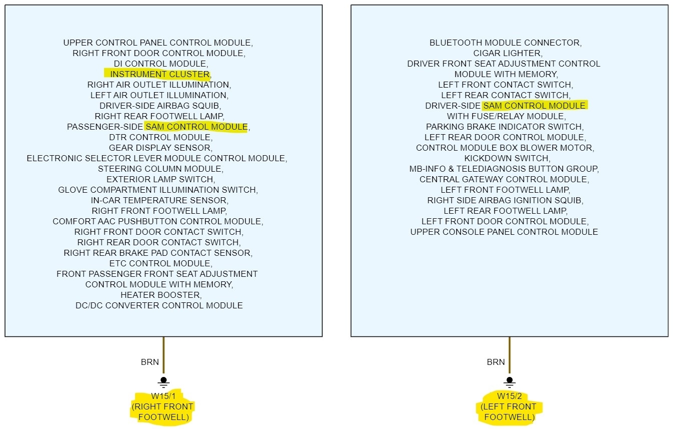

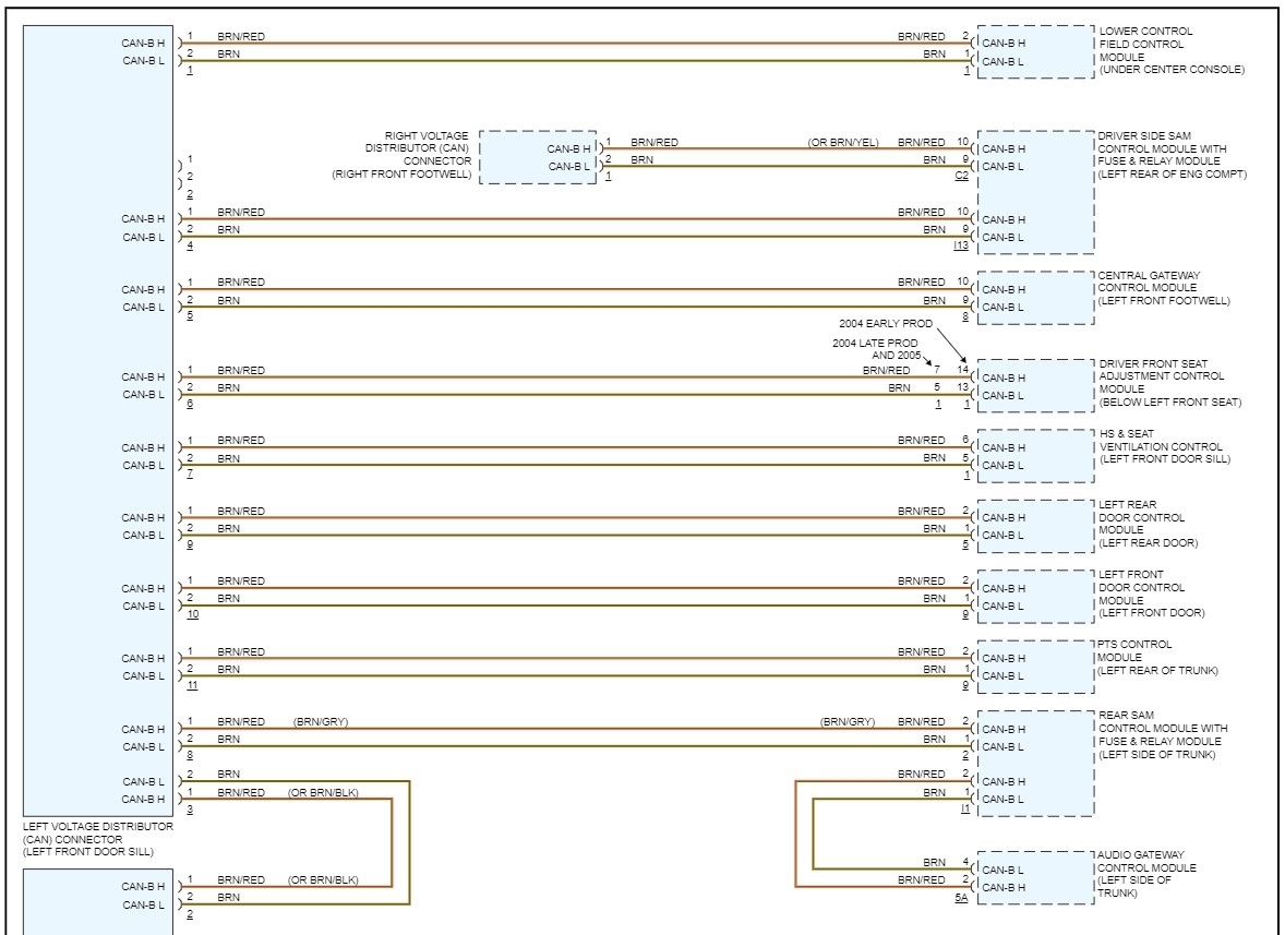

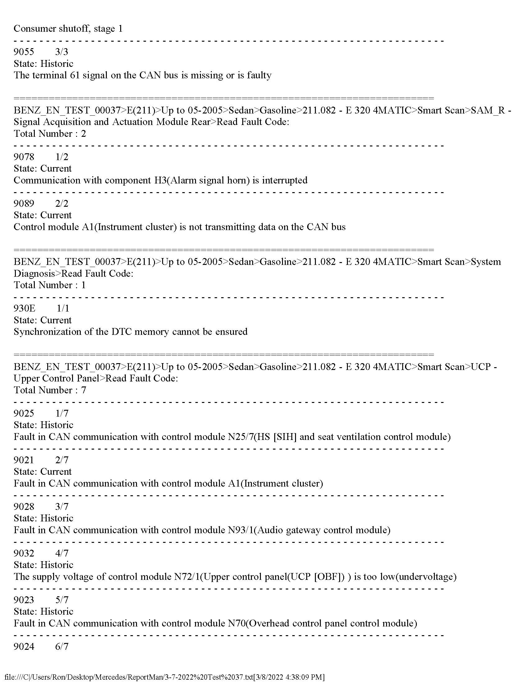

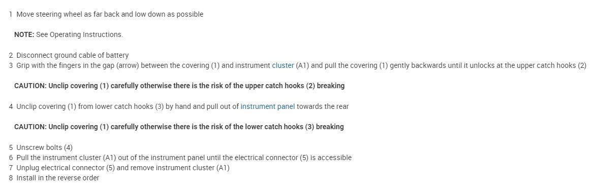

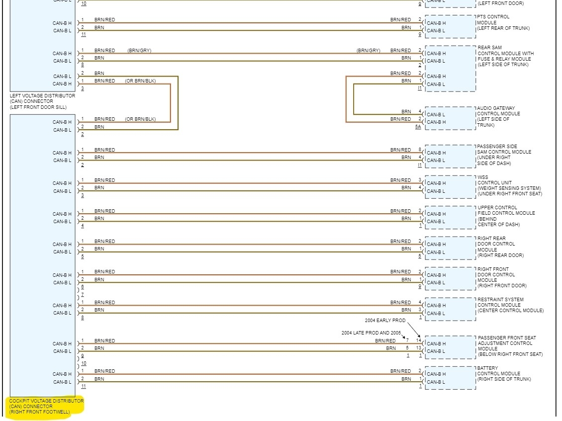

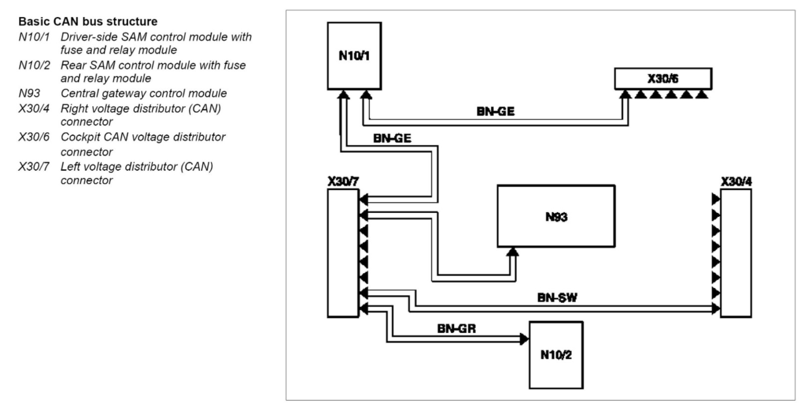

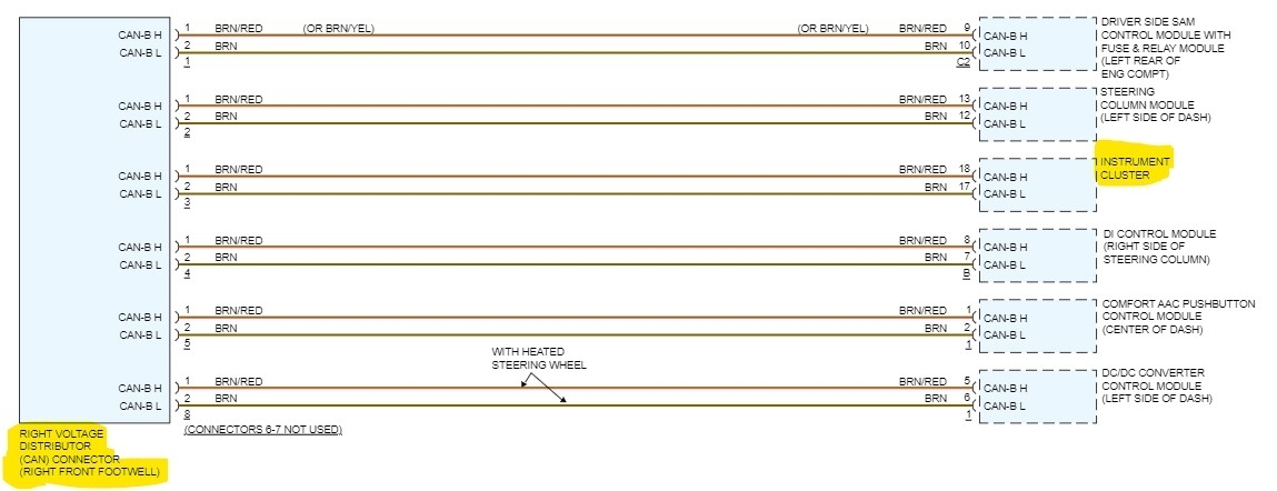

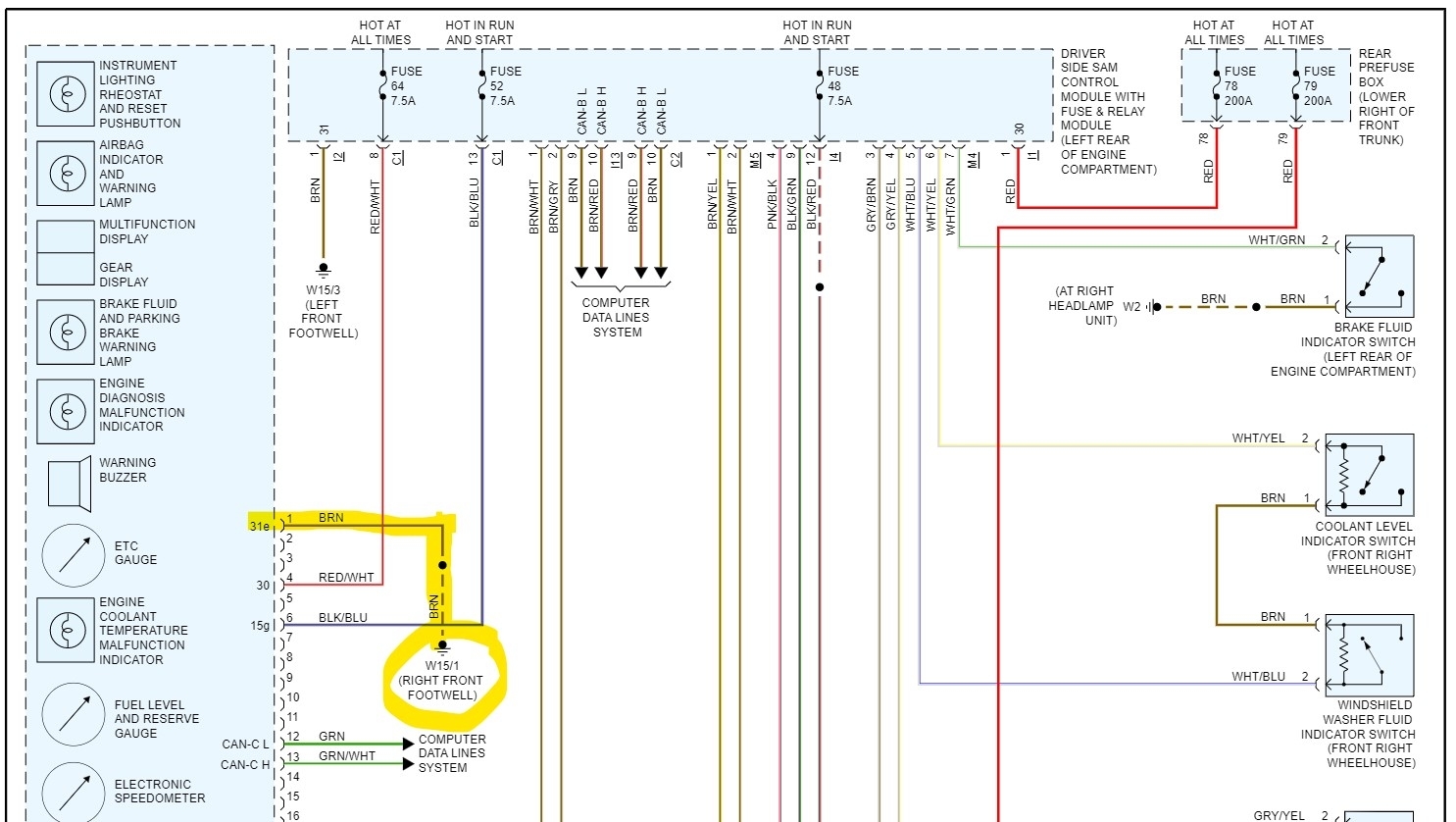

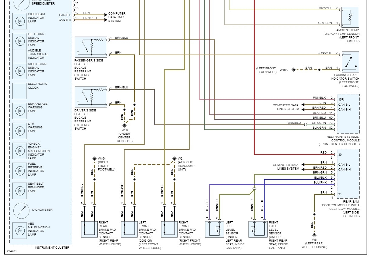

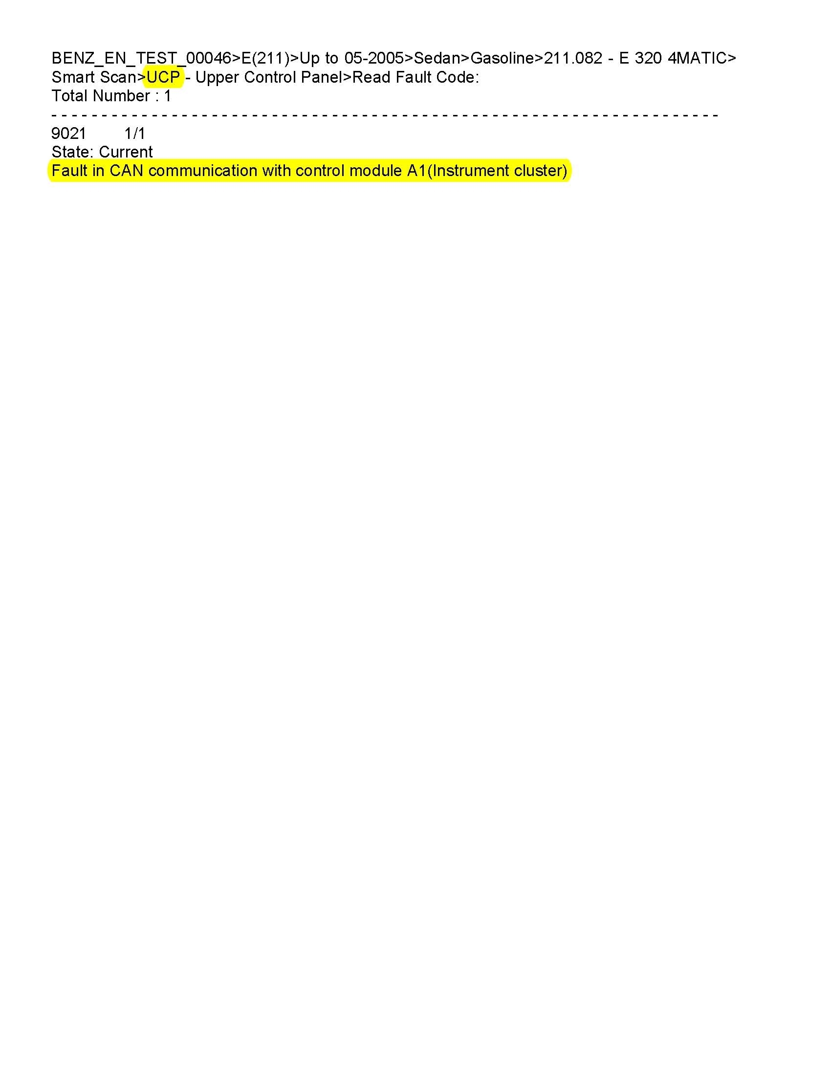

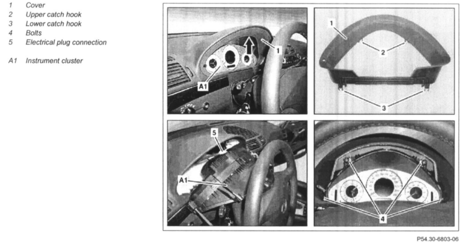

The different errors oftentimes mention "instrument cluster". I can get a used instrument cluster.
Is there a common link with the instrument panel and the error code for #1?

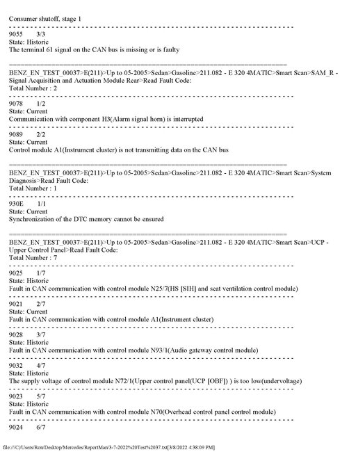

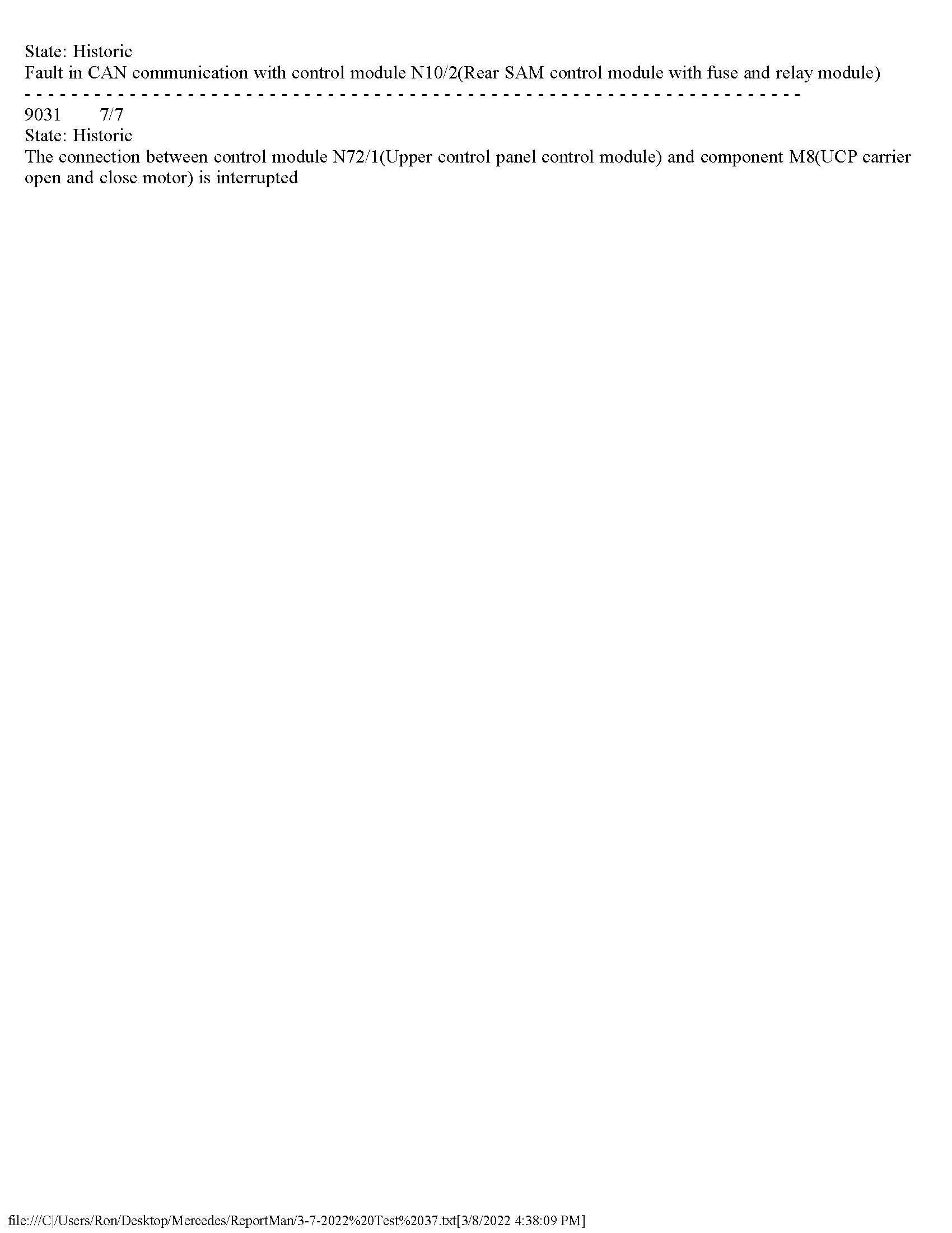

I can send a .pdf of the last test. How should I send it?
I'm not a mechanic but have had multiple cars I've worked on. Mostly Mercedes both gas, diesel and diesel truck.
Electronics are not my forte. I wish I still had my TR3 that was stolen. No computerization and I could hand-crank it if the battery was dead.
Thanks for any suggestions you may have.
