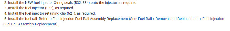

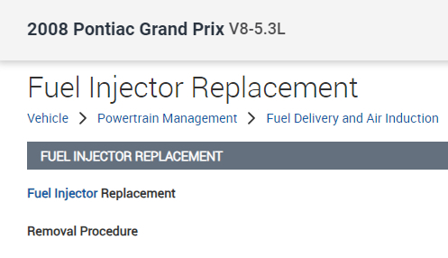

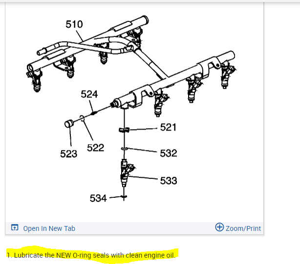

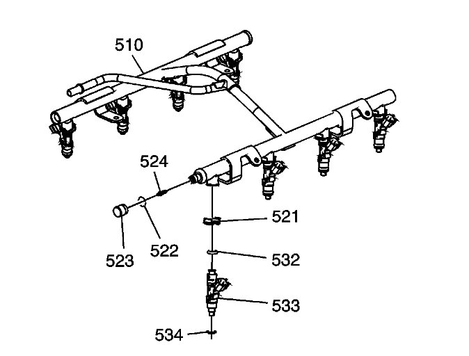

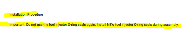

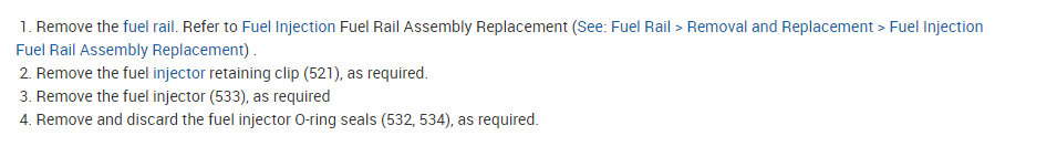

I attached the directions for replacing the injectors. When you do this, make sure to replace the o-rings and lubricate them before installing them. The manual says motor oil can be used. I usually use Vaseline.
See pics below.

So, when I do this job do I have to cut off any relays or etc, since I'm dealing with injector just asking before I install them look simple not hard at all just want to triple check before I do so.
Feb 12, 2024 at 6:14 PM
BORIS K
  • 836 POSTS

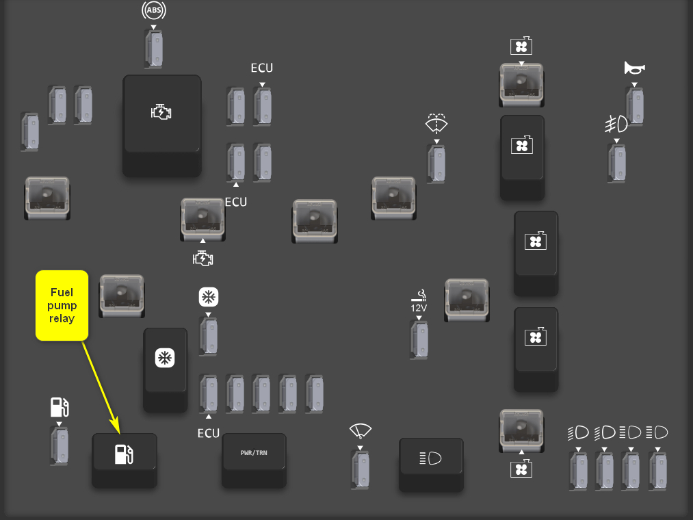

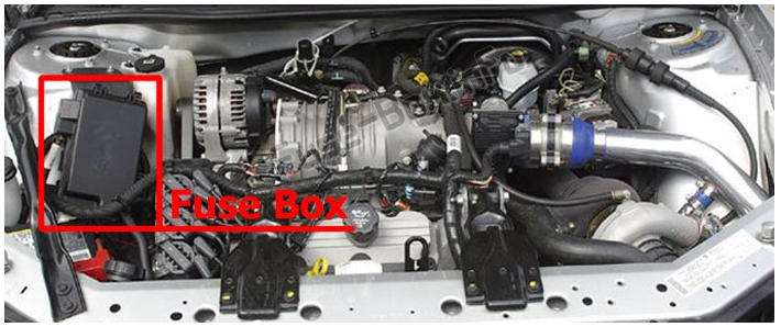

Prior to disconnecting any fuel pipes, I would suggest removing the fuel pump fuse or relay. Next start the engine up, it should fire and run for a few seconds on the residual fuel pressure. The fuel pump relay is located in the engine fuse block, ahead of the right-side strut tower.
Once the engine stalls the remaining fuel pressure will be very low.
You can then commence to remove the injectors.
A good video:
https://youtu.be/lP7-PVVpM-Q?si=azObhJLLAOz4j9FN
Cheers, Boris
