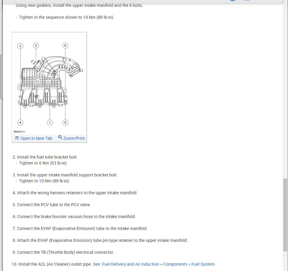

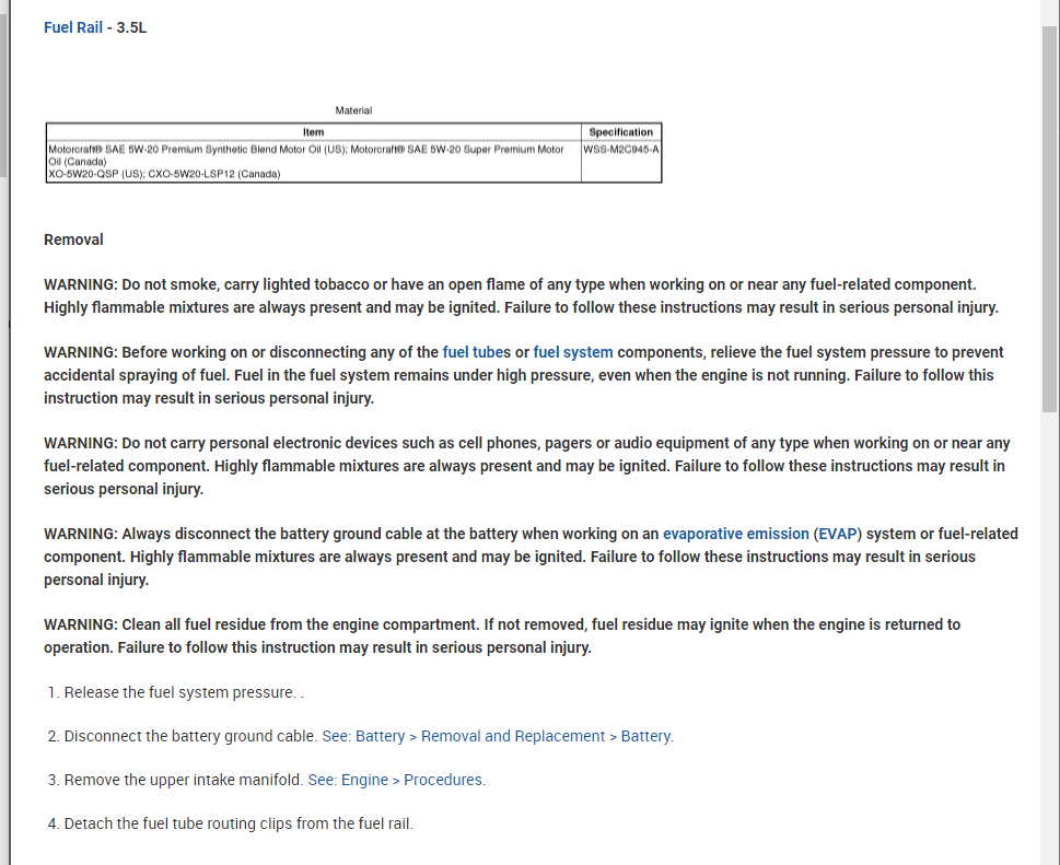

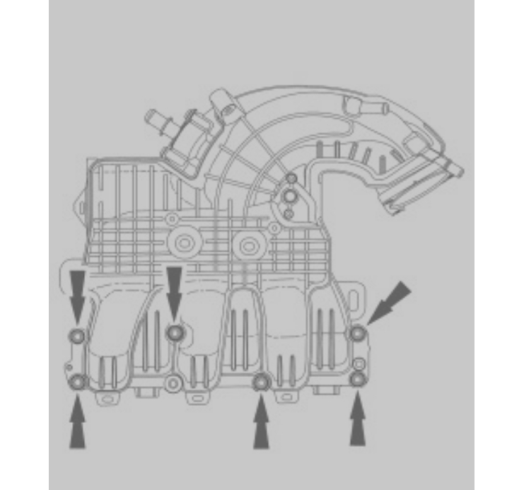

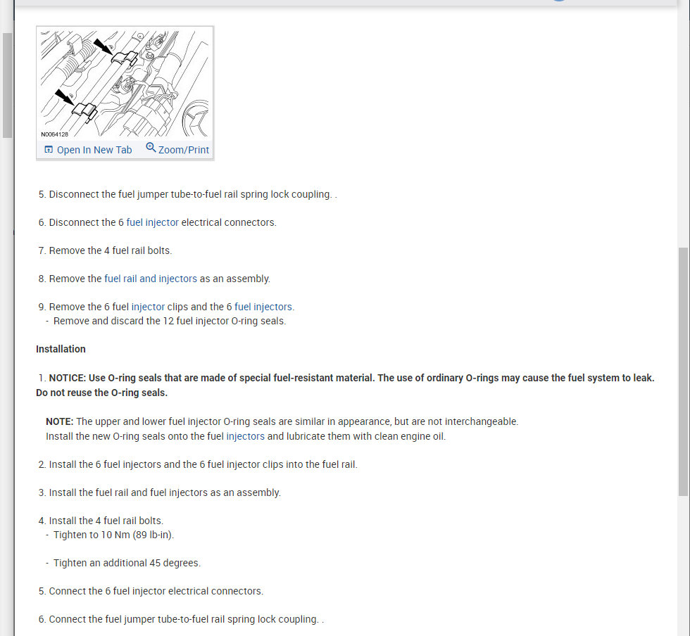

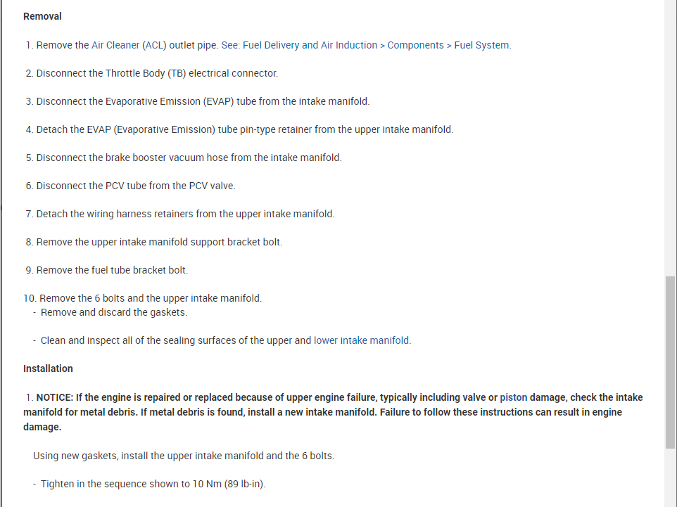

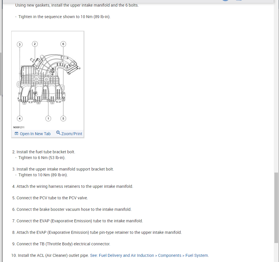

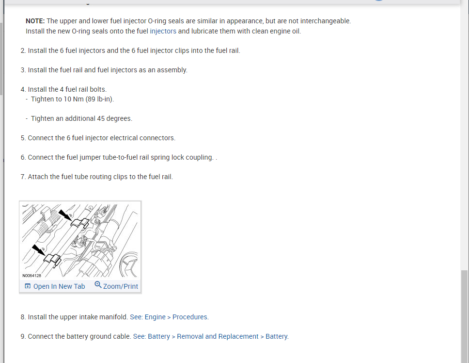

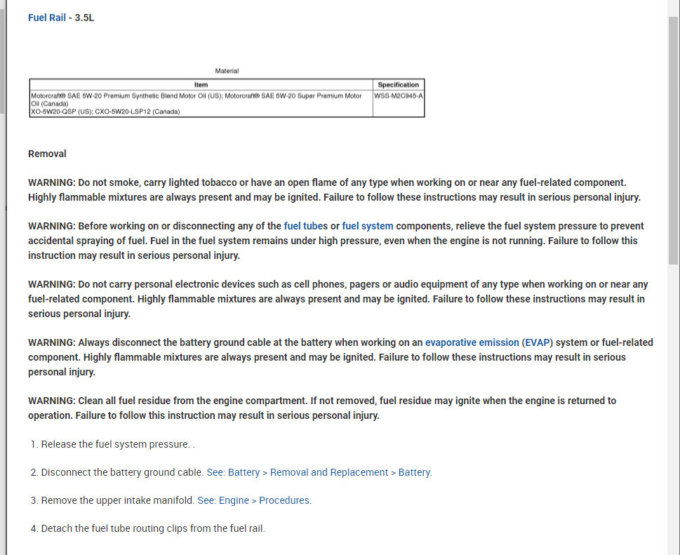

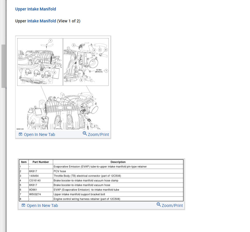

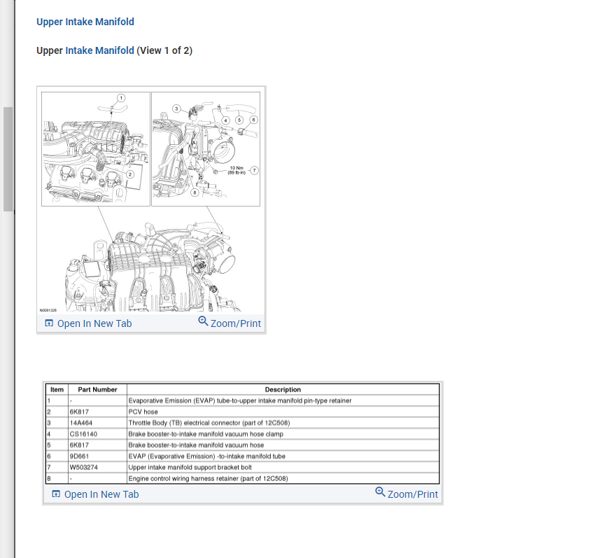

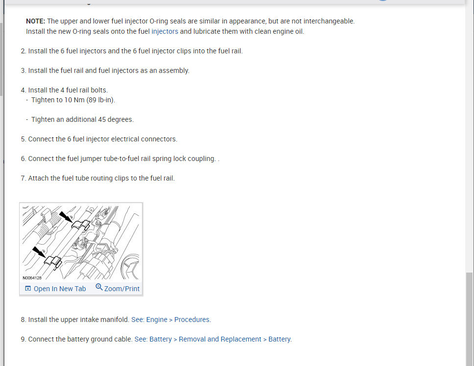

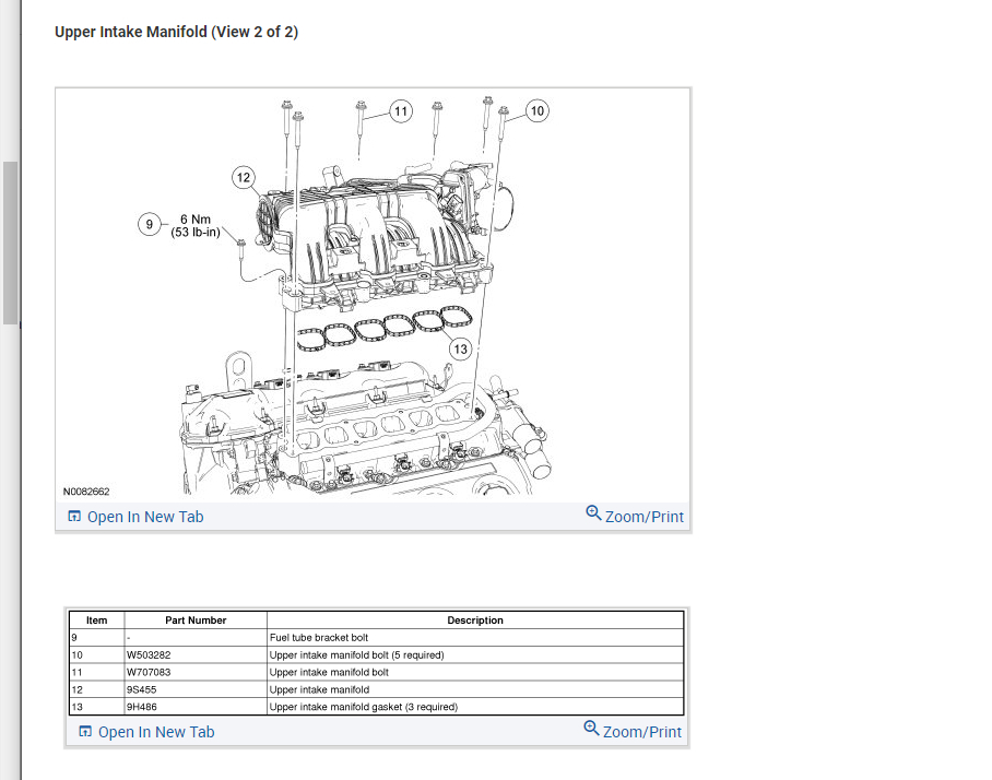

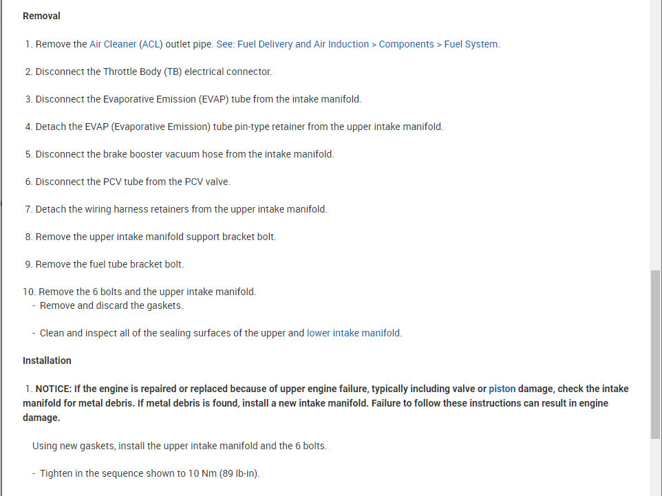

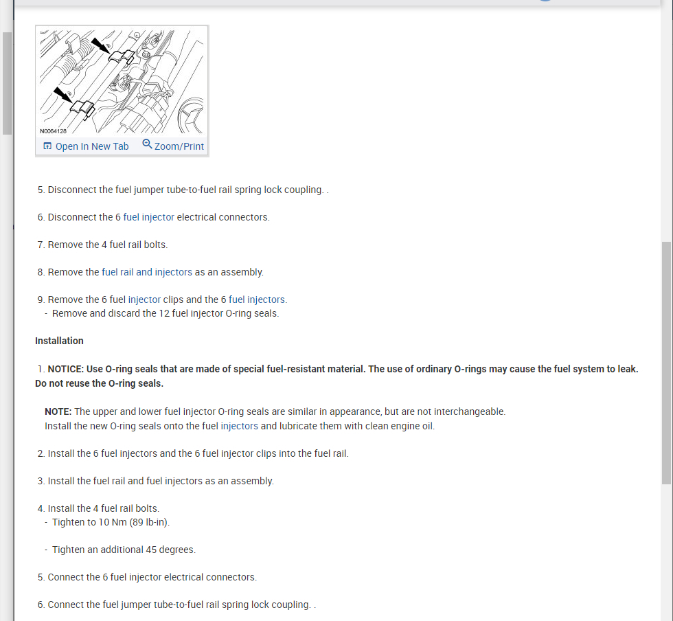

These injectors are under the upper intake manifold. I will attached the complete process for this but here is a guide that will help with replacing injectors:
https://www.2carpros.com/articles/how-to-replace-a-fuel-injector
Below is the process from the manual on how to remove the fuel rail/injectors and upper intake manifold.
Please run through this material and let us know if you have questions. Thanks
