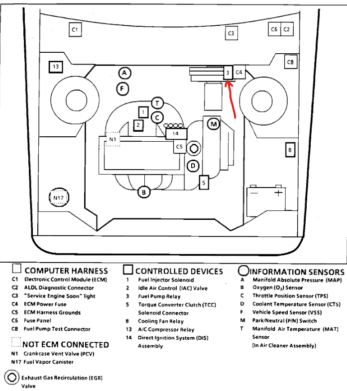

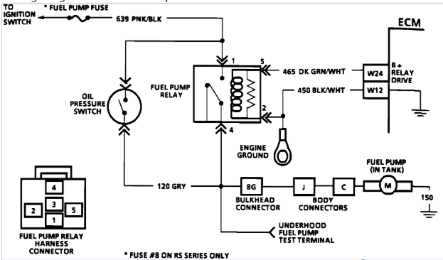

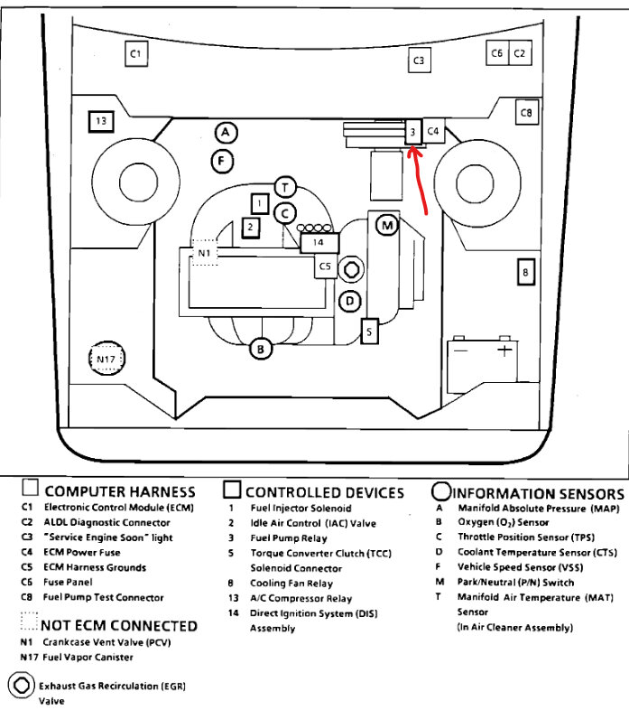

I was asking where the fuse was for fuel pump and fuel injector fuse?
Aug 13, 2025 at 12:55 PM
CERTIFIED EXPERT
53,854 POSTS
My bad, here is the location of the fuel pump relay and the fuse is a little harder to find by if you have power to the #1 terminal of the relay the fuse is okay. Check out the images (below). Let us know how it goes
