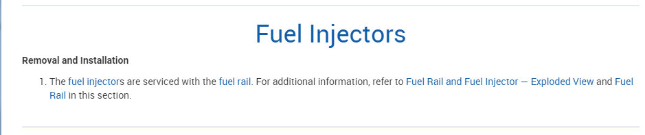

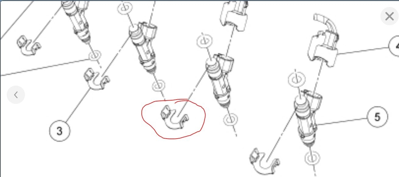

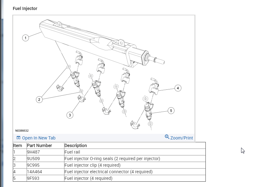

I assume you are talking about number 2 and 3 in the first attachment? I doubt you will find the injector seals as they normally come installed on the new injectors. You may want to try a dealer to see if they have any in bulk or just try a local parts store and see if they can order any generic seals.
As for the clips, if you google the part number 9C995, it pulls up many options for you to get these.

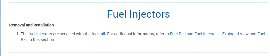

The reason you are having this issue is the rail is serviced by Ford as an assembly which comes with the injectors and all these parts already on it. Take a look at the second attachment.
Let me know if you have questions. Thanks

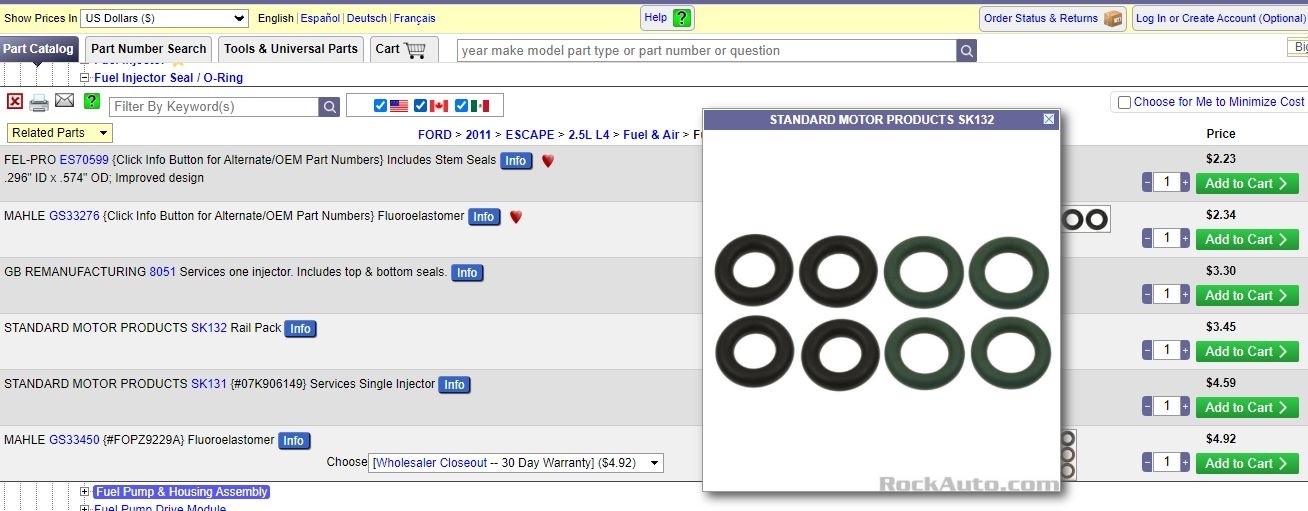

Good afternoon,
I found the o-rings for you and attached them below.
The clips come with the injector. They are available but you need to go to the parts department at Ford dealer for those. I do not see anyone offering them separately in the aftermarket.
