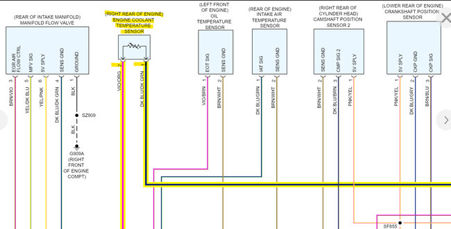

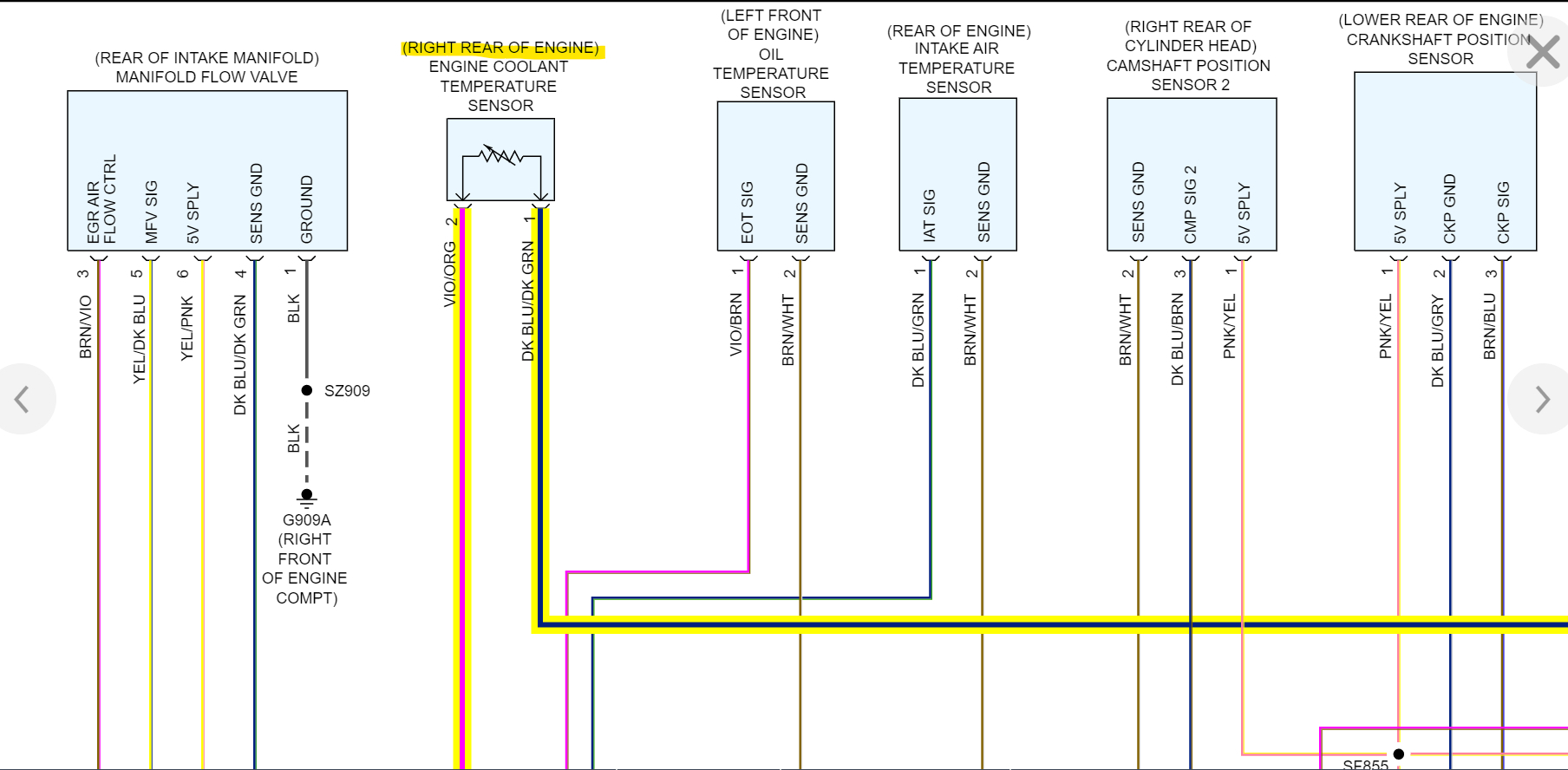

Hello, the ECT is the engine coolant temperature sensor, are you getting a code for the coolant temperature sensor along with a Catalytic Converter code? If there is a fault in the coolant temperature sensor or its circuit and it is sending the wrong engine temperature information to the engine computer, it can be enriching the air fuel mixture too much and that is what caused the Catalytic Converter to fail. Usually, cylinder misfires are what will cause a Converter to fail due to unburned fuel making its way into the Converter and the converter overheats and melts down. But a bad engine coolant temperature sensor will cause cylinder misfires as well because there is either too much or not enough fuel being sent into the cylinders.

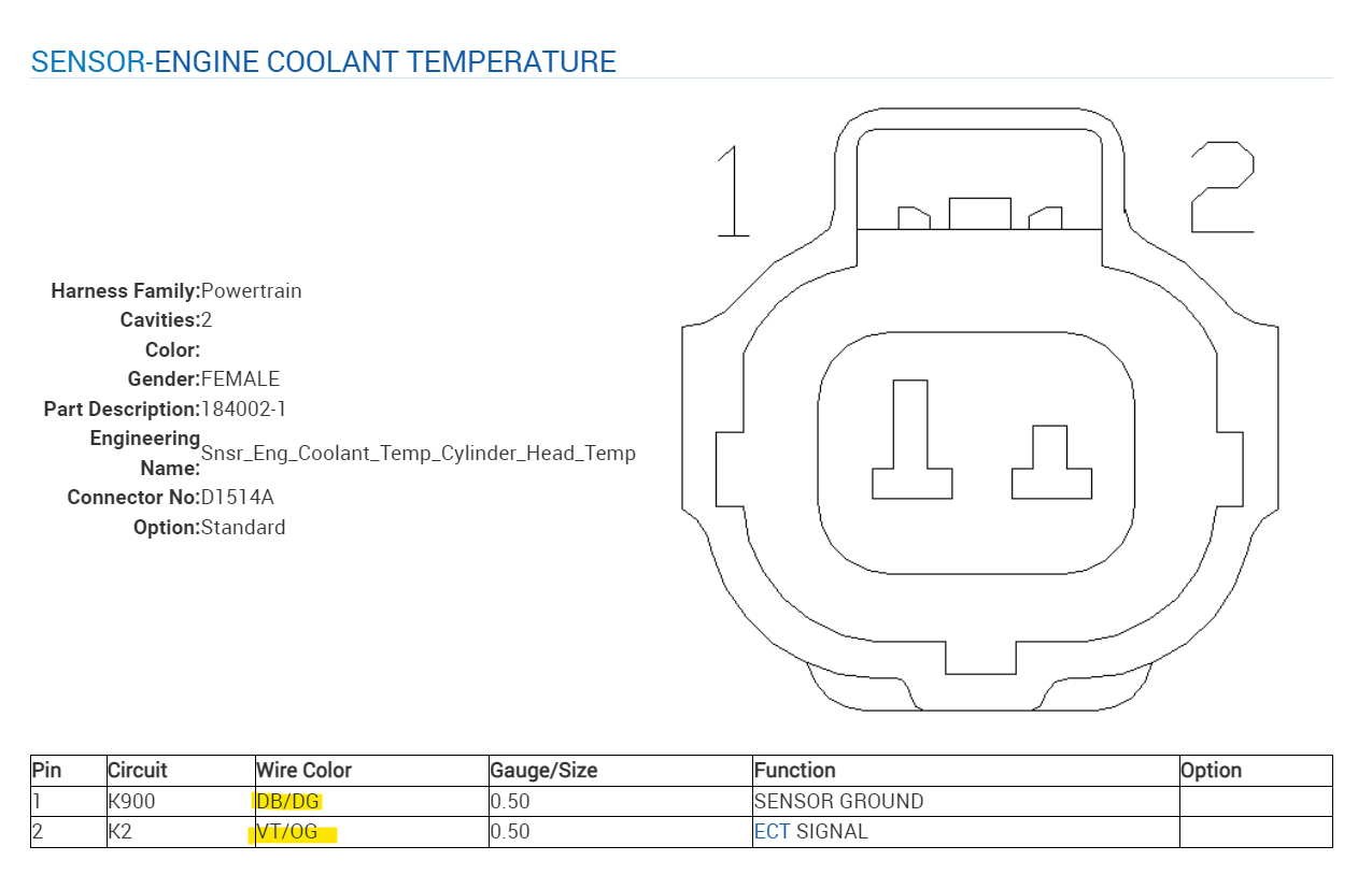

The third diagram is the connector for the engine coolant temperature sensor and the wire coloring. Which is dark blue with a dark green stripe and the other wire is violet with an orange stripe.

You have oil leaking externally on the Catalytic Converter? That would not cause the converter to fail. Converters fail because of fuel getting into it internally and causing it to overheat. A bad Engine coolant temperature sensor could cause the engine computer to enrich the air/fuel mixture when it is not needed, this can cause cylinder misfires that will cause the Converter to fail. If you have a code for the coolant temperature sensor, replace the sensor with a good OEM (manufacturer) sensor, not a cheap one. And you can also check the wiring to the sensor, we can walk you through that. It's not difficult. But external oil leaks won't cause a P0420 or P0430. Cleaning the converter is not going to help if it has started to melt down, or it is not able to store oxygen anymore.
How did you trace an issue to the coolant temperature sensor?
With the coolant temperature sensor unplugged and key On, engine off you should read 5volts on the dark blue/dark green wire, the other wire (violet/orange) goes to the engine computer.
